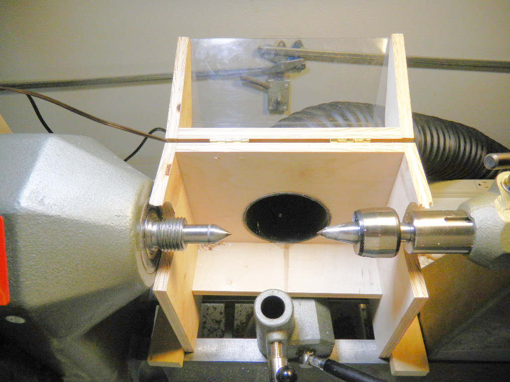

When I make pens, I have on safety glasses and I have a shop made lexan cover and dust collection. The cover keeps anything that flies apart contained.
View in Gallery
I picked up this idea from Mesquiteman.
Anything larger and the face shield goes on. I have a dust collector hose that attaches to the ways when turning larger items.
