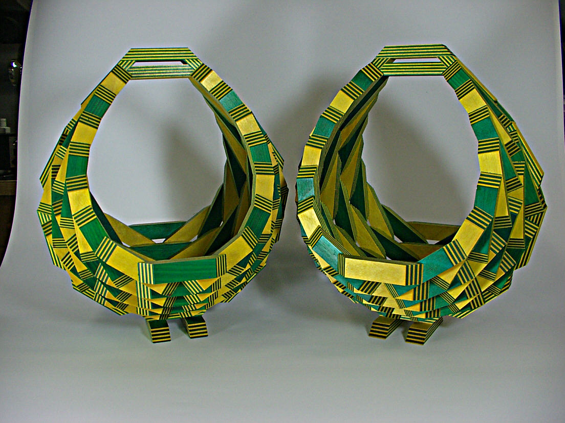

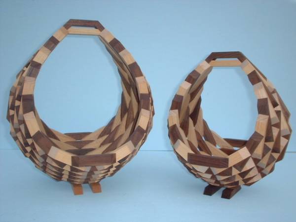

I have used different products for different applications but all are food safe. I use to make a fruit basket that also had a banana hanging post on it and for that I used Salad Bowl oil https://generalfinishes.com/wood-finishes-retail/oil-based-topcoats/oil-based-wood-bowl-finish
I have made a few cutting boards over the years and used this https://generalfinishes.com/wood-finishes-retail/maintenance-polishes-and-waxes/butcher-block-oil
And most recently I make alot of these fruit bowls and bread bowls or whatever you want to put in them and I use Danish oil. But what I tell most my customers that yes it is food safe because it has cured, I still recommend them put a towel or doily under the food.

View attachment 332184View attachment 332185
Wow - those are awesome!
