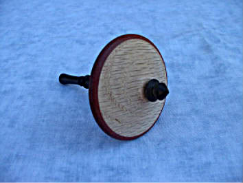

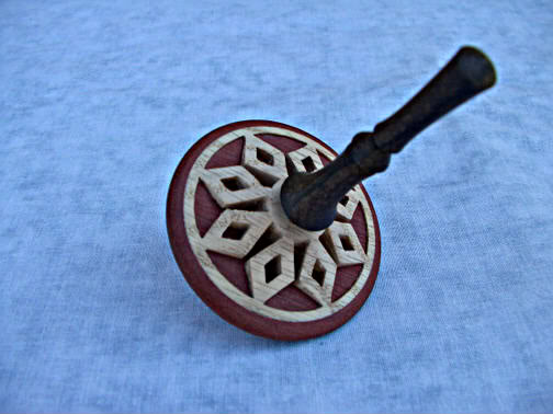

I can not help with the math and all that but can tell you I have seen tops of many different sizes and shapes. I can tell you balance is key. In other words the handle needs to be dead center and the weight of the top on all sides must be equal. The handle I found out can not be too tall but have no measurements. I just know when I made these I got cute with all kinds of shapes for handles and found them too tall so I gradually cut down till I found what works or the type I make. I had shown this recently but here is the type I make. being I am a scroller I cut different designs and then layer them. Turn them on the lathe and find dead center and drill for my handle as I make those separate. I also make the nib which just comes to a point sort of (has a rounded point)
There maybe some info in this to help with math

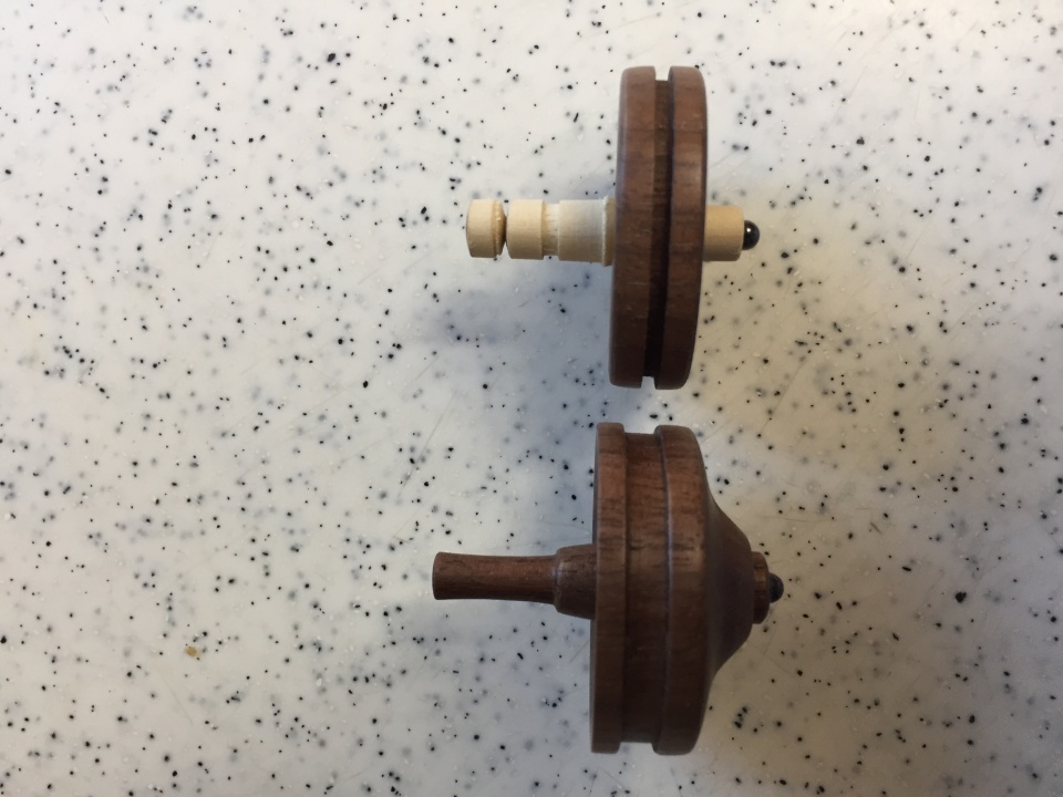

I made these a couple of years ago for stocking stuffers. They worked very well.
The ones that are dished out, and points slightly rounded seemed to spin the longest.

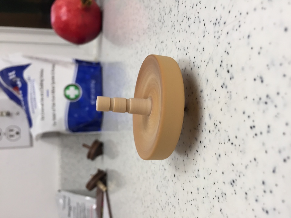

Well.....
.....the pictures aren't all that good, but here are two that spin the "best", and they don't measure up against others that I have heard about.
Spin times are a bit over 1 1/2 minutes when spun on my Corian counter top. A larger diameter would (I think) increase the time. These have a diameter of 1 1/2 inches.
Hmmmm, the spin time is about the same as the diameter. What if I made the diameter 5 inches? (Just kidding....)
