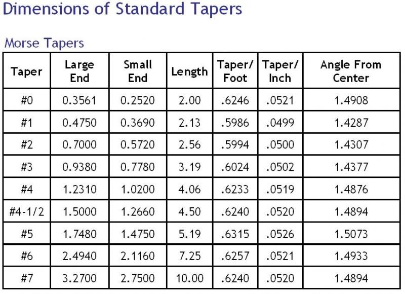

I want to start turning again so I dug out my old lathe. It's a Ryobi 18" mini lathe that worked like a dream. Here's the dumb question. I have all kinds of stuff to go in the head/tailstock but I wanted to get some other stuff and I don't know what the Morris Taper is. I've been going all over the web and can't kind anything. I bought it at Manards in Illinois, that was 3 states ago. Any suggestions to figure the taper?

Here is how you find out...you measure! :biggrin:

OK your both right it's a MT 1. Next stupid question. If I upgrade the lathe to a PSI VS which is MT2 is there an adaptor so I don't have to go out ans buy all new equipment?

There are adapters out there, I believe, that can go from one taper to another. One accessory that Ryobi made for it was a 3/8" drill chuck (item #4070618). From there all you need is a mandrel, which you could use in a PSI lathe. Contact Ryobi, they may actually have one.
There are adapters out there, but honestly with the cost of the adapters it would probably be cheaper to buy new stuff.

Your all right! I guess if I get a new lathe I should get everything new. I can use the Ryobi as a buffer for a variety of wood things I do. Thanks for all the answers and help.

Yes there are MT2 to MT1 adapters that will fit the upgraded lathe. You can get them at most wholesale tool companies. 2 will do all of the tools for head and tail stock. Wooden posts have thread adapters if you have chucks and face plates.

The Ryobi is 3/4 by 16 threaded and you can use the threaded headstock for a lot of purposes including a threaded on mandrel. I junked mine out this winter keeping the headstock for a buffer motor. PSI sells the threaded drive for pen mandrels.
The tail stock is MT1 also --
You probably do not want to try the MT2 to MT1 adapters because of runout problems.
Note that many of the 4 jaw scroll chucks come with a 3/4 by 16 adapter (Barracuda from PSI) or come with a replacable insert adapter (like oneway Talon).
Scott, just remember the more places you have pieces engaging in other parts, the more room and certainty you will be giving up accuracy and can incur alignment problems.
