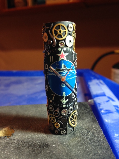

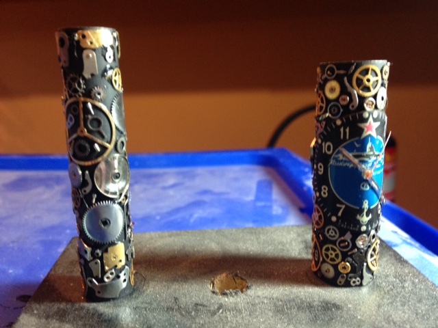

Hey all,
I haven't been around for quite a awhile and wanted to share a pen I am working on for my brother-in-law who is earning his doctorate in Russian Studies. I will present this to him at his graduation in May. He was given a watch by a friend of his he met in while studying in Russia. The guy was a submariner and the watch is one the old Soviet Union issued to submarine officers.

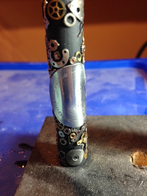

This took over well over 8 watches worth of parts to complete. I have been working on this for quite awhile and am finally ready to cast in PR. The second photo shows the part of the back of the watch case that I was able to use because it had a serial number and something written is Ruski.

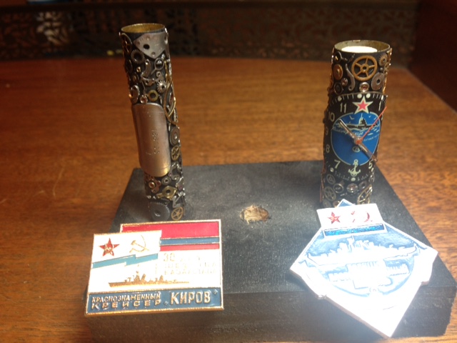

My plan is present in a nice box that will be adorned with some USSR uniform pins (shown also). While I am not thrilled with the fact that it is USSR memorabilia, I hope it will still be unique, nonetheless. I plan to team this with Statesmen Fountain Pen hardware. Sorry for the crappy photos, I don't have my photo tent set up but will for when I get it completely done. Critiques always welcome.

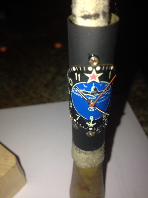

A few more earlier photos.....I try to fill in as much space as humanly possible with smaller parts (screws, jewels, springs, etc)

The full sized Statesman is a good choice for the parts your using as you need as much meat as possible. I also like the color background.
Agreed, I usually do smaller watch faces and like to use the Jr. Statesman but everything Russian seems to be chunky/funky and it wouldn't have looked right with the smaller format. Thanks Okey!!
I like the blue face and am glad you shown us a better view. That is what is going to make that pen stand out. I also like the fact you filled it up with parts. Too many of the pens I have seen do not do this.
One thing I would make sure those hands are bent a little more before casting. Also give us a description on how you go about casting it. With that many parts it is always possible to get air pockets. Like to hear your approach and your results. Look forward to seeing when done. Make sure to take photos before presenting.
You caught that!!! Yes, I have to tack down the second hand (it kind of sprung back on me) CA will fix that.
For the casting, I will use a Resin Saver. In the past with watch parts, before pouring the PR, I heat the resin in my ultrasonic jewelry cleaner and pour slowly. I then use a curved dental scraper to "manipulate" any bubbles that may be trapped underneath. I havent had any problem with bubbles since doing this. I then use a UV light box that I made to assist with curing. Seems to help curing consistently. I haven't done this in two years, so I need to order some PR. The last stuff I had was from US Composites. If there is something that is better, let me know.

Using the pins from the cruiser Kirov and what appears to be a Kashin class destroyer on the box might be considered by some as mixing apples and oranges (submarine-themed watch pen and surface navy plaques). But, hey ... whatever floats your boat ....
I might pre coat but one time I did that, I was in a hurry and didn't inspect under magnification and noticed a bristle had come loose from the brush. Wasn't easily noticed but I knew it was there.......into the jar of acetone it went:mad::mad:
As a student of the former Soviet Navy, I can really appreciate this pen. I, for one, am looking forward to seeing the finished pen.
Great observation and thanks for your service!! Unfortunately, my brother-in-law only had pins from surface ships.....it would have been cool to have the actual uniform pin from this particular submariner to tie it all together!!
