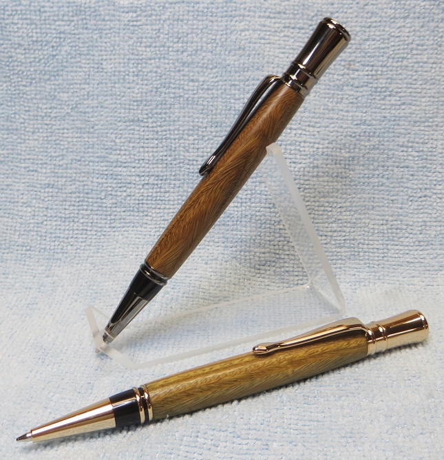

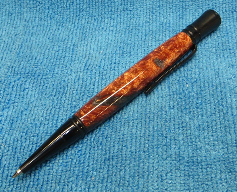

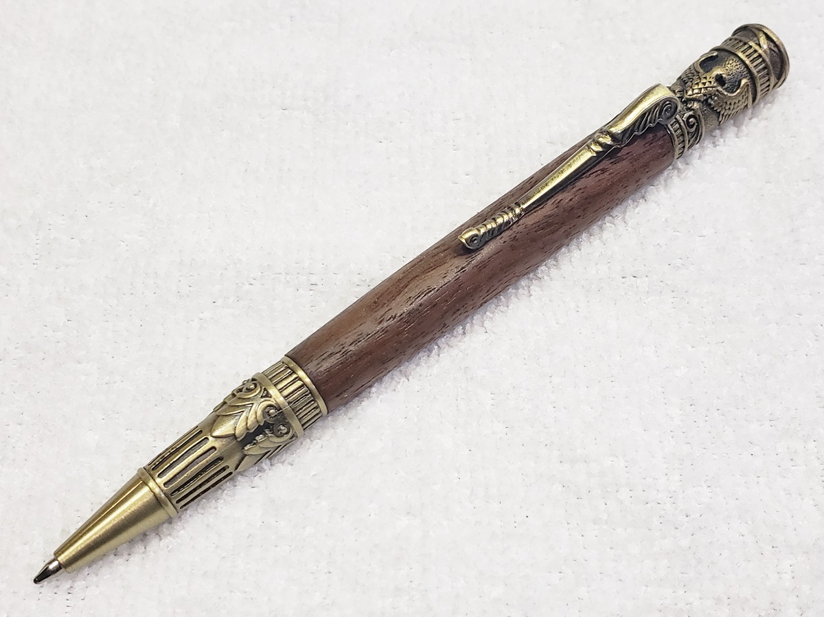

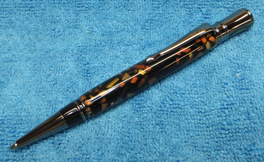

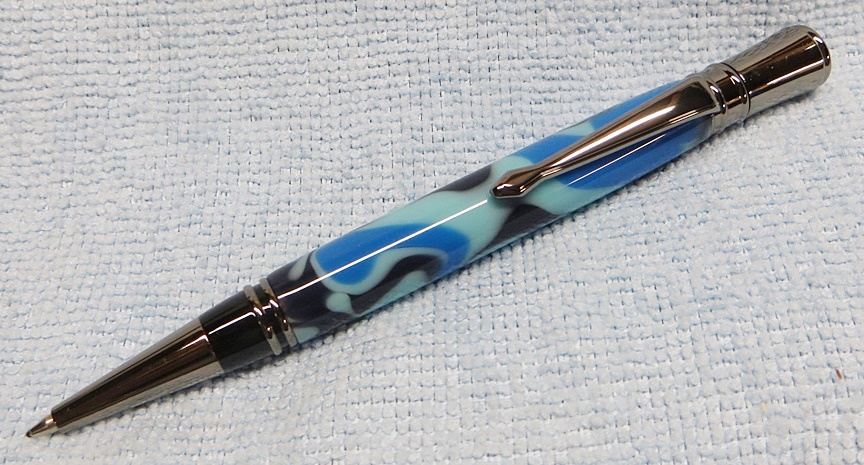

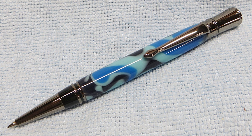

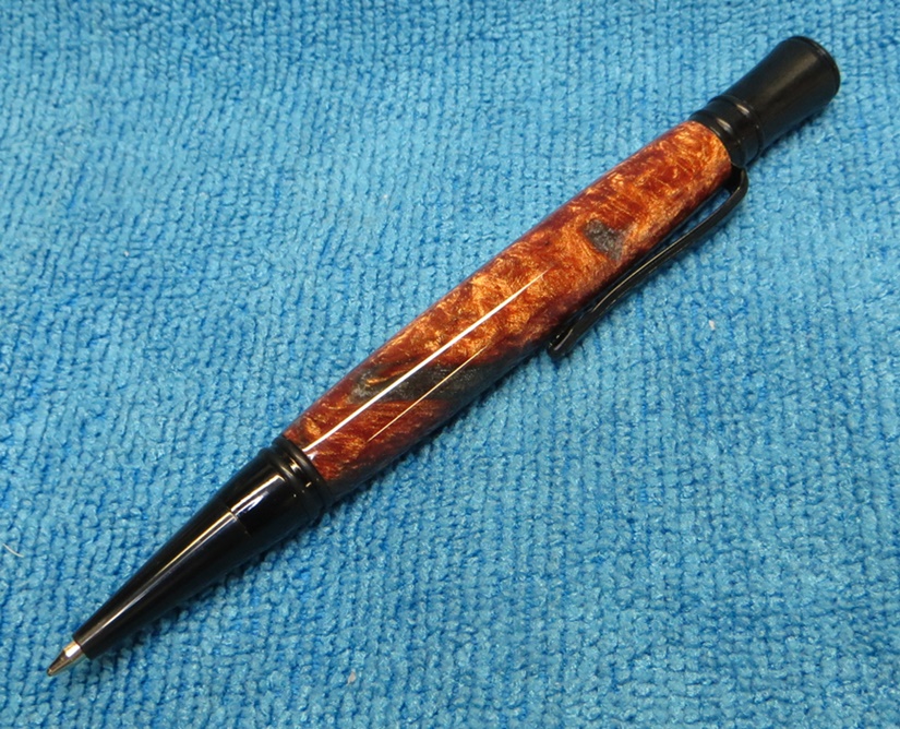

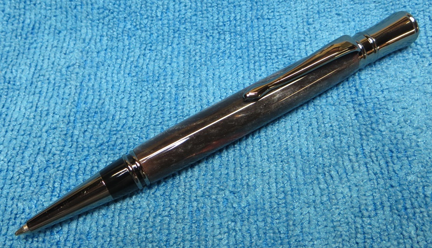

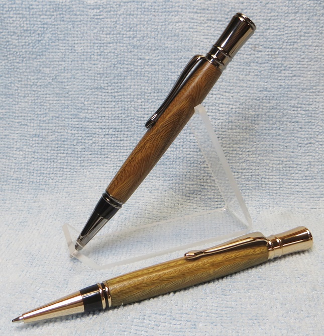

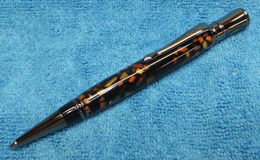

I know a lot of people start with the slimline, as did I. But I don't believe it's the best kit to start with. I think a larger body pen is easier and more forgiving. My recommendation would be the Executive. It's inexpensive, comes in several finishes, looks great, and only has one body to turn. I've turned a lot of them, and still do.

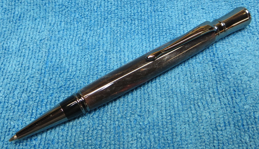

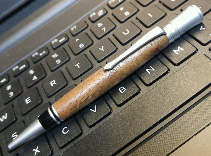

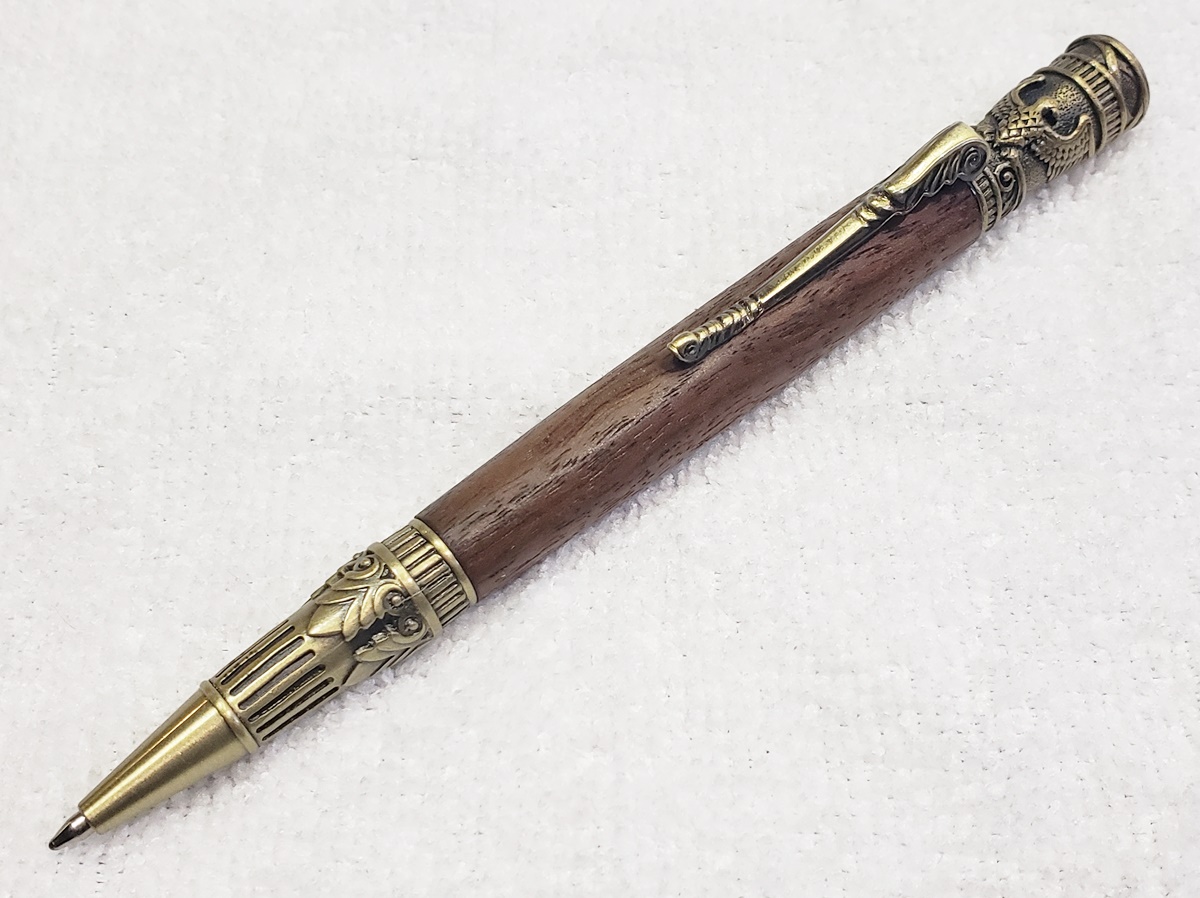

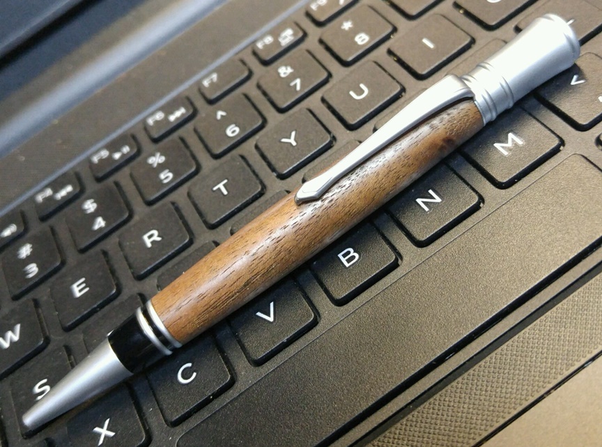

I would also recommend some sort of tight grained wood like walnut. Don't start with acrylic, it's harder to turn and requires some experience, in my opinion. You can use a simple finish like Danish oil, which is what I used on this one.

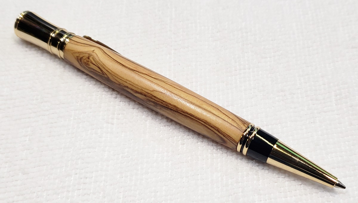

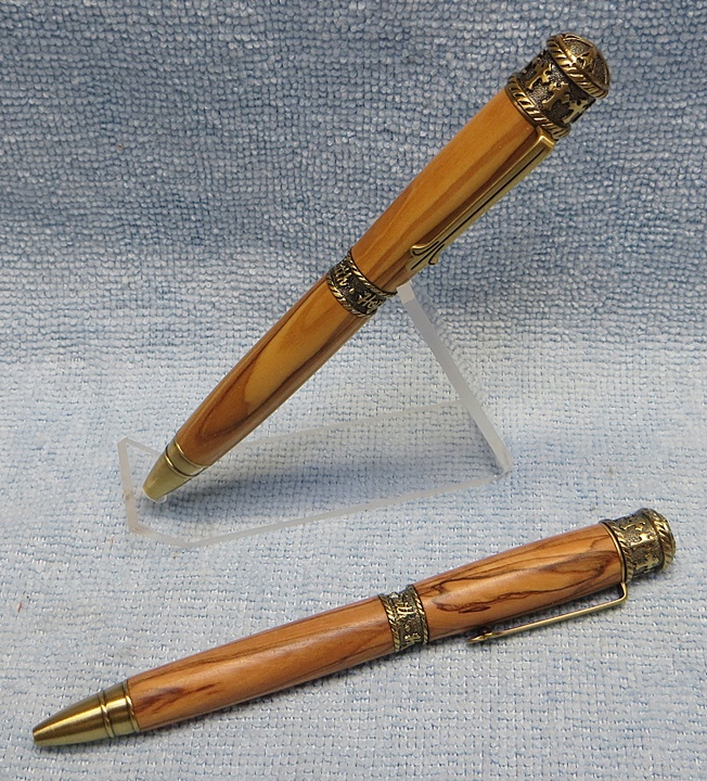

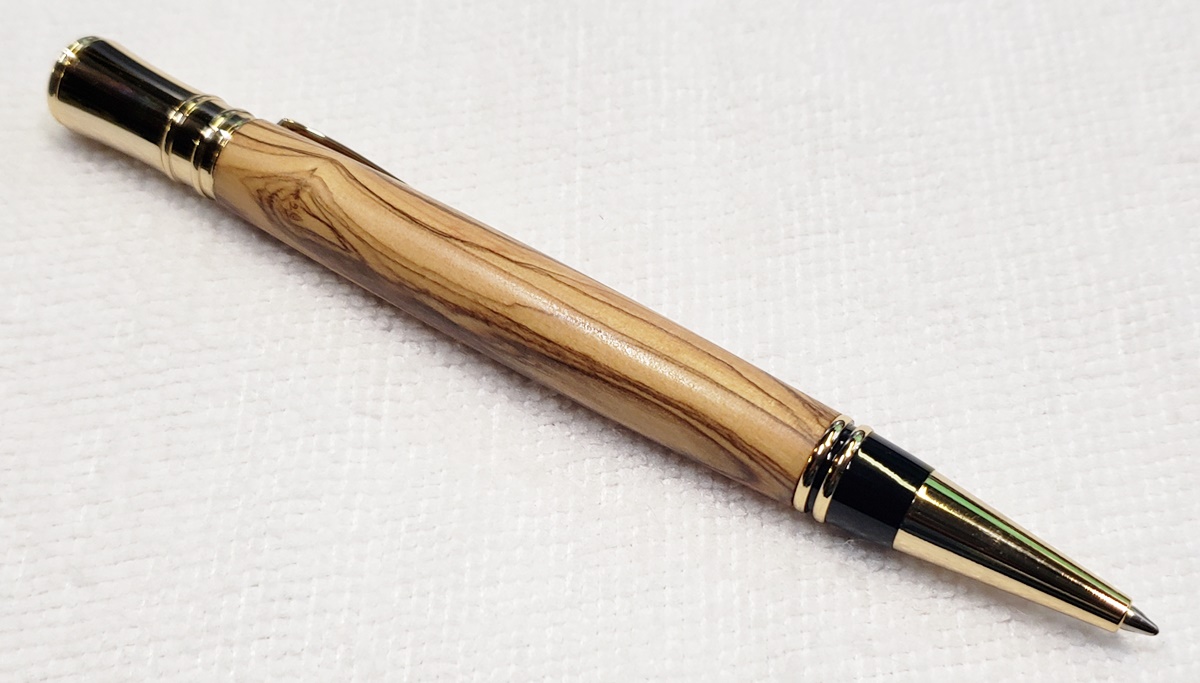

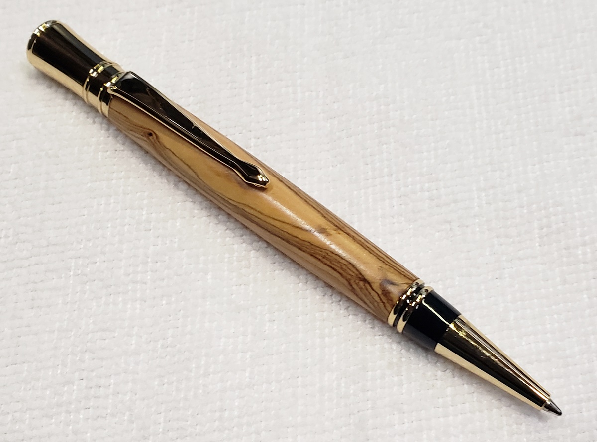

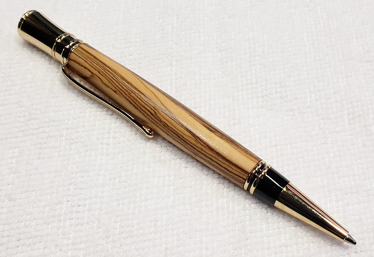

Olive wood, is super forgiving, smells great, looks great, and cuts like butter. It also doesn't tear out.

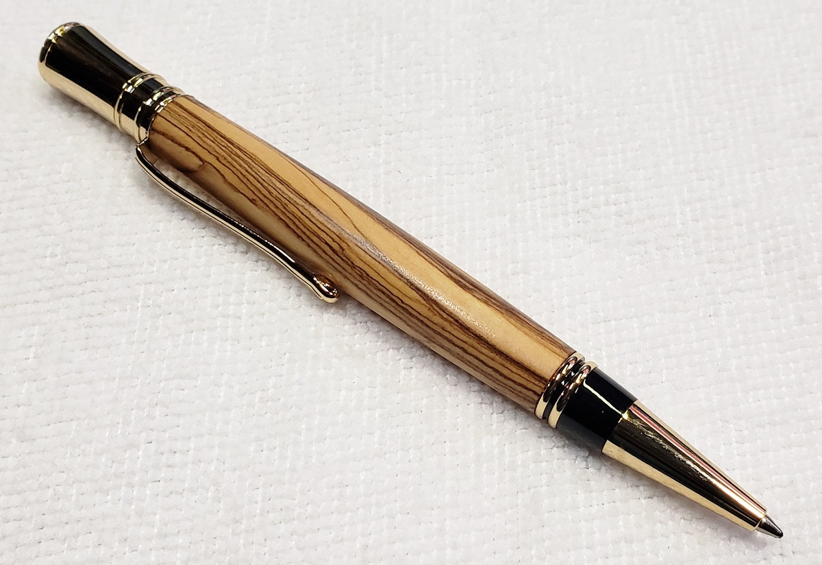

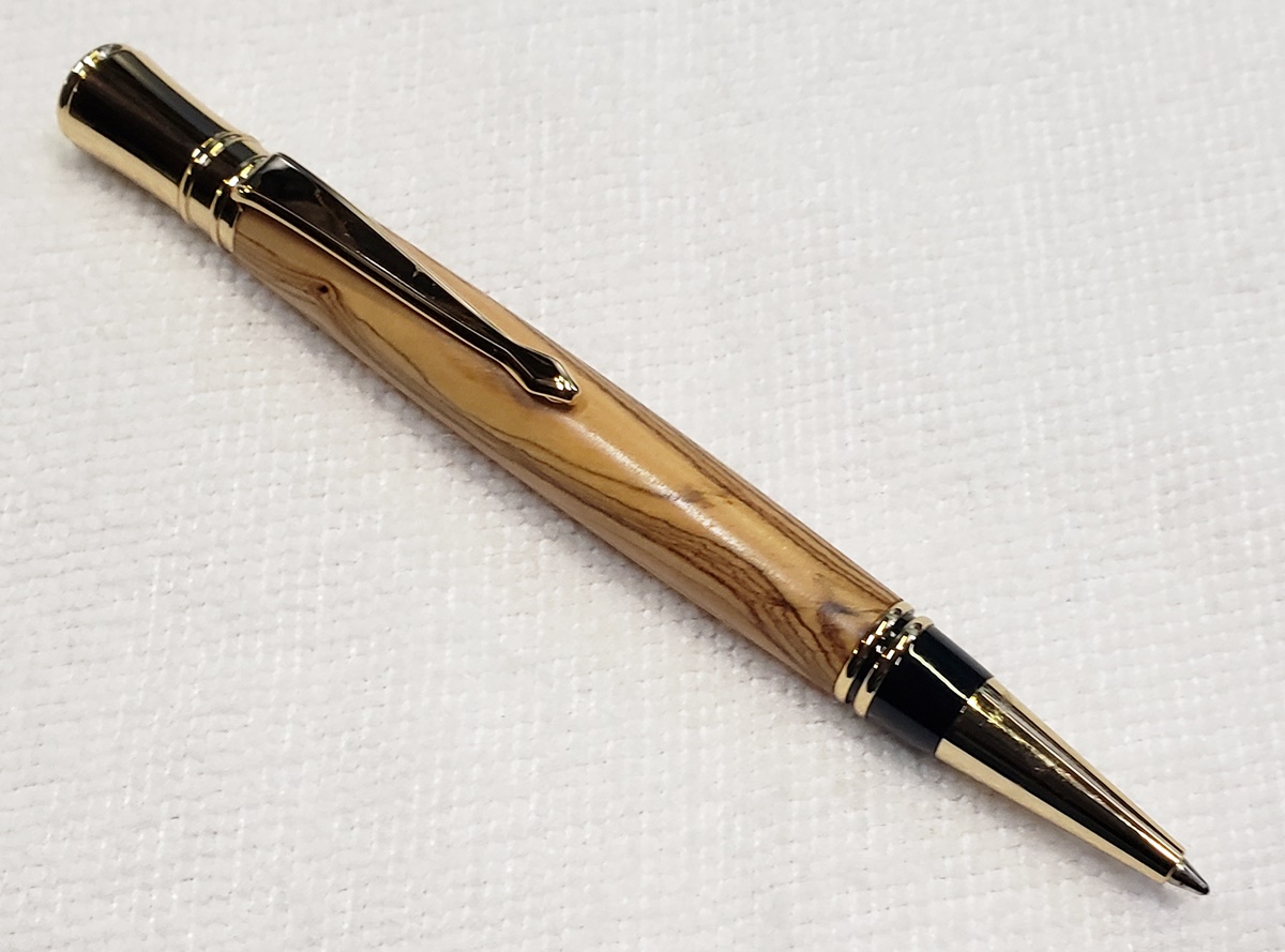

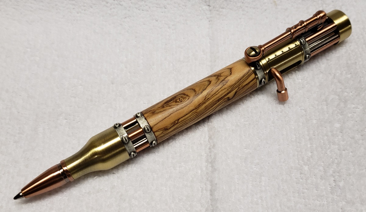

Here is an Executive in olive wood, finished with Danish oil.

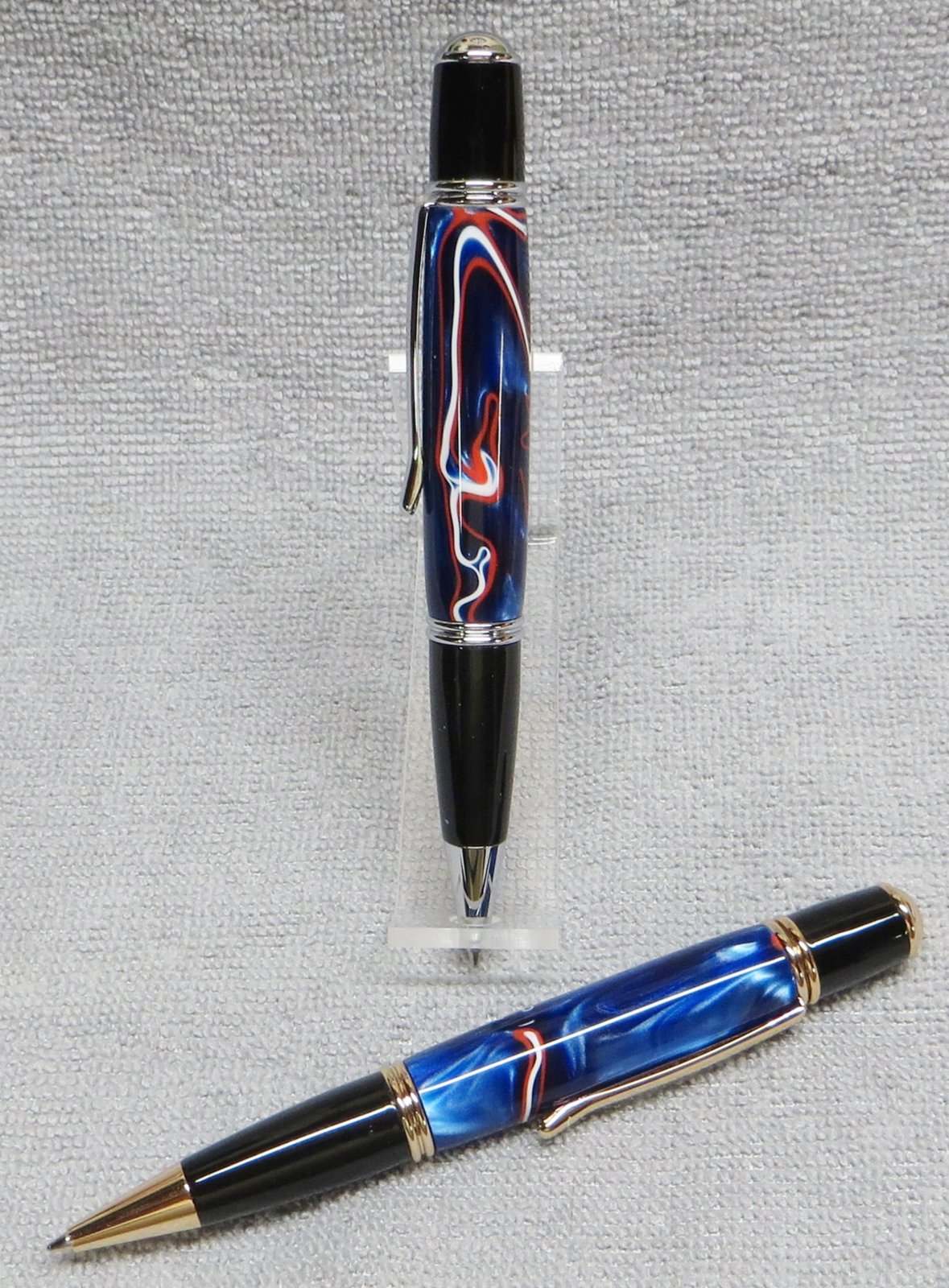

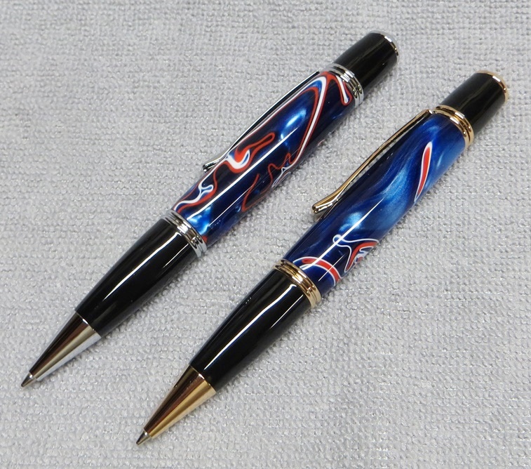

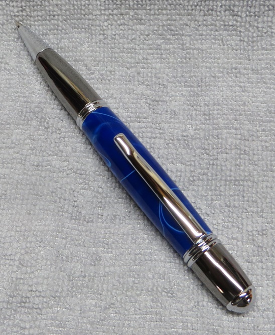

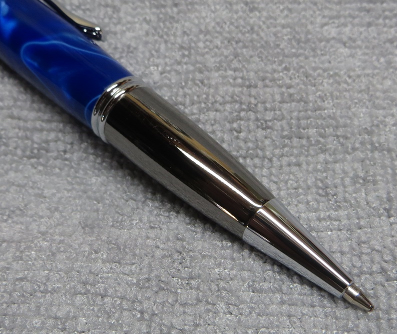

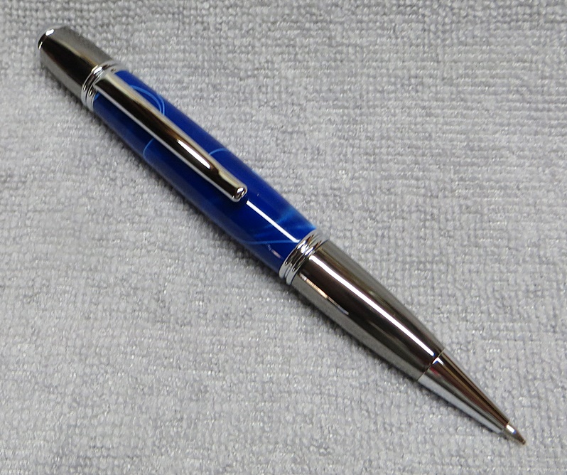

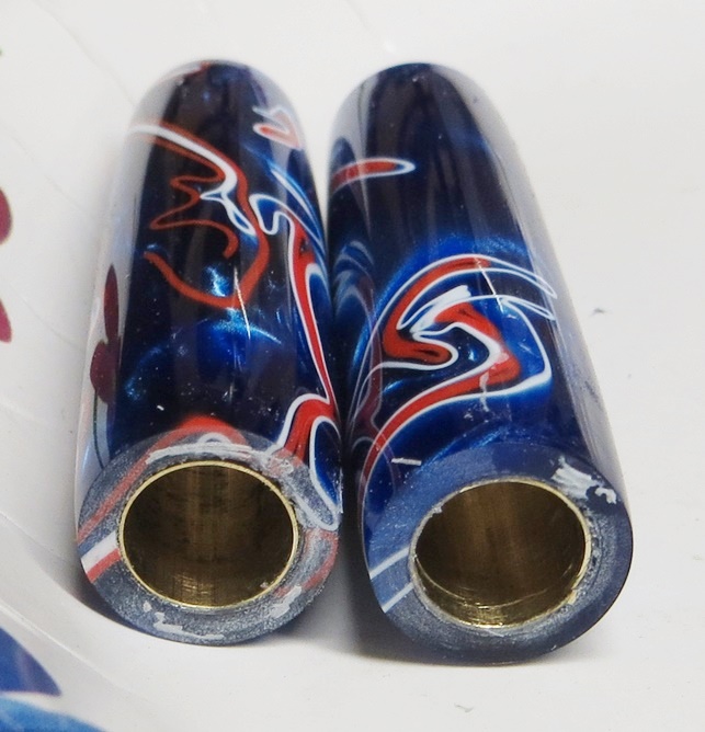

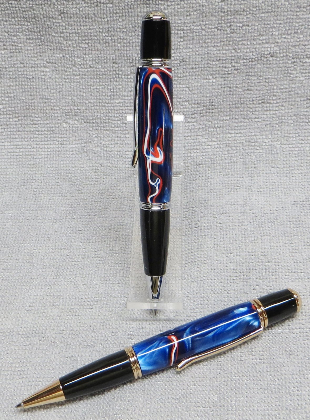

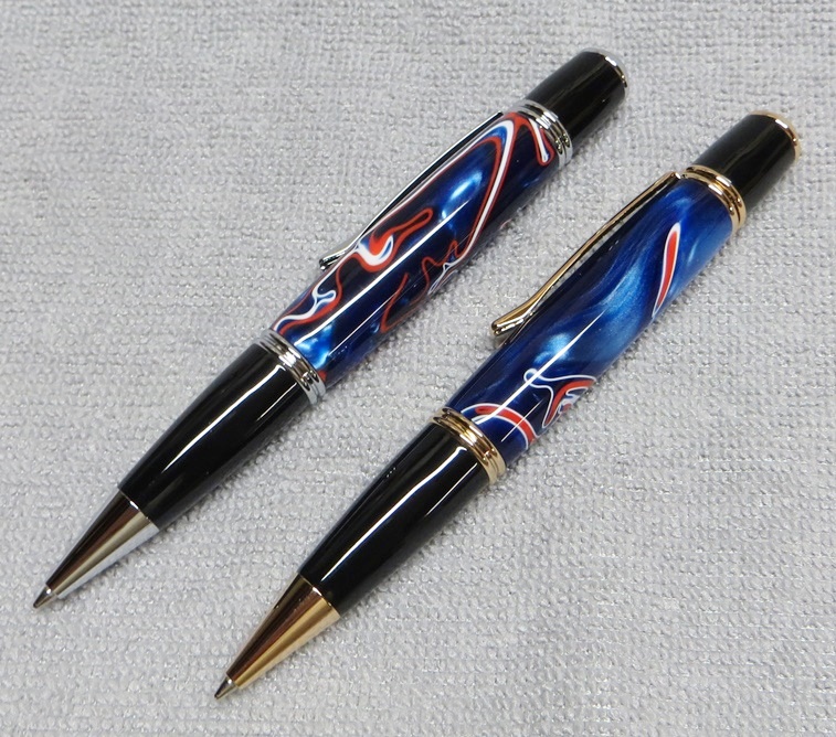

KLJ has a point about the Gatsby. Because of the ring, especially at the tip end, the final diameter isn't as critical. It does take a bigger drill bit, 27/64" vs. 3/8", but the thickness of the material after it's turned is slightly more with the Gatsby.

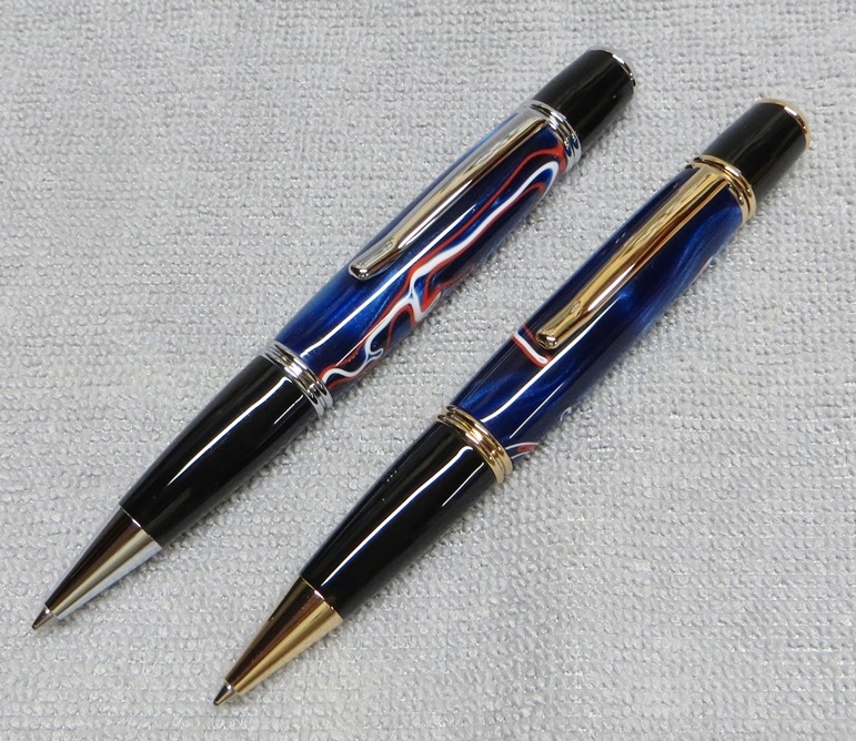

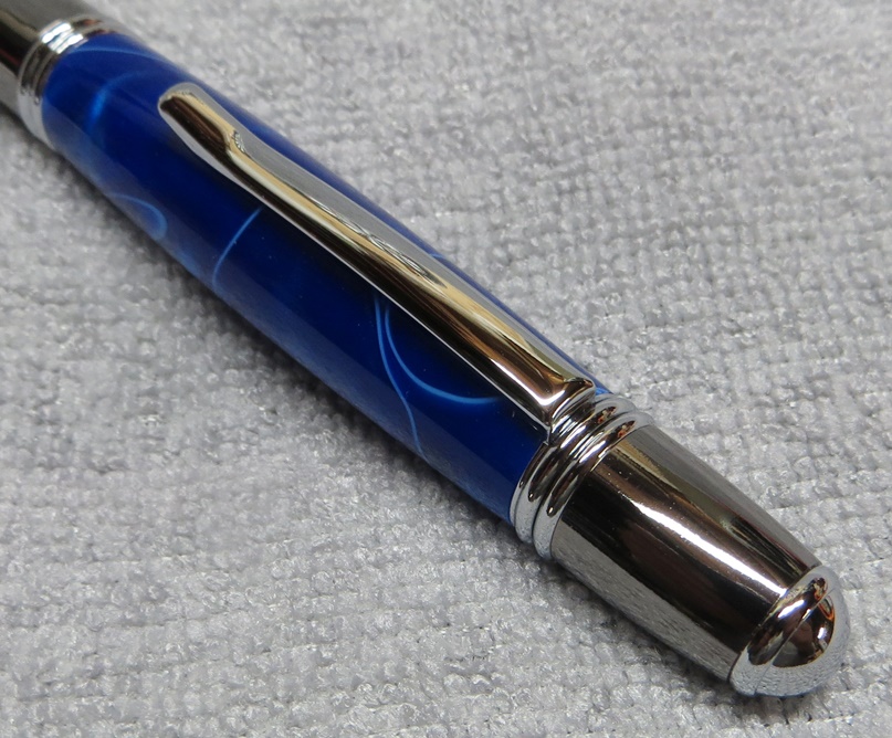

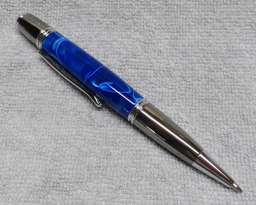

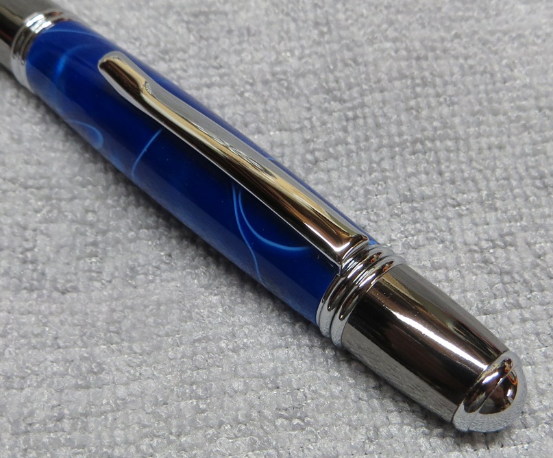

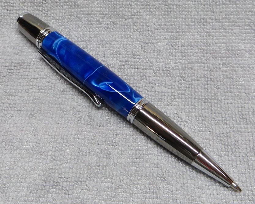

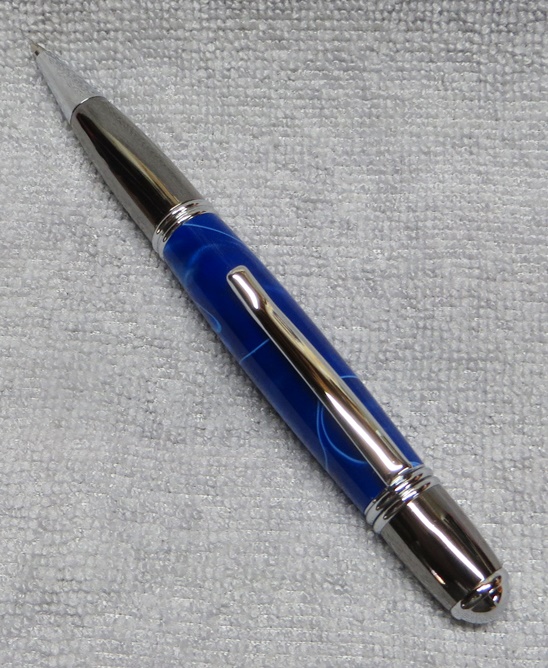

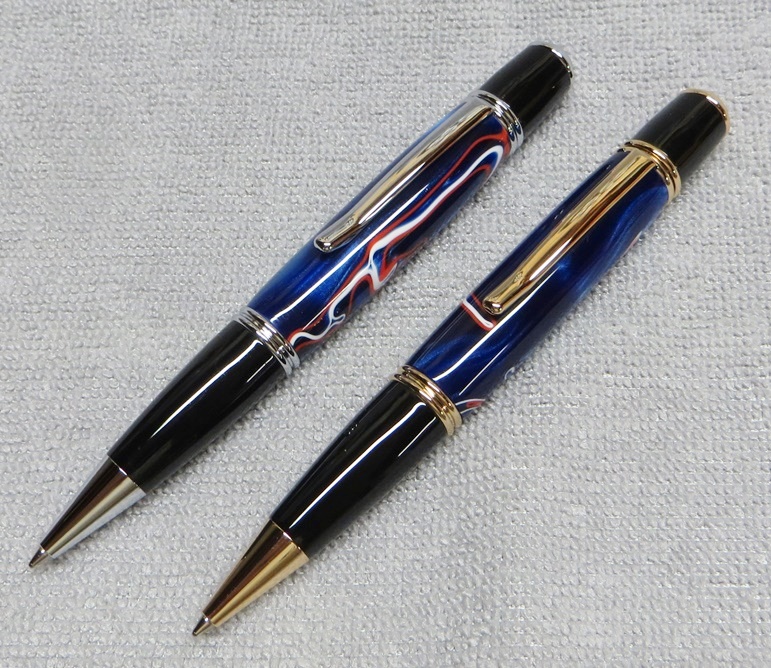

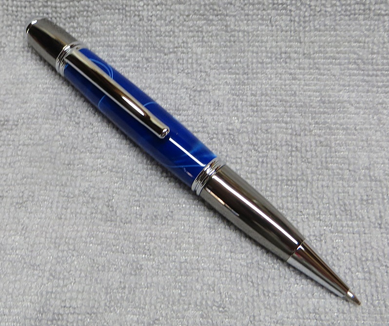

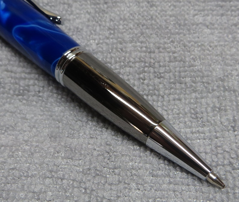

There is also the Gatsby Grande. It's a larger diameter version of the Gatsby. It uses a 3/8" drill bit, so the material on the body is thicker.
