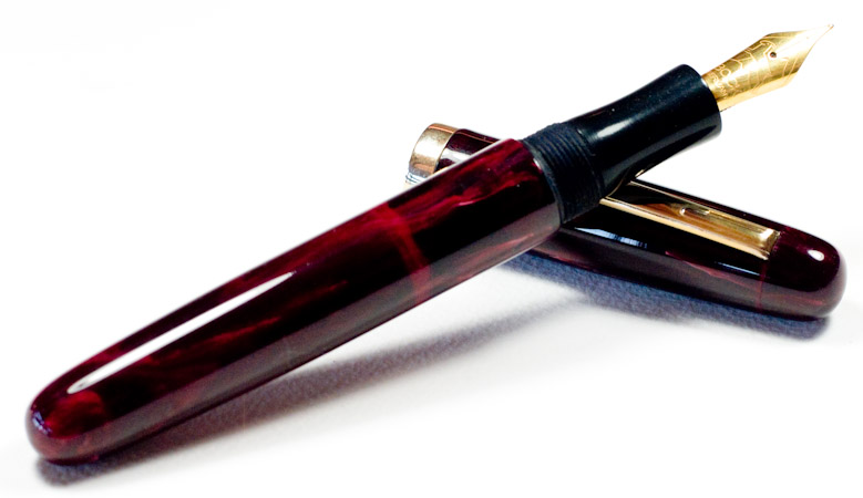

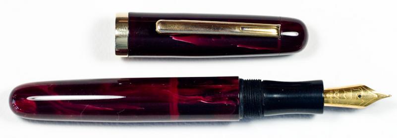

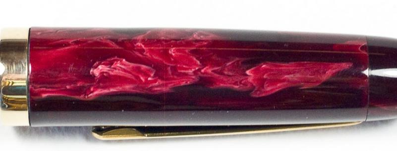

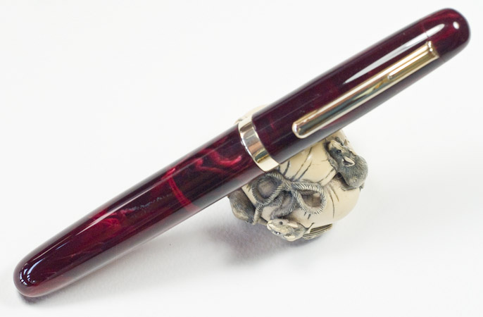

I haven't posted much recently, but I was fortunate enough to get some Ruby Red Bakelite from Dawn and Ed, and think the material is extraordinary and worth a look. I had to re-learn some techniques because the Bakelite is so brittle, but found that it polishes up beautifully. The fittings are plated in 24k gold and the nib is a 6mm Bock.
Thanks for looking.
Doug

Very nice Doug. Really like that blank with the black and gold combo makes for an exquisite pen. I took notice on the center band. Is that custom also? Thanks for sharing.

Beautiful pen and work Doug! also Doug i think showing clip ring would of worked ok with the center band and this blank.
Thank you. I debated adding a ring either at the top (the clip ring is much too small) or the bottom of the barrel, but decided in favor of not interrupting the material pattern in a "less is more" kind of way. I agree, tho, that you can never have too much sparkle.
