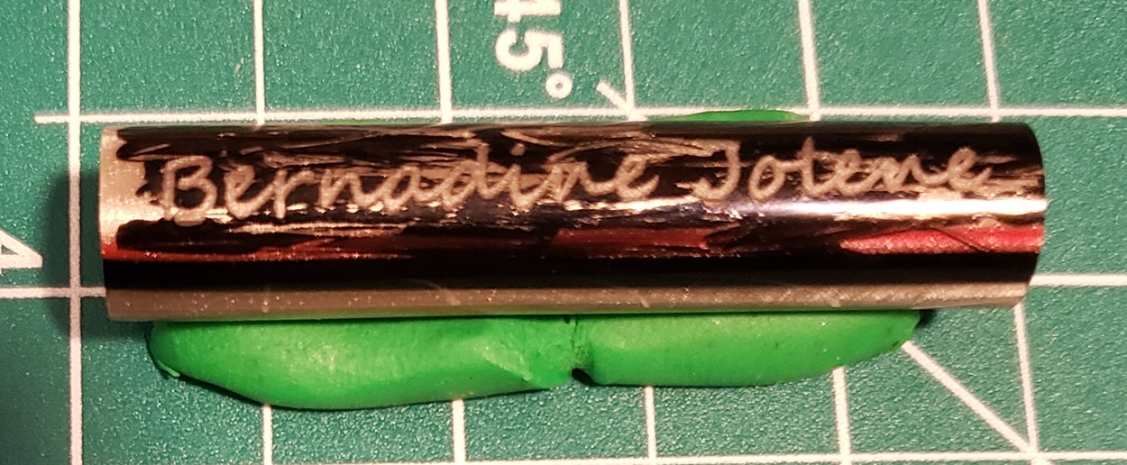

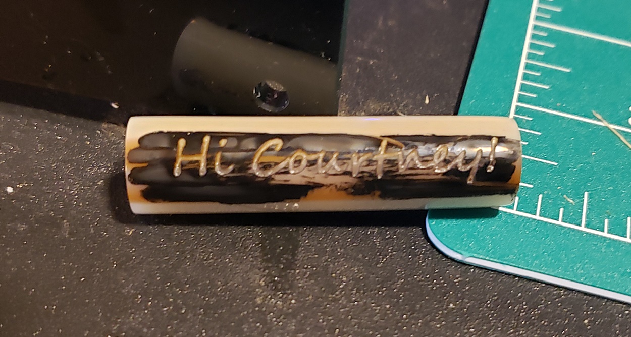

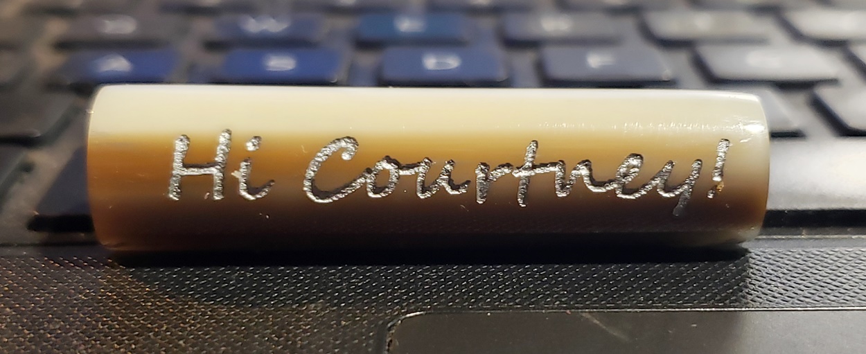

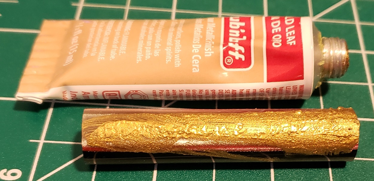

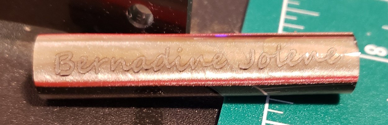

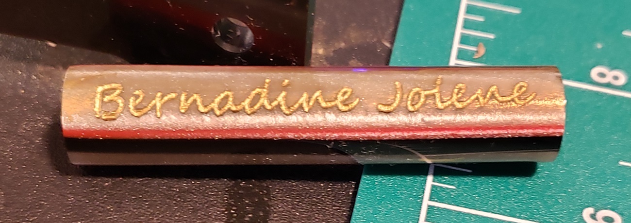

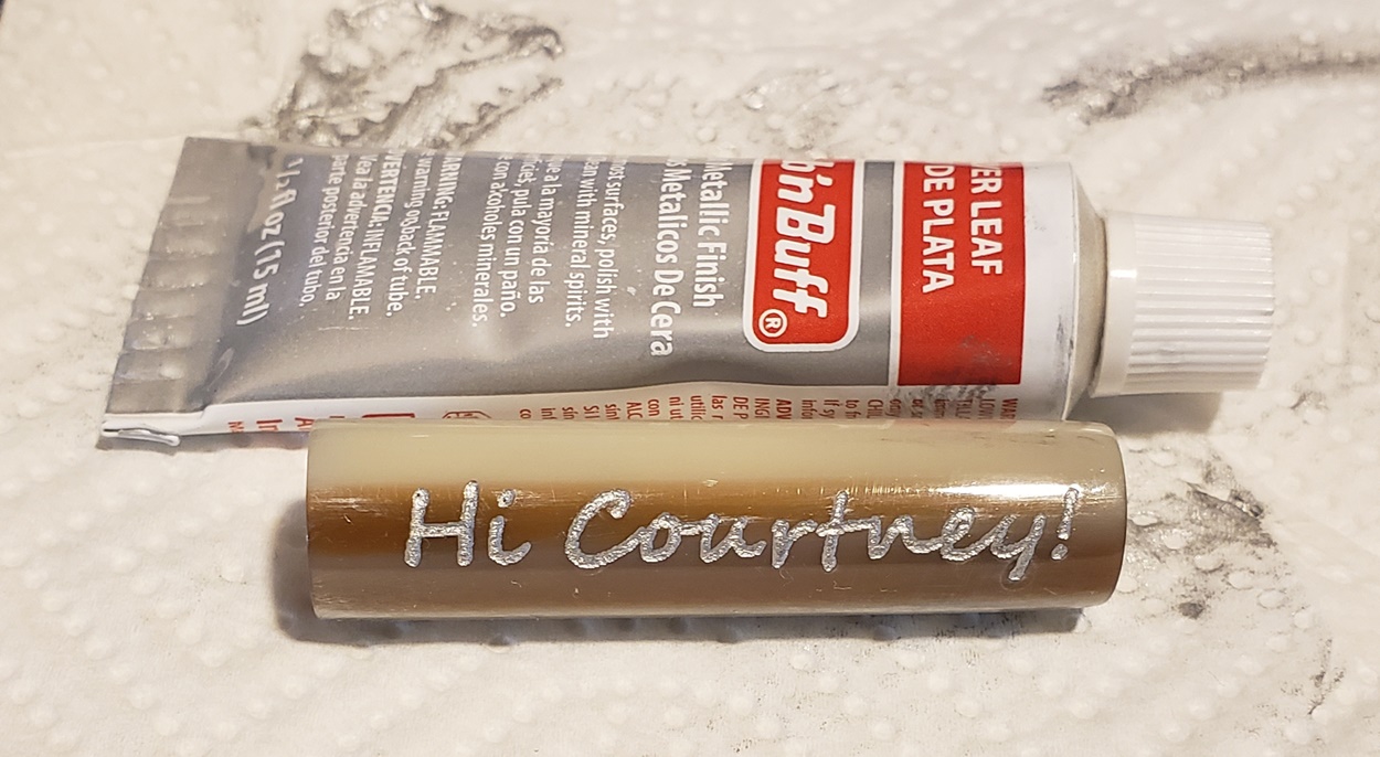

I'm getting the best results with Rub'n Buff. I definitely like the silver better.

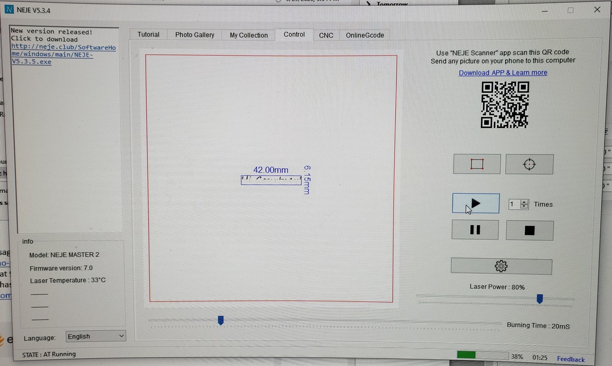

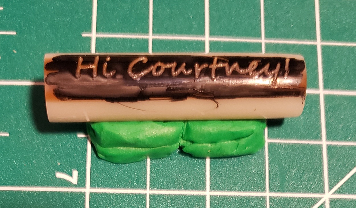

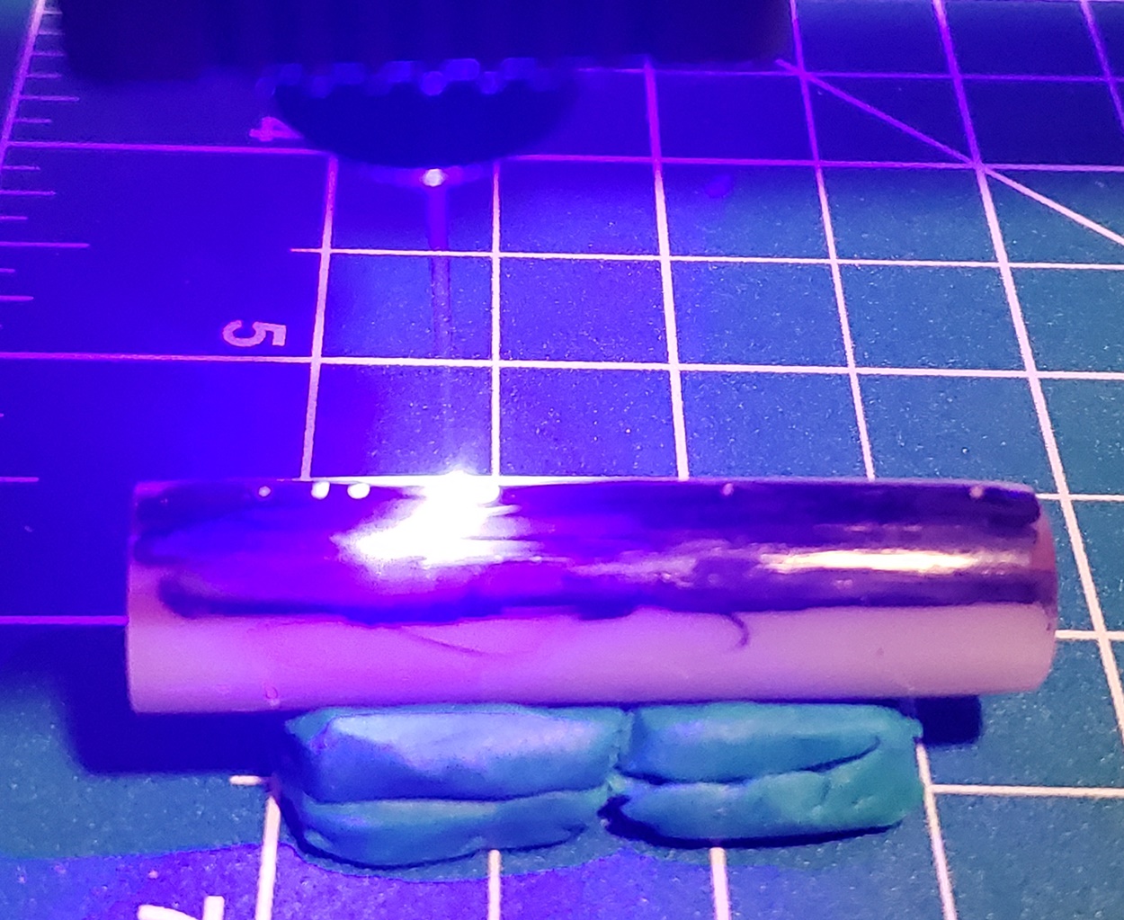

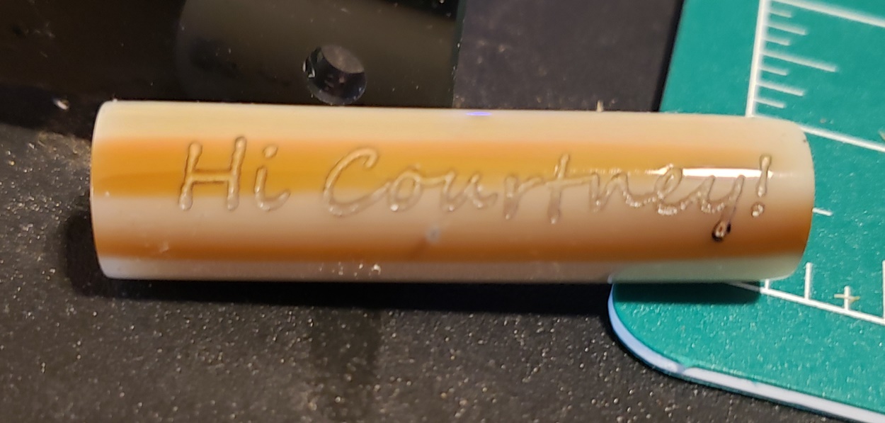

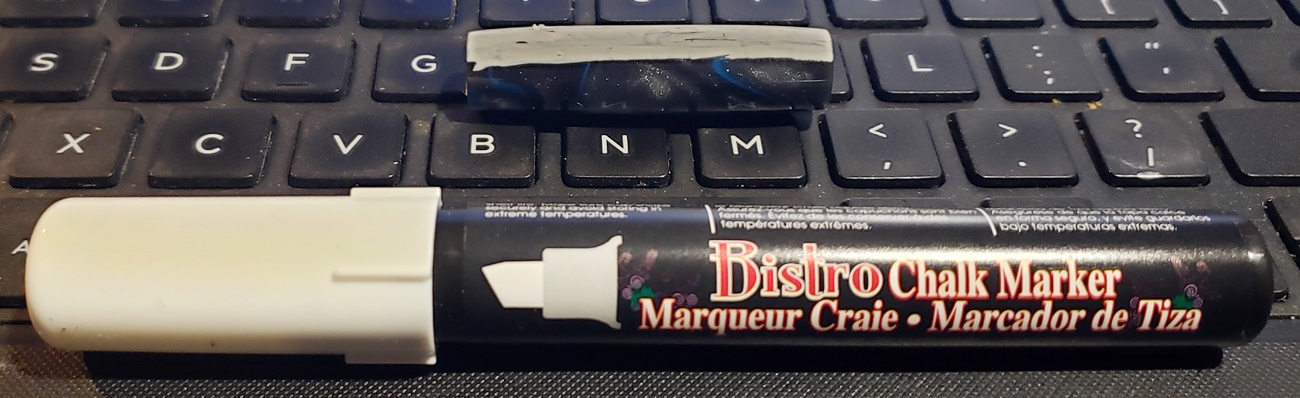

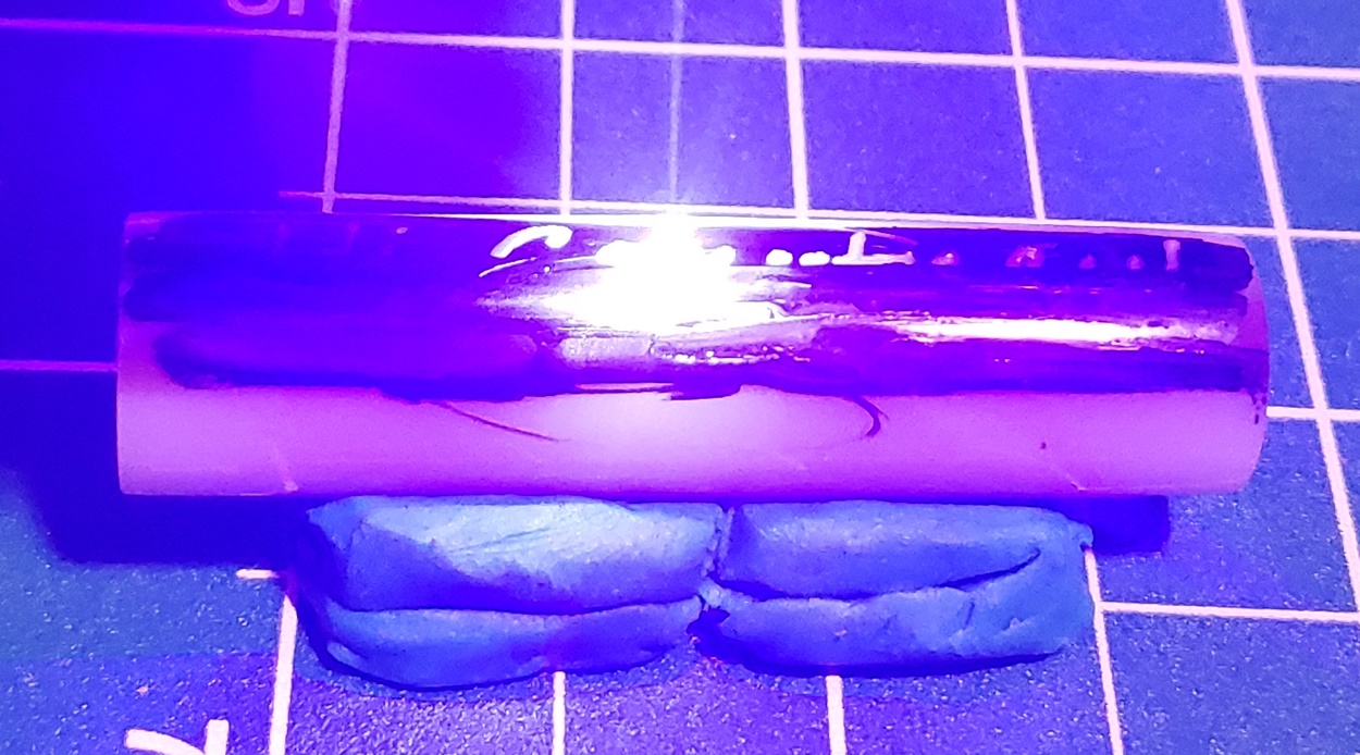

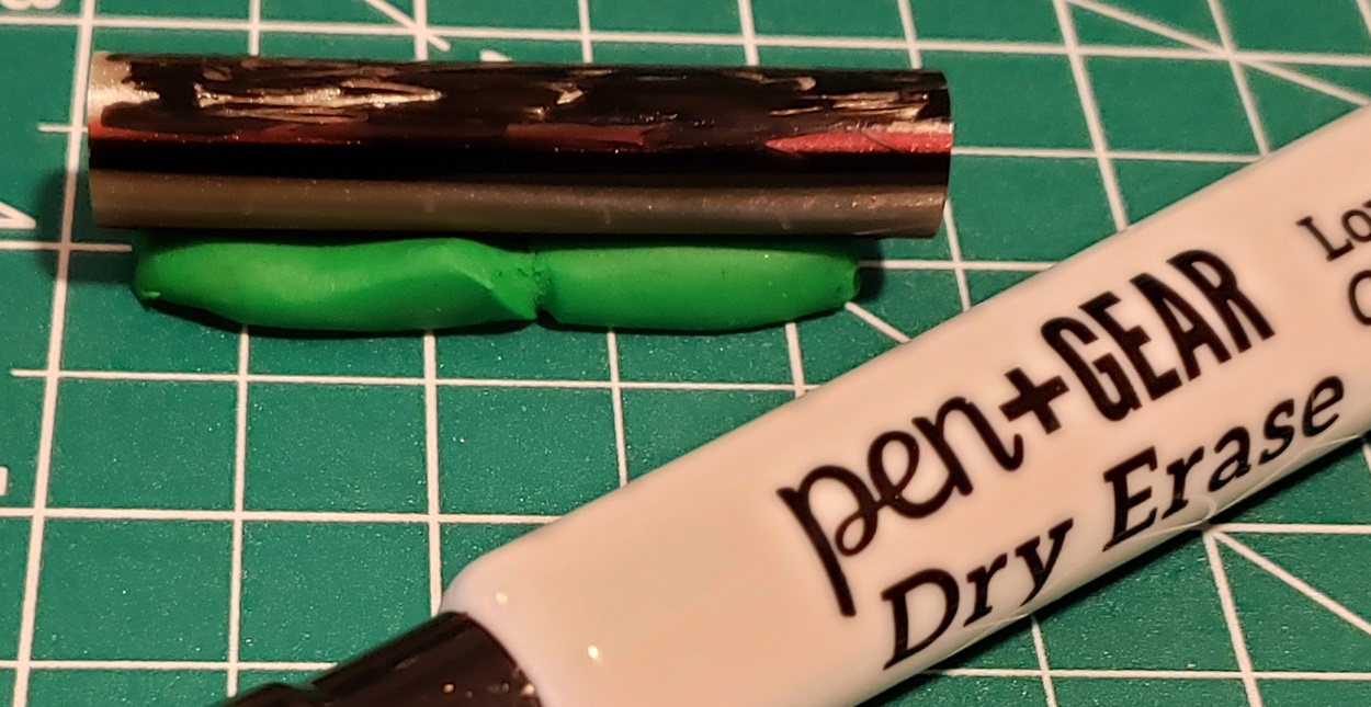

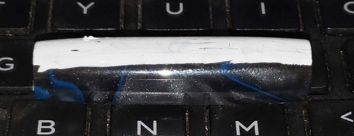

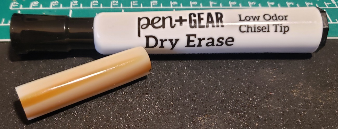

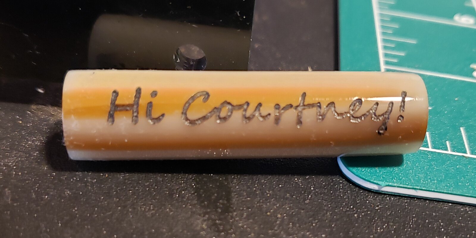

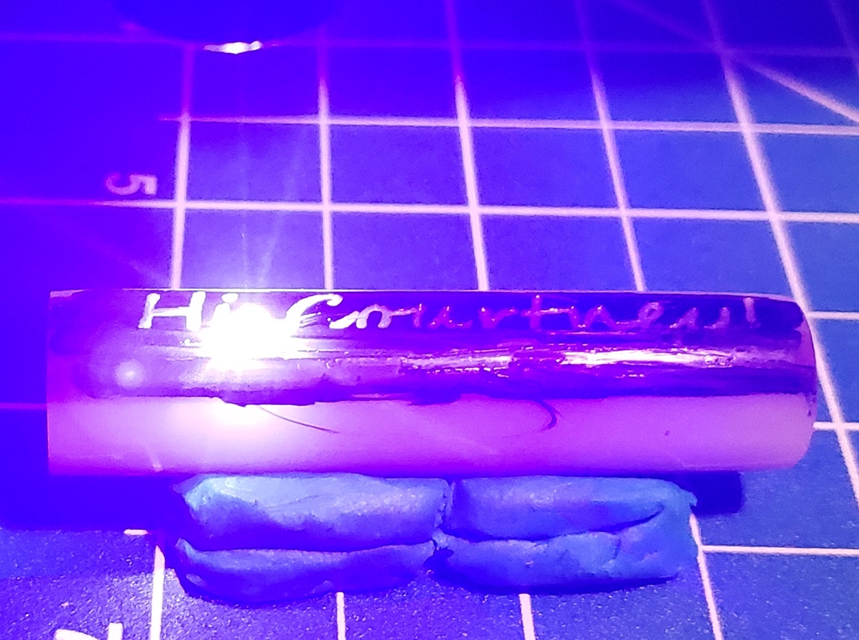

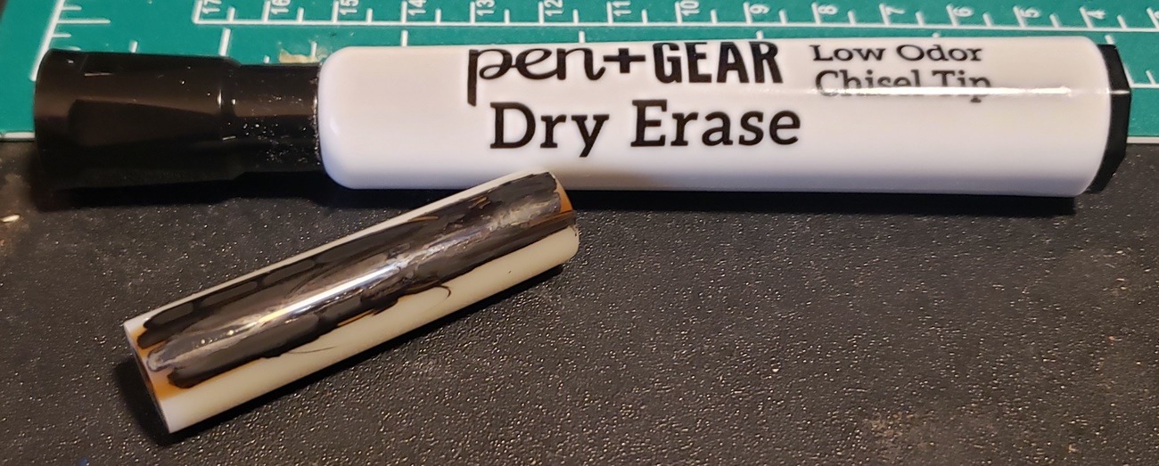

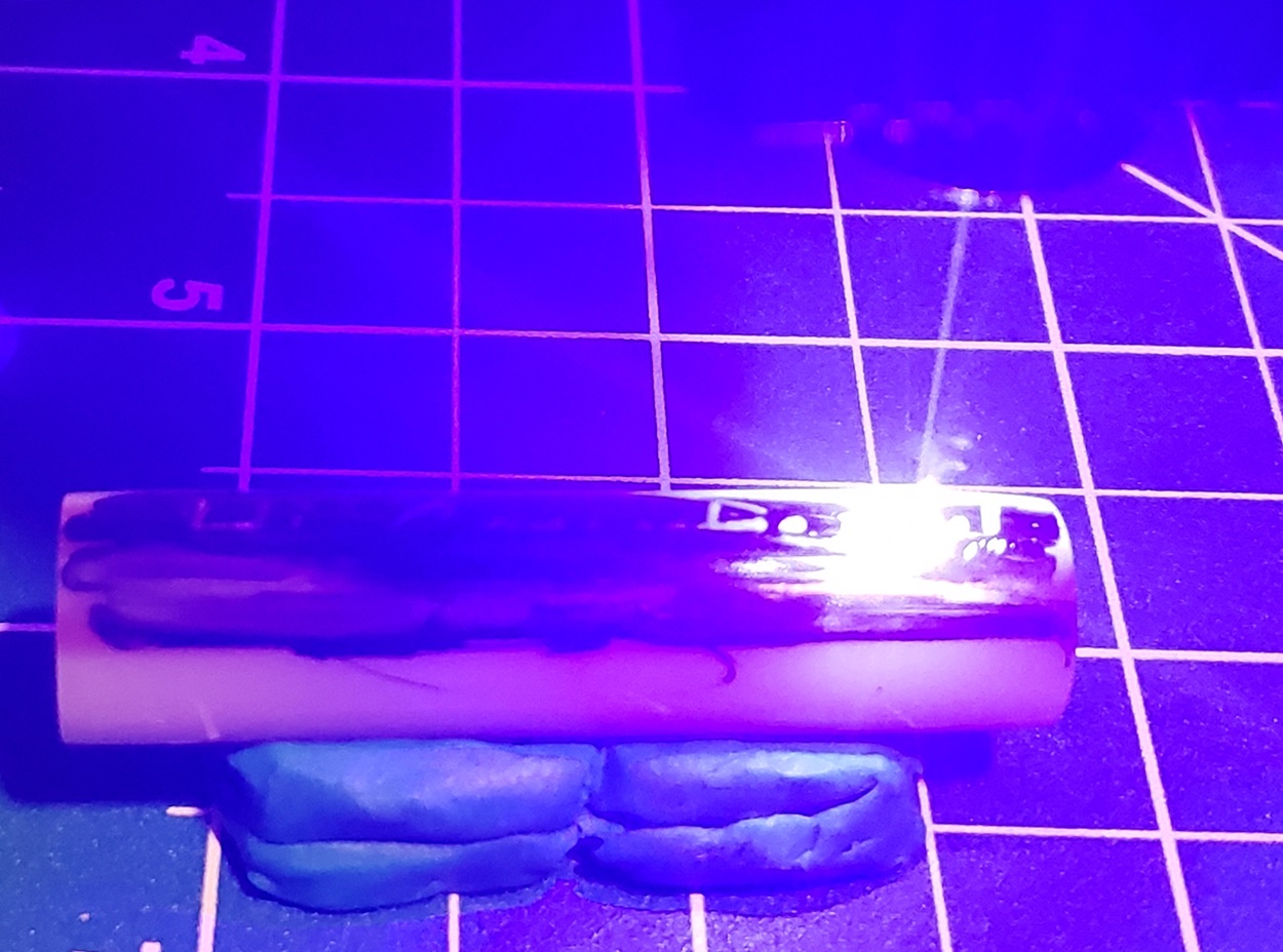

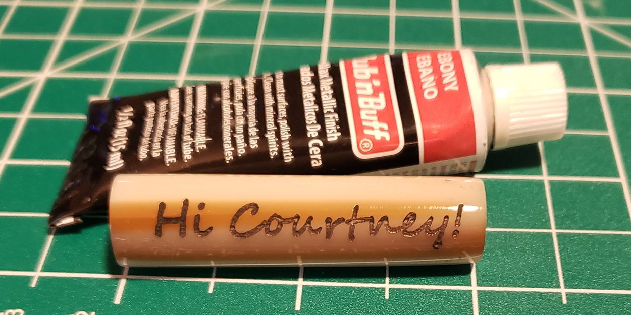

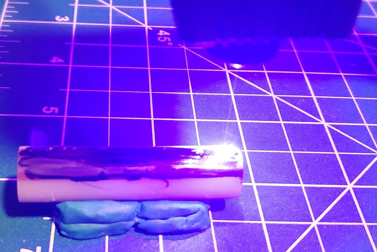

So far, I haven't applied any finish over the Rub'n Buff. I've only used it for filling engraving on acrylic pens. For wood, the engraver "burns" it, so it's dark and shows up. Acrylic doesn't burn, hence the need for some sort of fill. None of the pens I've used the Rub'n Buff on have been used enough to get a feel for its longevity. I finish wood pens with Pens Plus before engraving. I polish acrylic pens before engraving. But since they're reflective, you have to use something like a dry erase marker on it before you engrave. Then it can be rubbed off before filling it. I recently heard about using liquid chalk the same way, and got a liquid chalk pen to try.
