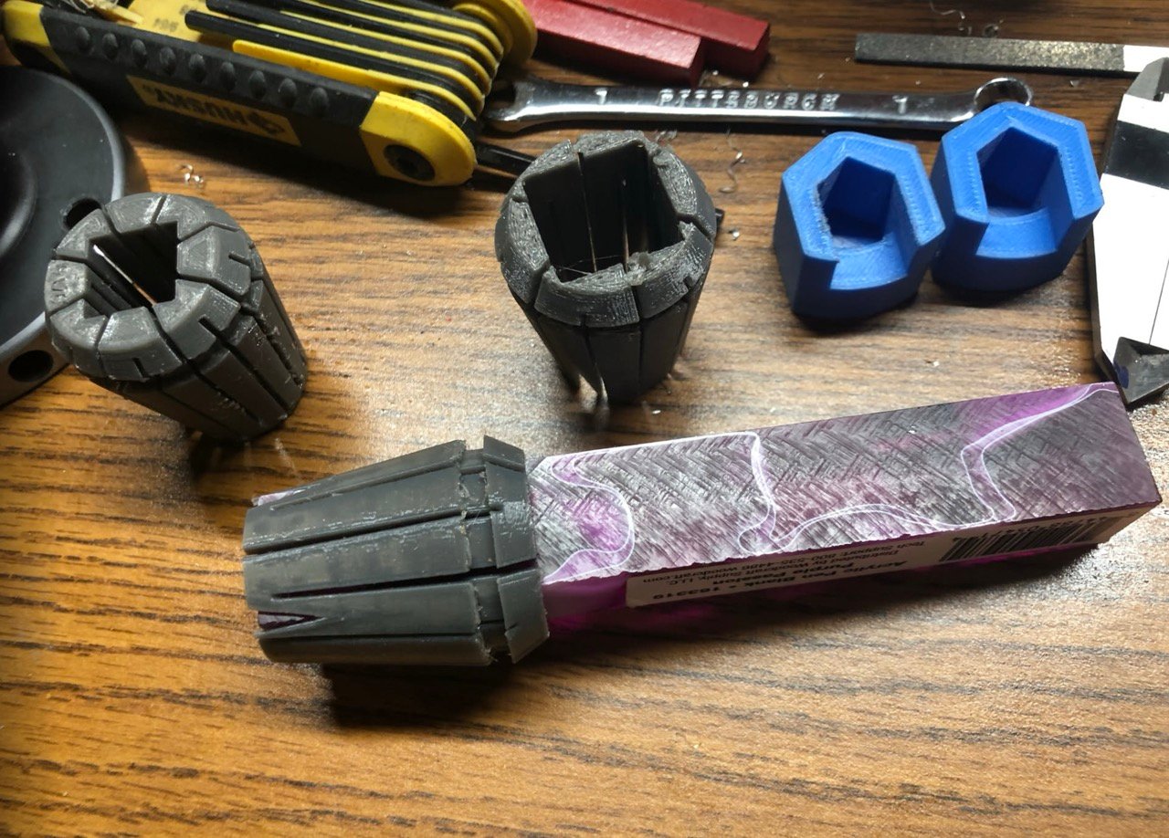

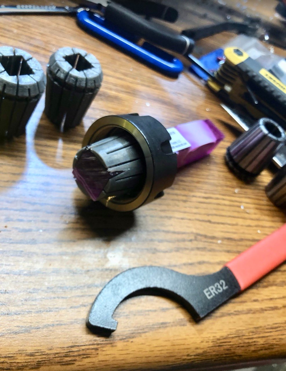

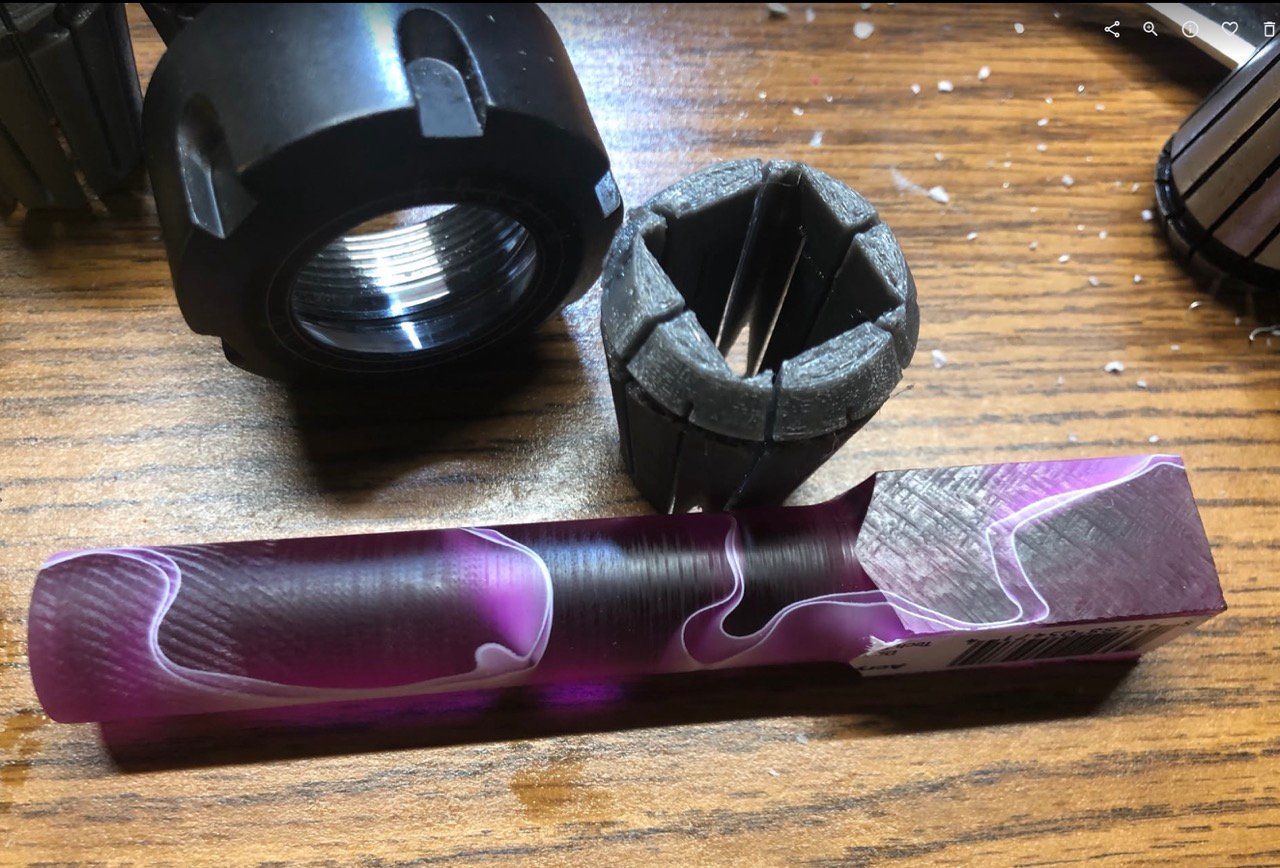

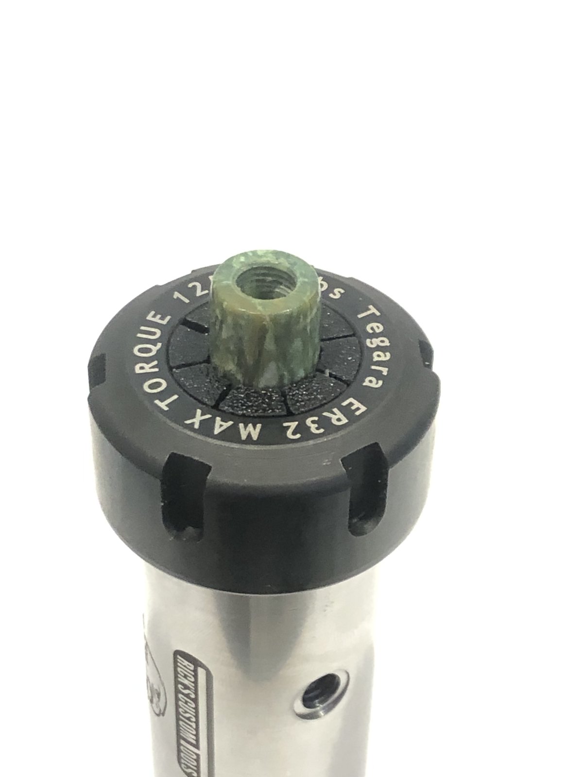

I have designed collets in CAD and 3d printed them.
I made this one years ago in PLA on my old ender 3 printer for square blanks :-)
I haven't had access to lathes for a while but I have a new desktop CNC on order.
I might revisit 3d printing collets in something like TPU and see how that works.

TPU works great as far as grip it's the longevity that I'm concerned with.

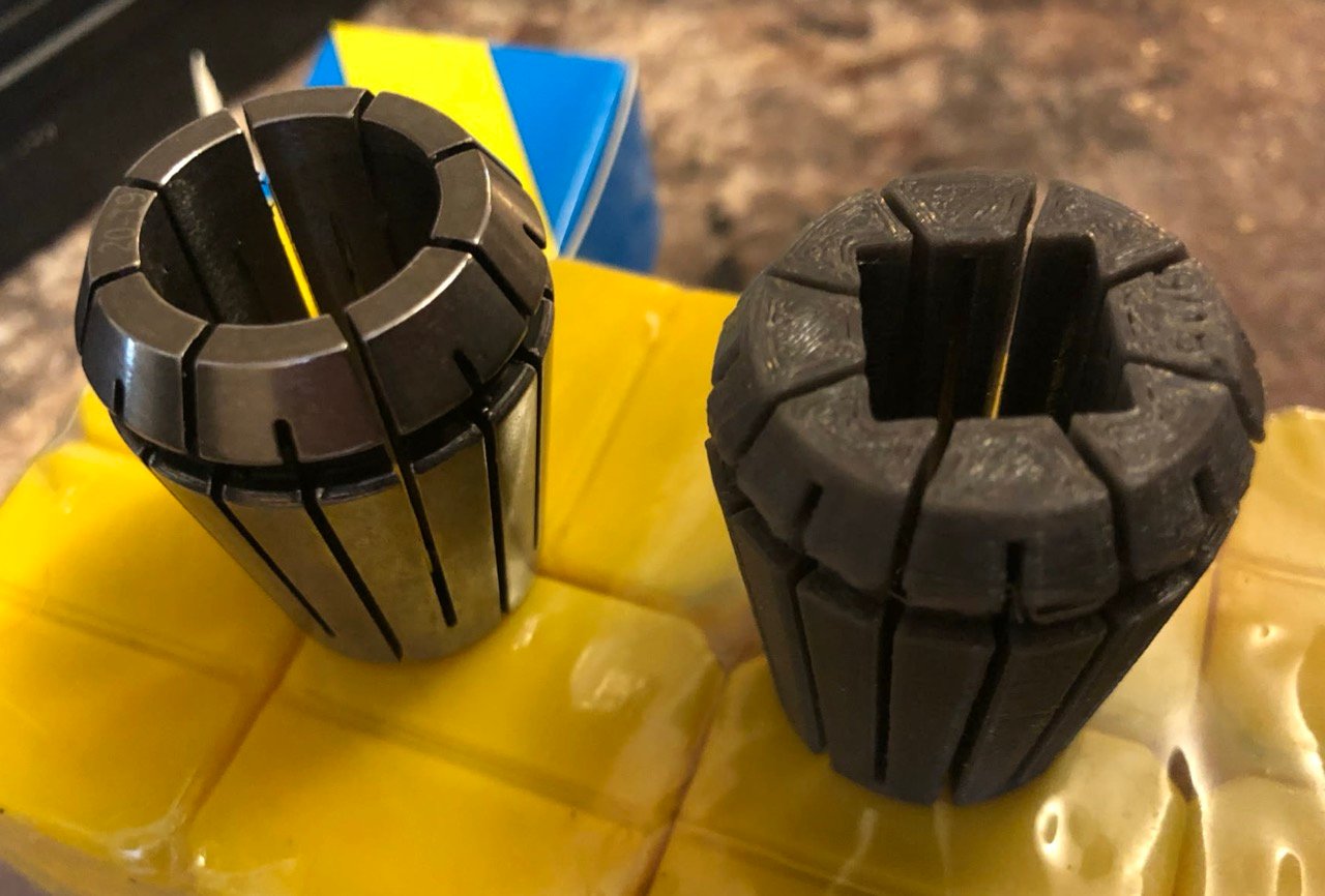

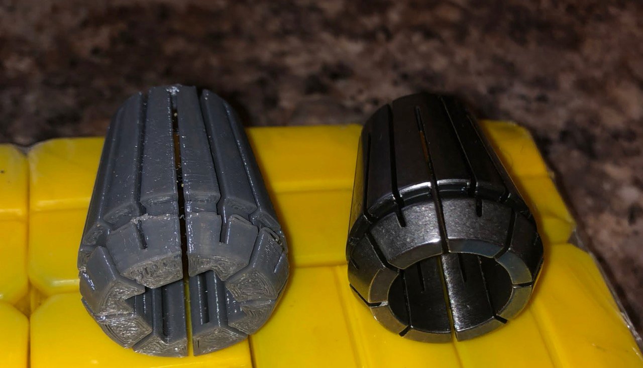

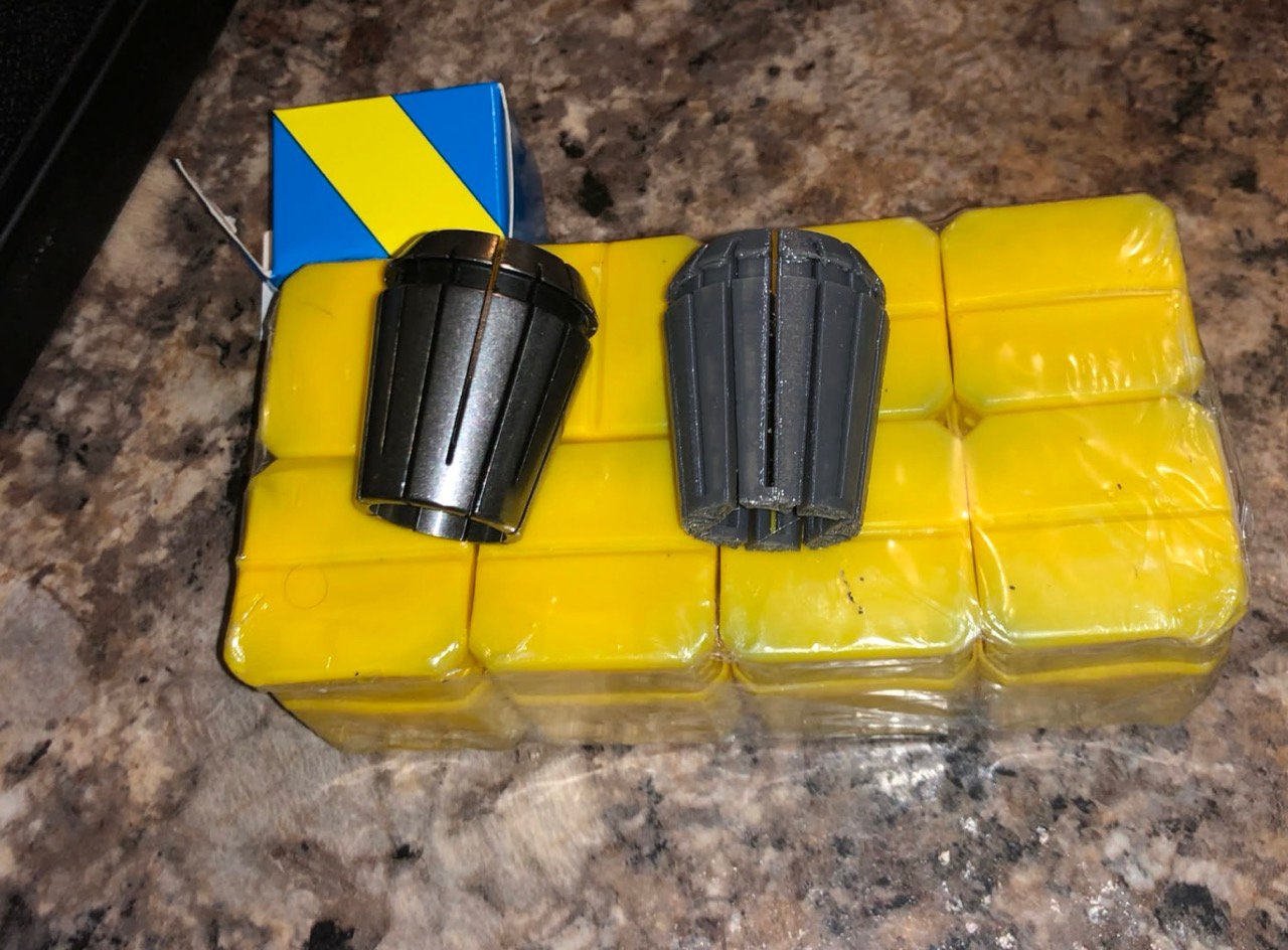

So, I downloaded a couple STL files for an ER32 collet. I decided to do a 15-16mm since that is a close equivalent to a 5/8" which is what all of my mandrels from Rick Herrell (@rherrell) are and that would give me something true to check for runout with.
The first one I printed was kind of a bust because I didn't notice that the inner diameter of the collet wasn't 16mm all the way through. I have no idea why someone would design it that way, but oh well...
The second one was better, 16mm all the way through. One thing I find interesting is that both designs are 6 lobes and all of my ER32 and ER40 collets are 8 lobed (see photo).
Here they are left to right, steel, 16mm all the way through, and not 16mm all the way through.
They look good, are printed with PLA (just for a quick test) with 4 walls and 25% infill, which means they are almost solid PLA. Each one took about an hour to print.

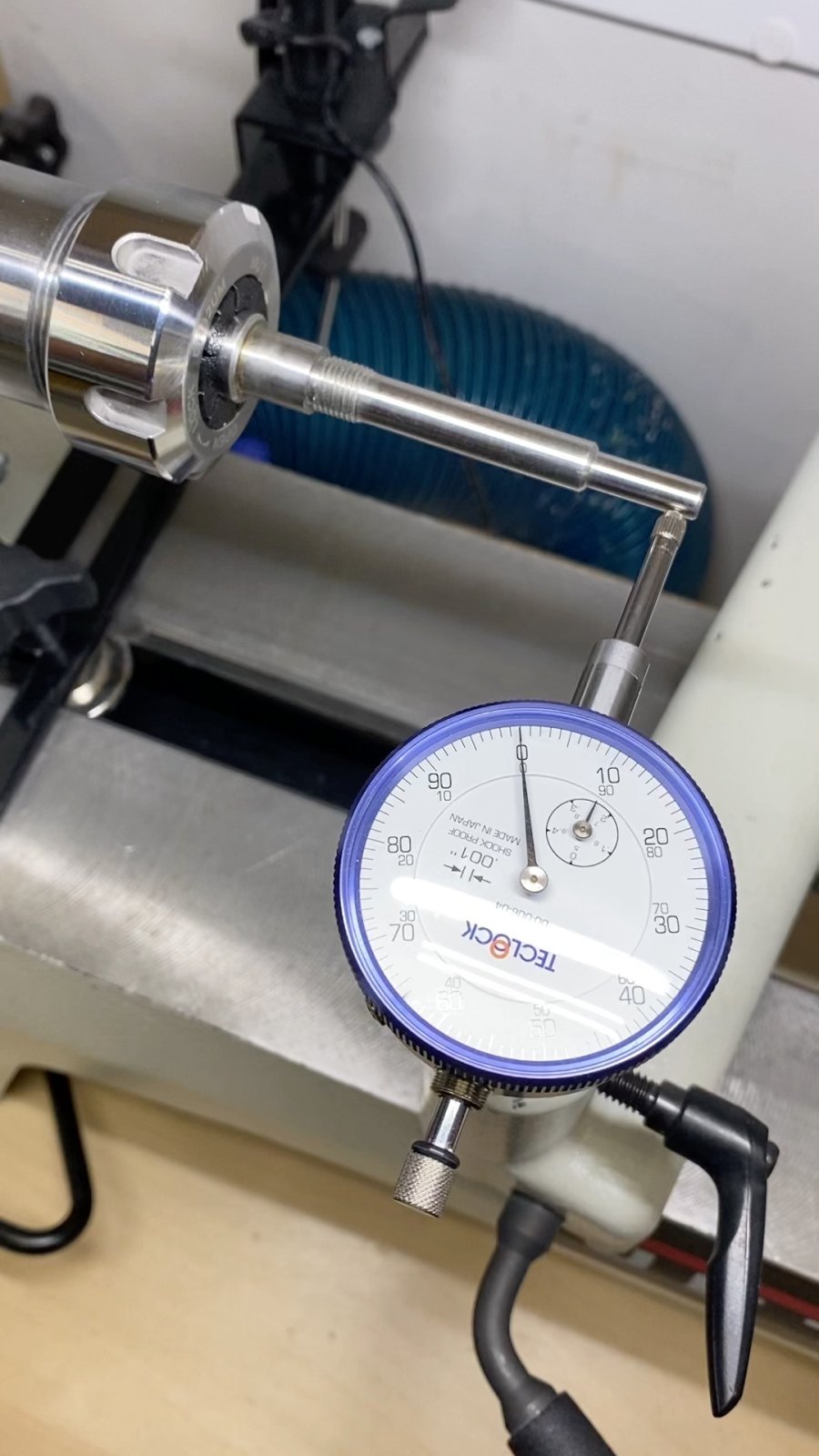

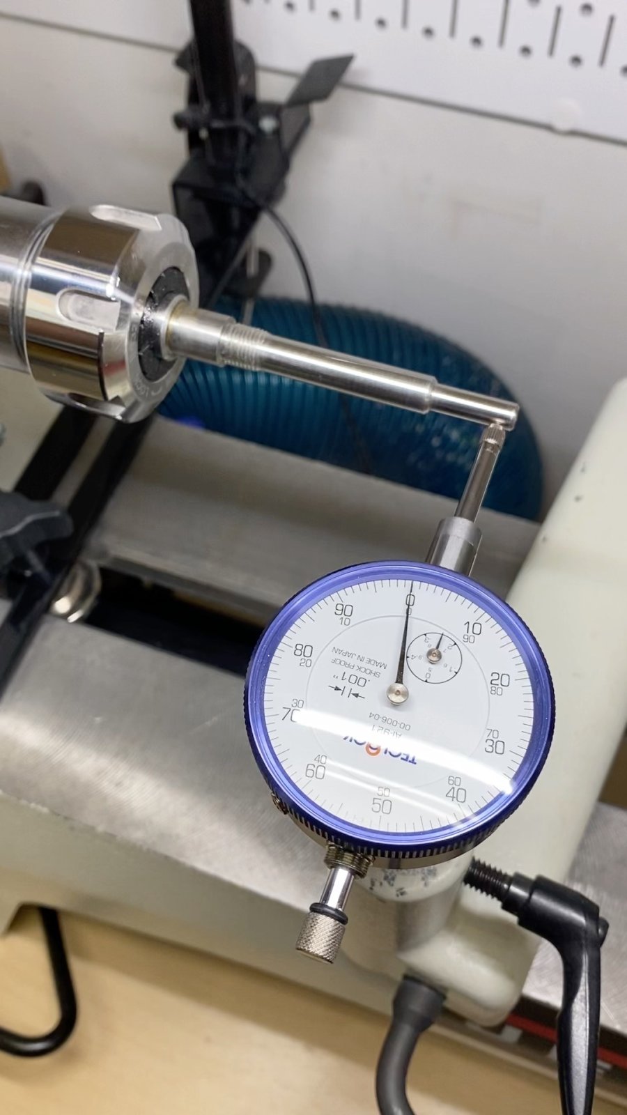

When I went to check for runout, it was just over .009".
After doing the tappity tap tap that Rick Herrell recommends to get rid of the runout, I was able to get it down to about .0015". Not bad.
My concern is that this material is not robust, and a softer rubber type material like TPU, or even TPU 95A which is much more rigid would most likely deform/flex if any force of turning, sanding, polishing was applied to it, which would result in significant runout.
