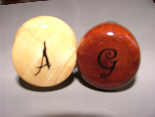

I have done the rub on transfers on bottle stoppers. Sorry about the blurry picture but you get the idea. It's been a couple years but I believe I put some lacquer on first then the transfer and then added more lacquer for protection.

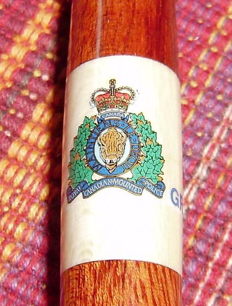

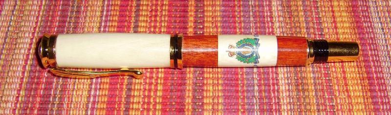

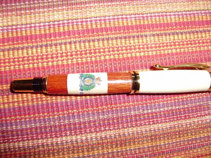

Here the Results
Thanks to all for the help here is the result. Holly wood and Bloodwood. With RCMP badge. Royal Canadian Mounted Police.
This was done with wet slide decal.
