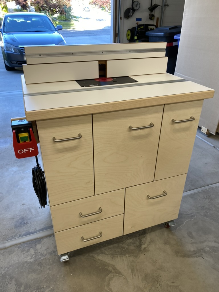

When I bought my first heavy duty router I went for the Triton 3.25 HP model. One deciding factor for me was the built in rack and pinion height adjustment system they use. Not only can the height be set with a knob on the side, it can also be set by using a crank handle from the bottom (included). I already had the Kreg router table and fence so all I had to do was to drill a hole in the drop in top for the crank handle to fit through and viola - instant router lift without needing to mess with separate router lift hardware.
I did add a separate switch so I don't have to power it on and off by reaching under the table.

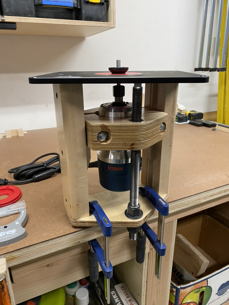

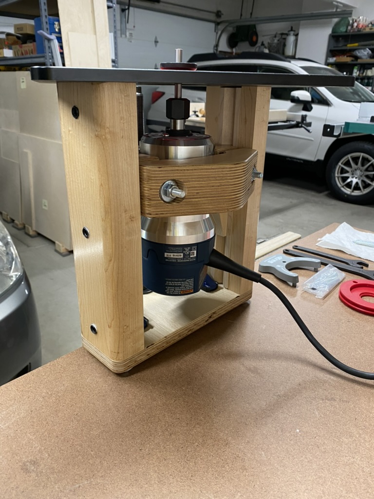

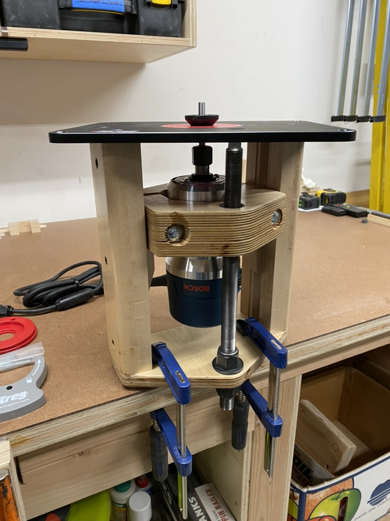

I built my own lift. It is based on a decades old design from Woodsmith. Steve Ramsey of Woodworking for Mere Mortals did a YouTube video on his build 13 years ago. One of the important details is getting the 16TPI rod from McMaster-Carr so that one rotation of the adjustment is exactly 1/16" change in height.
Here is my build...
F8F22960-1066-4245-B571-9F3591DE1419_1_105_c.jpeg 658A2B2E-6E97-49CB-9276-B6A3522B8509_1_105_c.jpeg 802FB01E-D20C-4E59-A626-A5ECB0C21ACD_1_105_c.jpeg E72BFF6A-2D07-47A9-97DF-3BF175166AC6_1_105_c.jpeg

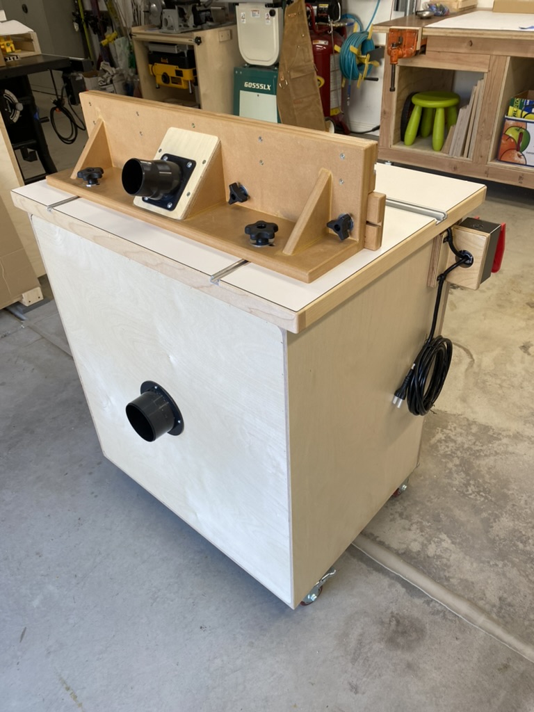

Count me in as another Jessem Master-Lift user. Mine is built into a sliding top I made from scratch which slides in and out of my principal workstation - which also holds a number of other tools I use. I also came upon a clearance priced enclosure box for the router which has a dust port in it, so the router hangs from the Jessem and is fully surrounded by the steel enclosure. Adding dust collection on the top built into the shop made guides significantly reduced the dust problems with the router, but it still makes a mess. 5 stars for the Jessem.
Below the router, I built a slide out set of trays that hold all my router bits in the Rockler router bit storage inserts drilled into the sliding tray. An external power switch completes the setup. My first router in it was a large Triton 3 hp model, later replaced by a larger Porter Cable. No matter which router you choose be sure it supports different sized collets so you can use appropriately sized bits with strong shanks. One hint I got from someplace was to not let the bit bottom out in the router collet - I put a small rubber donut into the router shaft hole that stays there giving the bits some expansion room as they heat in use.
This whole assembly replaced an old hand made router table made from plans by Norm Abrahms years ago - but my new downsized shop didn't have space for the freestanding table, so went with the upgraded plate in the roll-out draw. Works fine!

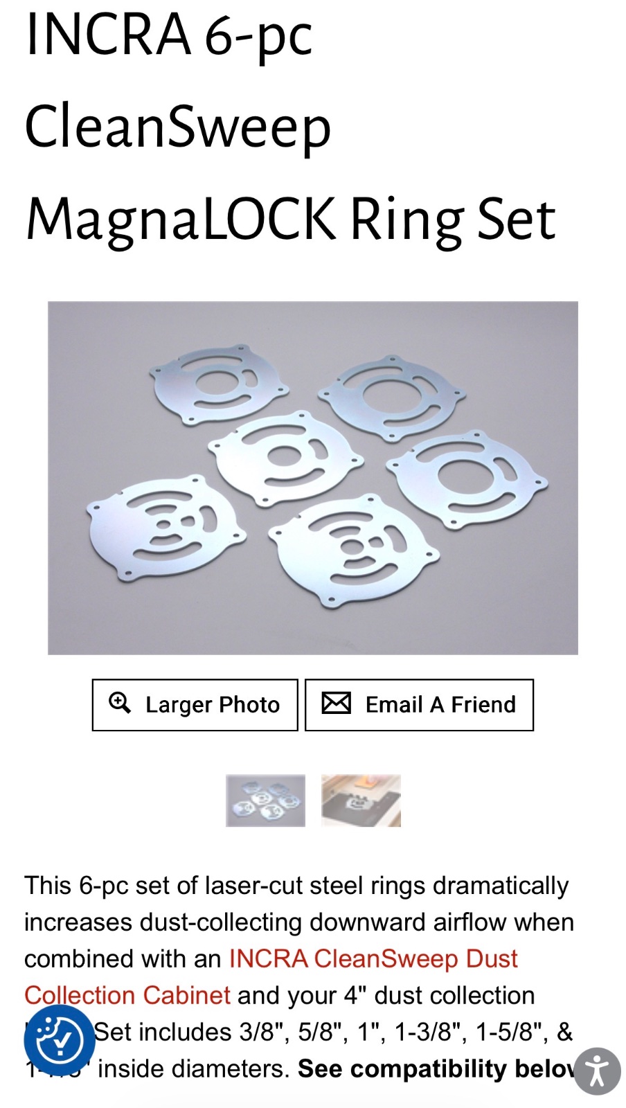

I would suggest getting these clean sweep inserts too, if you have a dust box on your table. They're a game changer.
