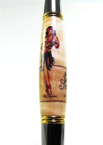

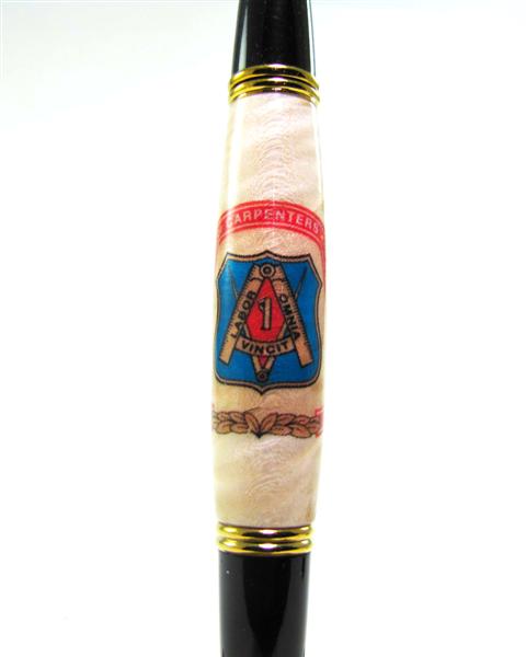

As for a pen kit ,depending upon your stickers,decal ,designs I have had alot of success with the Sierra,LeRoi,Wallstreet sized pens for adding decals without being too "busy".
