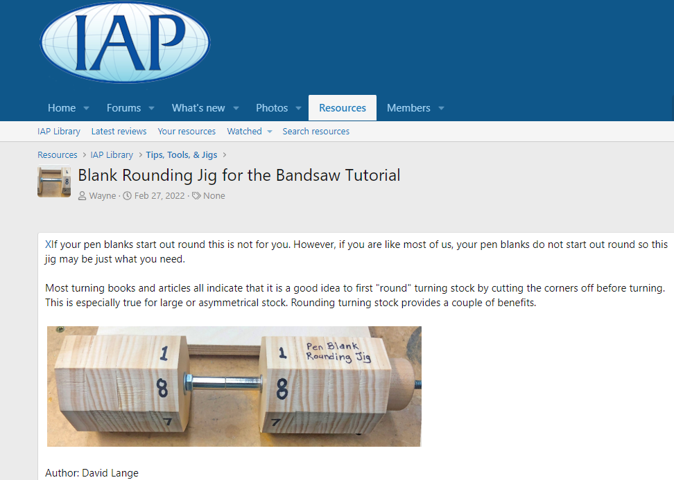

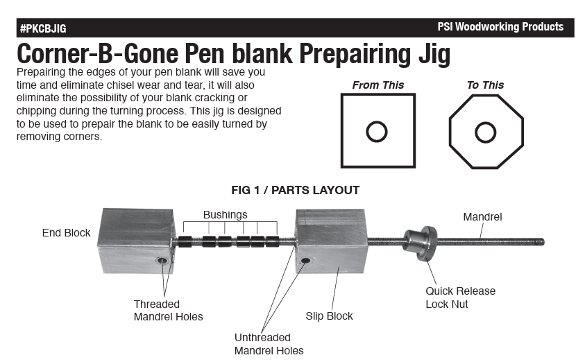

Personally, I have never liked the little "impact" forces that an out-of-round blank puts on my cutters so I almost always cut the sharp corners off of my blanks before I put them on the lathe. I started out using my belt sander to get them kind of round, but a few years ago I started using a jig that I came up with that works along with my bandsaw fence. It is based on one that PSI used to sell called the Corner-B-Gone Pen blank Preparing Jig. I made mine out of wood instead of aluminum though. I used a 1/4-20 threaded rod for the mandrel. A 3D printed version would have been much easier to make, but I just haven't made the leap into 3D printing - yet that is.
Since my jig cuts in reference to the center line of the tubes and bushings instead of just one side of the blank, it even helps compensate when the blanks are not drilled straight through from end to end or when the blanks are rectangular rather than square or if they have an irregular shape such as a piece of FOG wood or a deer antler. (I also use it sometimes to remove some of the bulk of the blank if I have one that is considerably larger than the pen I am making). - Dave
