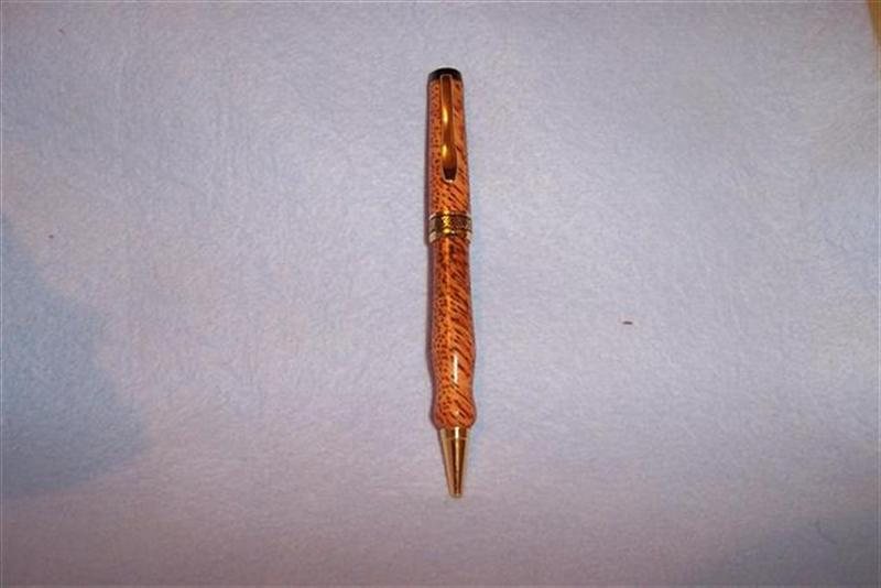

Try turning some blanks cut cross wise rather than with the grain and you will eventually find out why it is sometimes prudent to knock off the corners.
this is a piece of red palm

Originally posted by cteaglesc
<br />
Many of the woods I turn are cross-cut and unstabilized burls and have never had a problem. Key to success is sharp tools and correct angle of inception to achieve maximum cutting efficiency.
<br />
That must be trick photography, palm refuses to turn. Can't be done. [:p] I bought some and it just sneers at me on the lathe while it grinds down my tools. Five seconds, tops, before a tool needs resharpening. I gave away at a club drawing a large hunk. Still have a 2"X2" stick here that my descendants will probably throw away some day in the future. Harder than granite.
Good creative photography, actually looks like a very nice pen....for a pen that can't be turned. [:)]
