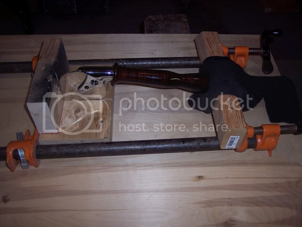

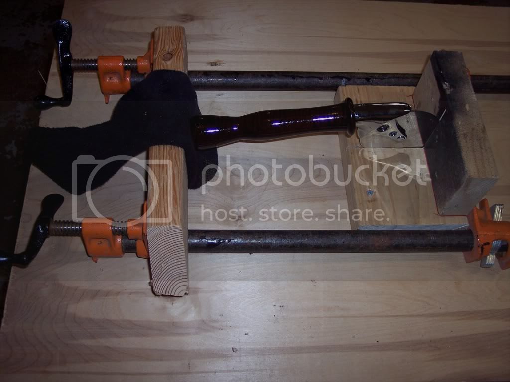

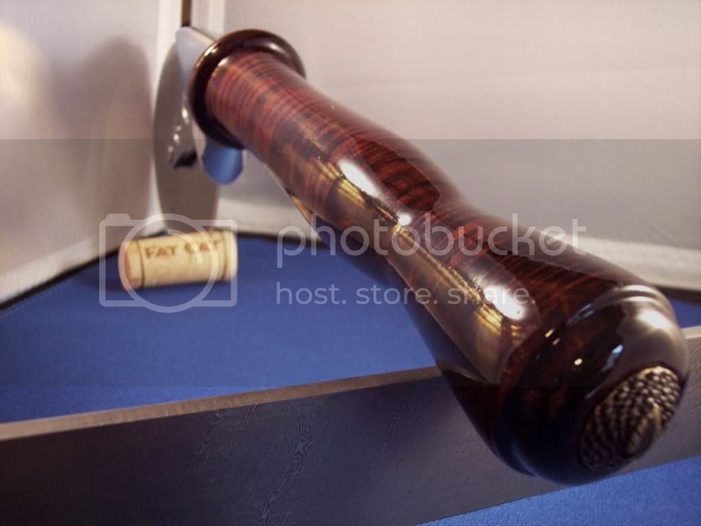

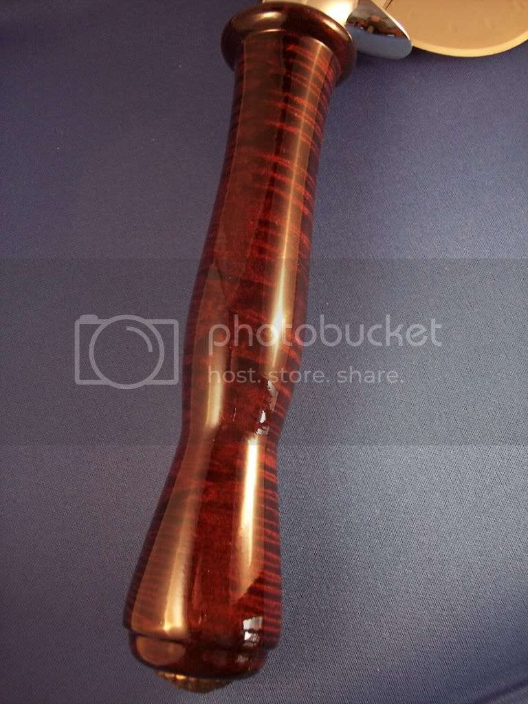

Acid maple and lots of time....... not exactly the way its supposed to be done, but I stripped the threaded sleeve then completely snapped the stem off with epoxy everywhere.
I then drilled and tapped a hole into the cutter piece and threaded some 3/8ths drill rod into that and decided to seat the collar directly into the handle.
Finally just epoxied everything up and so we'll see how it ends up. Of course muddied up my finish a bit in the process, but thats how it goes the first time.
I will get some better pics when its finished up..
:biggrin:

I like it. I'm not absolutly sure what I am looking at, Pizza cutter, but it looks way cool. When it comes out of the clamps, show it again. please.

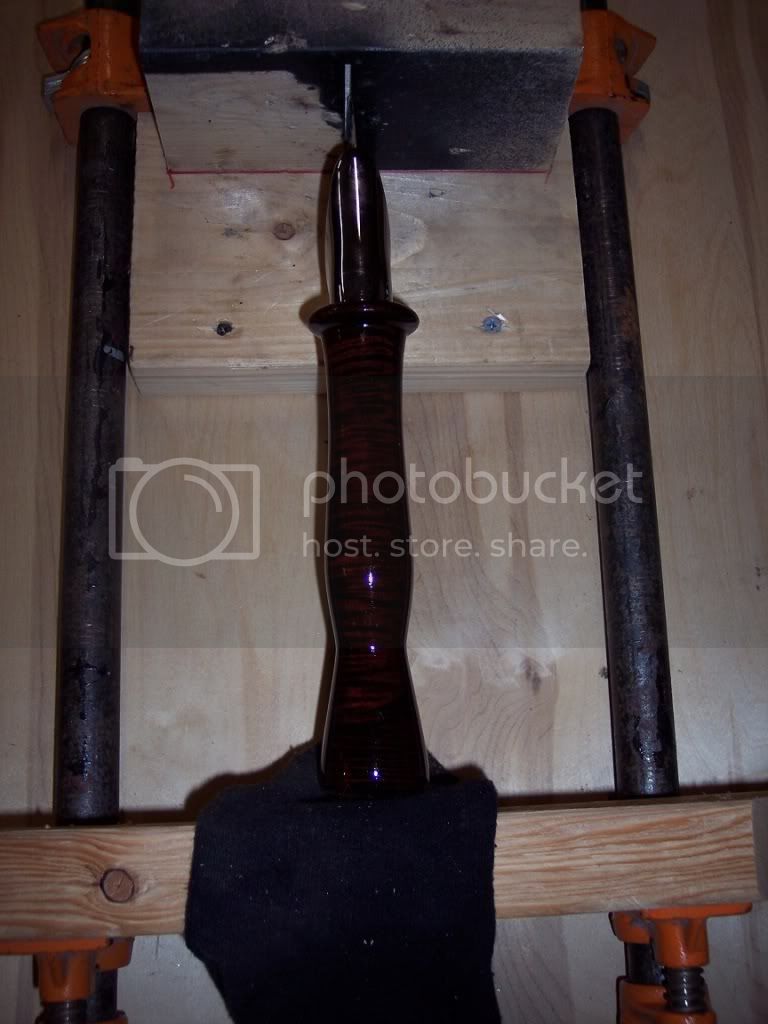

Yep thats a pizza cutter........being glued up in my home made jig. Its a monster.....I will post finished pics when done. Larry
