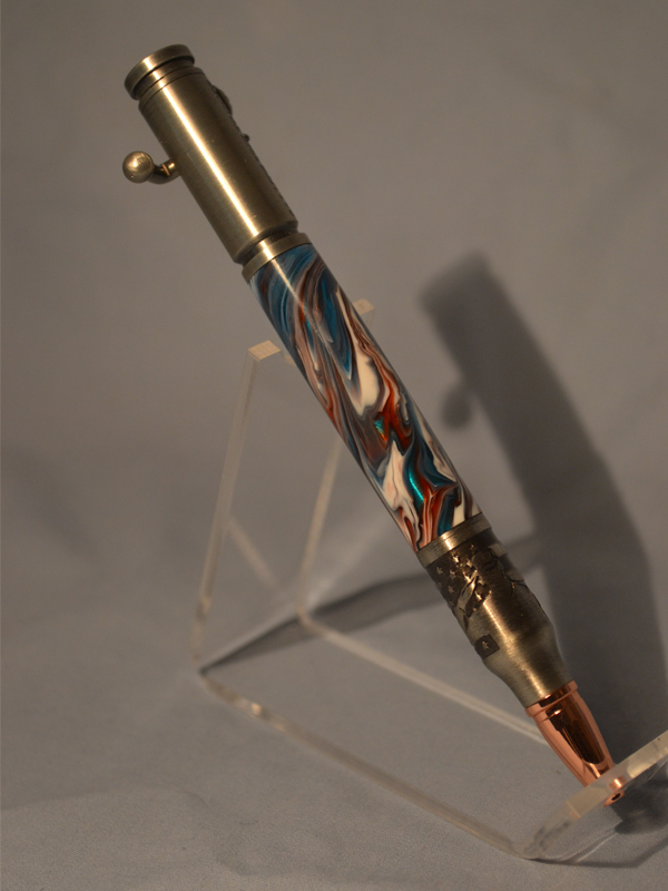

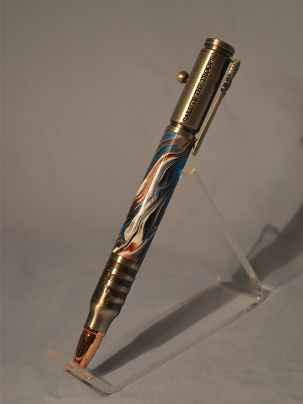

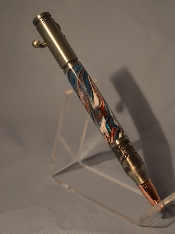

Pen 3
It is a Salute the Troops Bolt Action pen kit dressed in one of Jonathon Brooks' blanks (Brooks803). I colored the tube with blue and red sharpie to give the blank a shiny look underneath the resin.

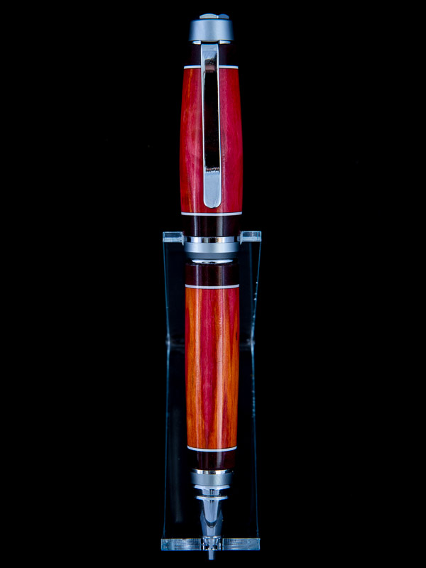

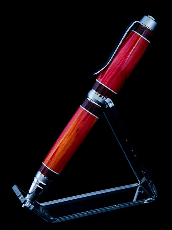

Pen 6
Kit is a Satin Chrome & Chrome Cigar from Exotic Blanks.
Segments are Purple Heart on the ends, separated by White PVCA, and then
Maple for the bulk of the cap and body. Maple came from the back yard,
Purple Heart from Woodcraft, and the PVCA courtesy of an old Credit
Card. The Maple was first soaked in orange Cactus Juice, then cured
and then put in red Cactus Juice under vacuum for a few hours.

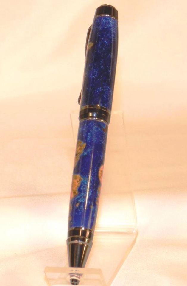

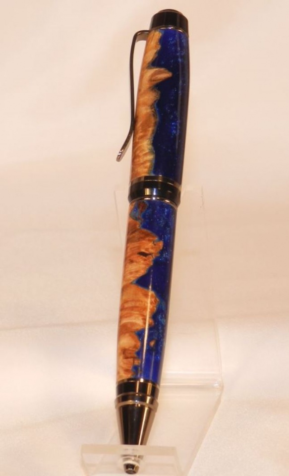

Pen 9
My entry is a Maple burl and Alumilite blank cast by me on a gun metal cigar kit. I used maple burl "worthless wood" from Rocky, which I stabilized with Cactus Juice. I then cast it with Alumilite clear, alumilite dye and pearl-ex powder at 50 pounds pressure. I cut the corners off the blank with a band saw before I turn them on the lathe so I don't tear out a chunk of wood while roughing it out. I use a carbide tipped "magic Skew" on these types of blanks to shape it. Before I do any sanding I coat the body with thin CA in case there are any tiny pores or gaps between the resin and wood. I then sand from 400 to 800 grit and bring it close to size. Sometimes I need to apply a few more thin coats of CA to the proper size and finish. Once I'm happy with the coat I sand to 800 then buff on beall buffing wheels to a high shine.

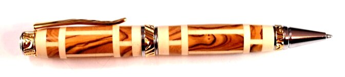

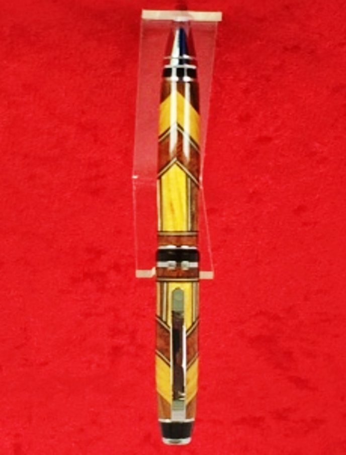

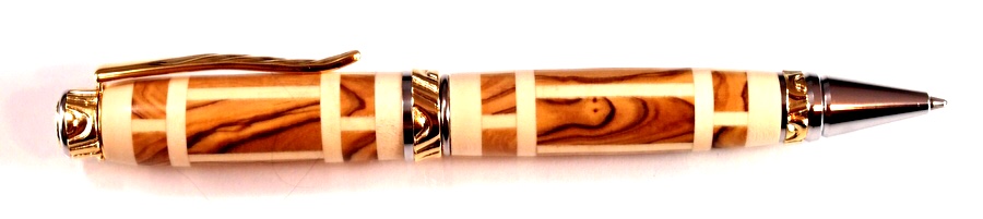

Pen 11
This is my entry for the Ballpoint pen contest. It is a segmented Cigar pen made out of Osage Orange, Red Heart, Cocobolo, Spectraply, Ebony and Maple. After glue up I use a see through ruler to line up the pattern, then turn between centers to 5/8 diameter. I drilled the blanks on the lathe using a Nova Pen Plus chuck. I used epoxy to glue the tubes in then I used TBC bushings and turned between centers. Sanding, 10 coats of CA finish, micro mesh to 12000, and plastic polish, to complete.

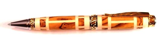

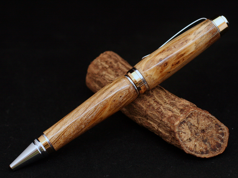

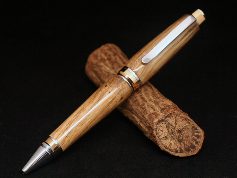

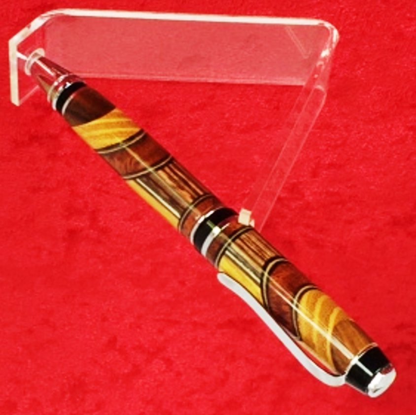

Pen 12
Chrome/Gold Cigar Kit
Material: Stabilized Vine
Shaped with: Carbide tools
Dry Sanded: 120, 220 and 320
15 coats of CA
Wet sanded: 400, 600, 800 the Micro Mesh 1500 through 12K

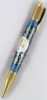

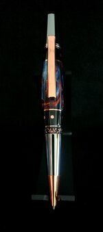

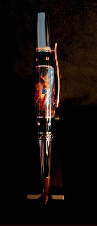

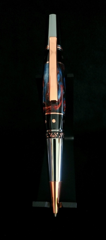

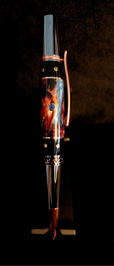

Pen 14
The blank on this Black Ti and Copper Aero Twist is an Exotic Blank's "Electric Nebula Alumilite". The twelve copper pins were made from solid core wire and glued into the blank with thin CA glue after the holes were carefully located using the lathe's indexing wheel and drilled to the surface of the brass tube using the depth stop on my drill press. The four larger pins were made from 3/32" copper tubing filled with epoxy mixed with "True Blue" and "Macro Pearl" Pearl Ex powder pigments. The copper inlay was made from a 0.25" thick copper sheet. The blank with pins and inlay was turned with a carbide cutter and then finished using Micromesh pads to 12000 grit and polished with Meguiar's Plastx.

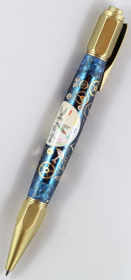

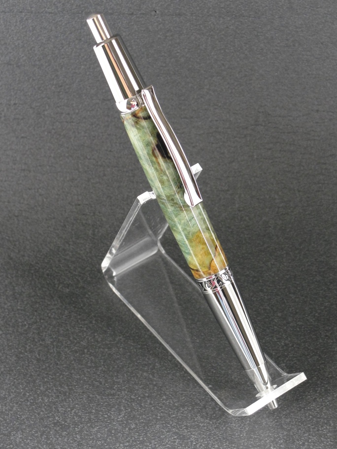

Pen 15
The kit is a PSI Vertex Click in Antique Brass. The blank, in its "rough" form, was purchased from an IAP member.
The blank was originally designed to fit a Sierra twist. I modified the blank to fit the Vertex kit by shimming in a 3/8" brass tube and also by adding the blue acrylic end caps of suitable to make up the required length.

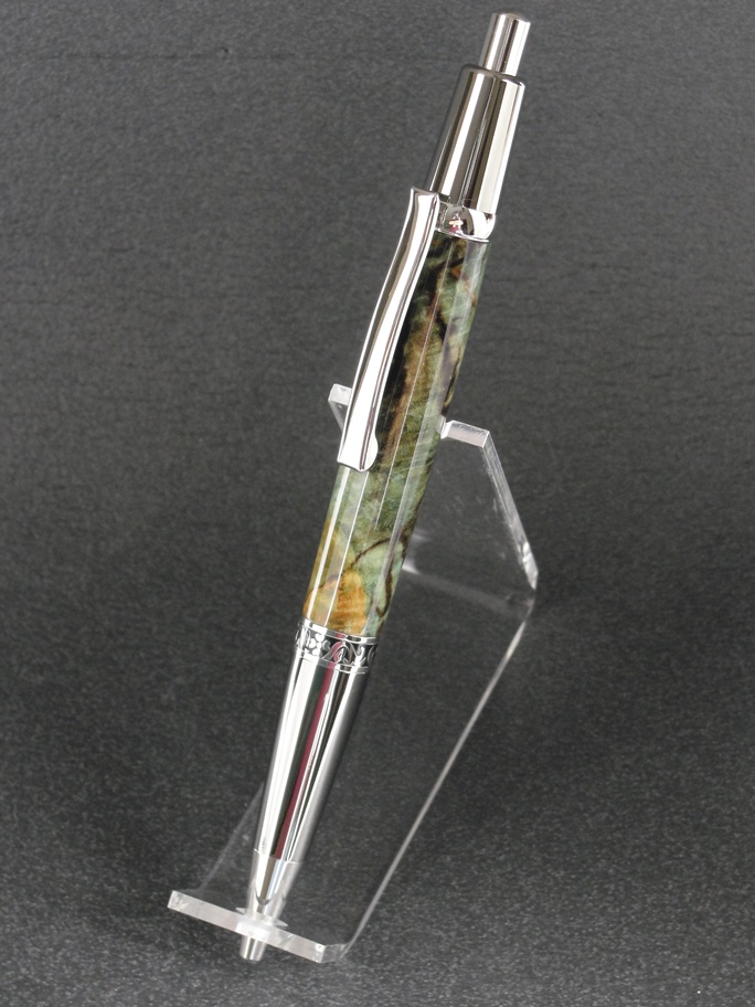

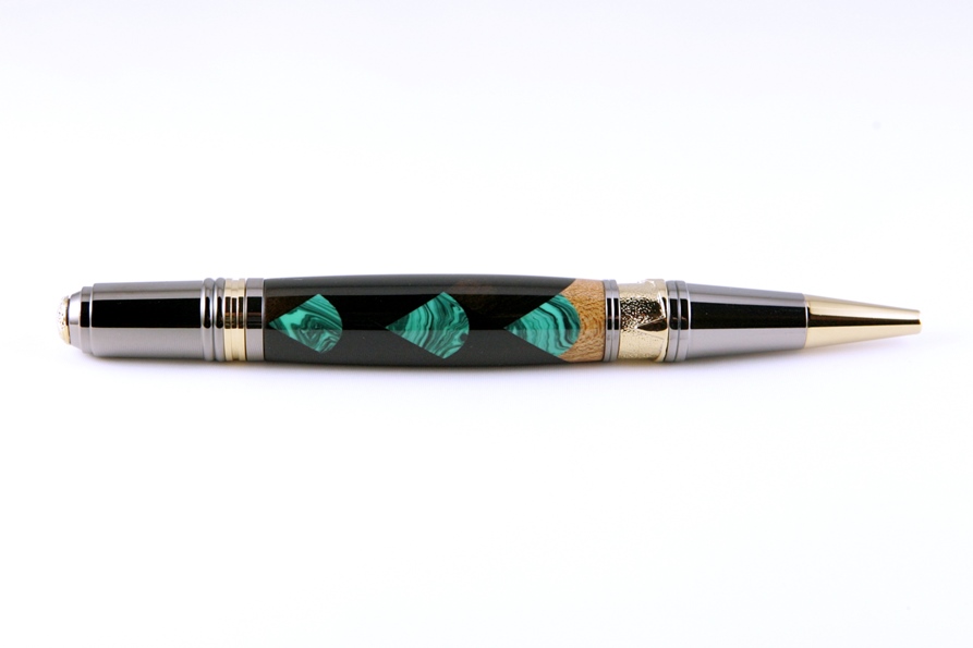

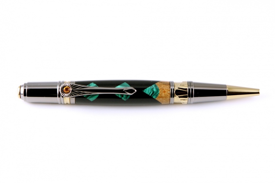

Pen 18
This pen is made of malachite TruStone, ebony, and maple.
The kit used is David Broadwell's Art Deco (Gold TN/Black TN plating).

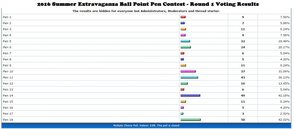

Congratulations Winners!!

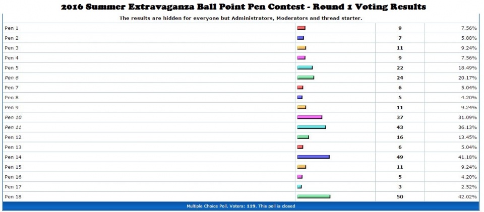

Here are the results of round 1 of voting.
...and your winners are
In 3rd place and the winner of a BOB from IAP member Ed Cypher is Dave Sutton - SuperDave
In 2nd place and the winner of an Abalone blank from IAP member brownsfan2 is Seth Roland - RolandRanch
and in 1st place and the winner of resin blanks from IAP member MRBurls is Steve Axelrod - Steveaxelrod
Congratulations! I will be in touch to make arrangements for your winnings.
Also, everyone please take a moment to thank the very generous members of the IAP who have donated the prizes for this years Summer Extravaganza. Without them, none of this would be possible.
Good night~
Bob
