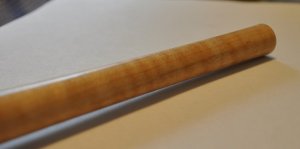

Ok 4 coats only this is what I got after turning again and starting over!
Dont spare anything :biggrin:

It looks pretty good, but the pictures are pretty small, so it's hard to tell. But based on the glare line in the lower picture, I don't see any waves, so I think you have it pretty smooth, and I don't see any imperfections. Of course, you probably only showed us the good side.:wink:
