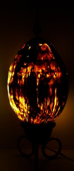

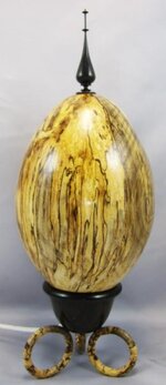

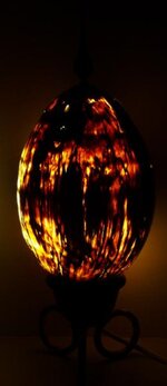

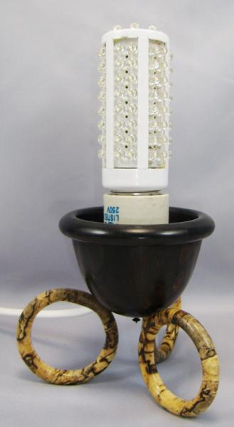

Here's my latest turning, apart from pens that is :rolleyes:
It is made from Spalted Bonewood and African Ebony. The egg is hollowed so that the final shell was only 0.047" to 0.016" thick. I used heaps of thin CA to help stabilizes as I went, but unfortunately the softness of the rotten timber meant it still moved on me in the chuck slightly. I ended up filling the inside with a mix of PVA and coffee grinds where it was 0.016" as the light just shined through like a torch.
It won 1st prize at the local show in the "hollow forms" category :banana:
Cheers
