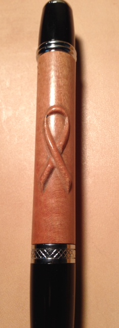

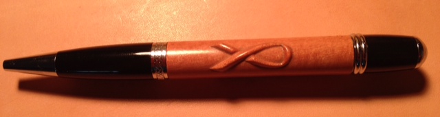

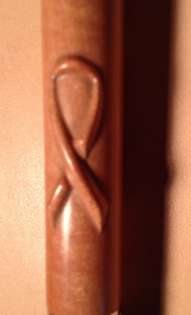

this is in pink ivory wood with a raised support ribbon.
It is only raised about 0.05" above the body but it gives a very nice look and tactile feel.

Eye popping!
Well done Nick! I haven't seen this type of work done on such a small scale as a pen tube. You're definitely on to something!

well I do have a 45 watt ULS laser, but this was done on a Shark CNC with the 4th axis rotary attachment. Rotary turning is a little more difficult than traditional CNC work, because you have to convert your thinking to Radius, Diameters and Degrees. The ASPIRE software has a bit of a learning curve (and is expensive) since you have to learn to do 3d modeling. Fortunately, the company has lots of training videos on their website.
I have tried to do stuff like this on the laser, but they don't really do 3d. they use a graduated grey scale to simulate the art, but they come out much too 'bumpy' and the height is not always consistent. cheers!
