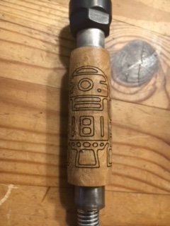

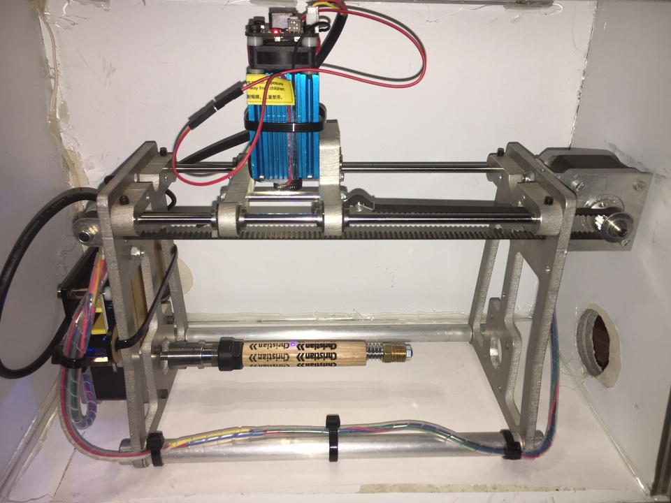

Well finally got my homebrew rotary laser running.
2.5w laser
2x NEMA 17
Eleksmaker MANA SE
Laser GRBL software
Very happy with the results just need to make a better casing as this one resonates to the fan:mad:

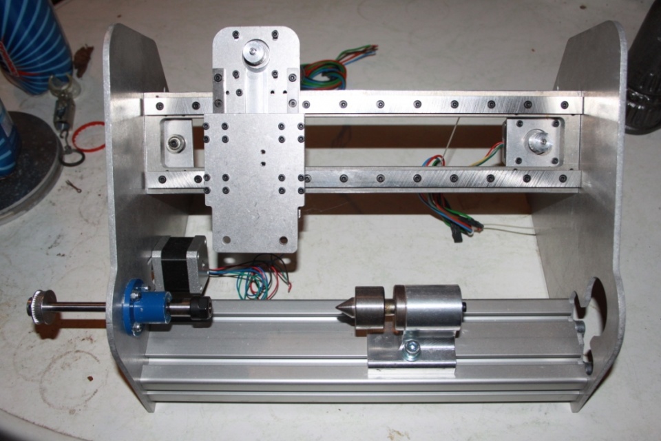

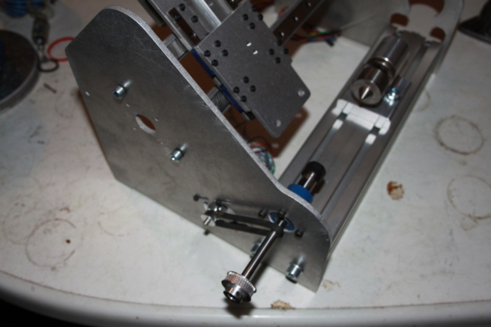

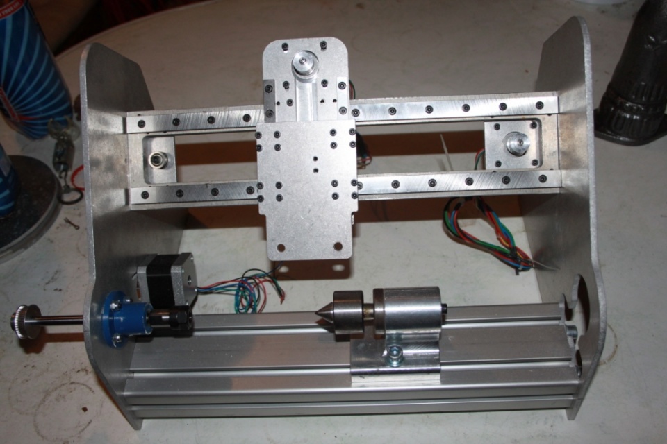

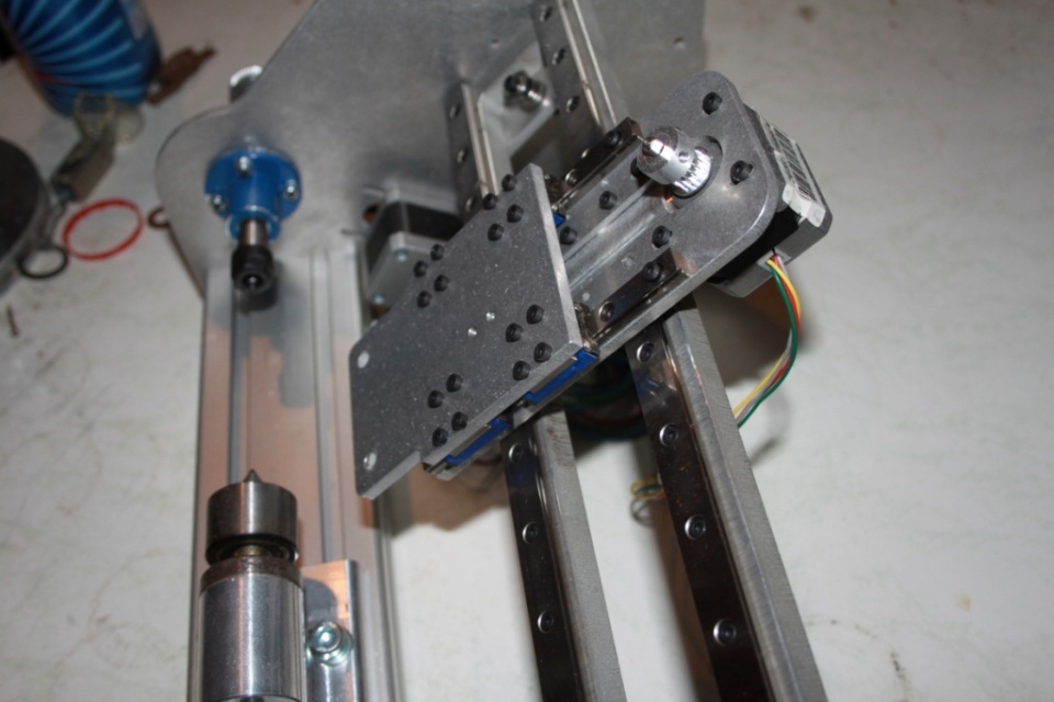

Hi Bruce,
I do have something in the pipeline in this direction.

I really like that design Andrew. Is it your own design? I like the choice of using linear rails. You should sell them as kits or complete machines :biggrin:
I guess the little tailstock is spring loaded?
Having the Z axis at an angle is cool too. Compact but out of the way at the same time. :smile:
Really cool !! Looking forward to seeing the completed project.:wink:
I might even have to wangle a factory visit to Ratingen and steal it from you!!:biggrin:
That is very nice. I like the z axis mounted on y. Do u have an idea on how you will control it.

Thanks Skip,
The only spring loading is my thumb when I press the tailstock in position and tighten the screws, but this should be more than enough.

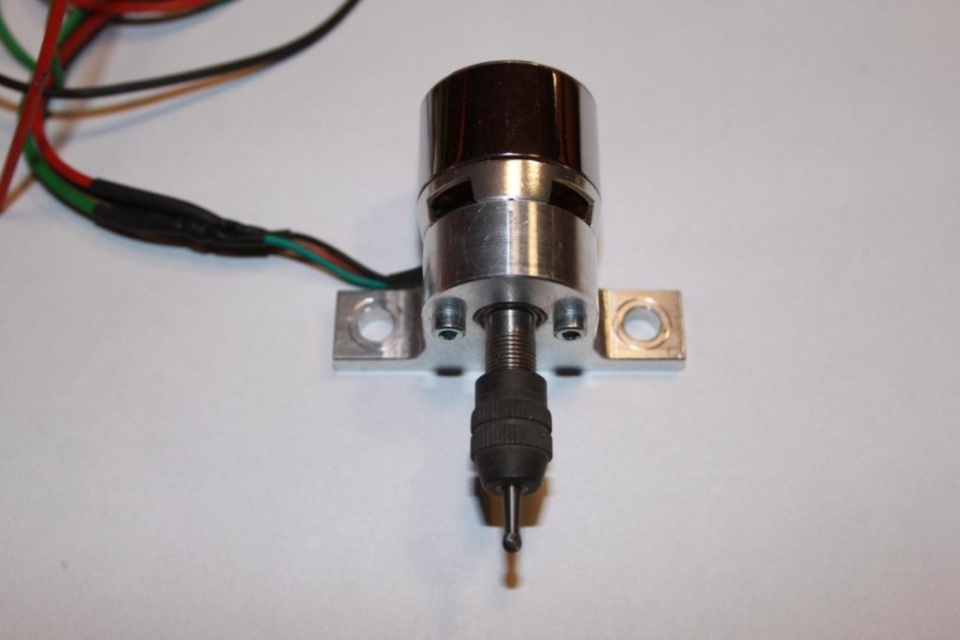

Here`s a pic of the spindle, made from a brushless motor.

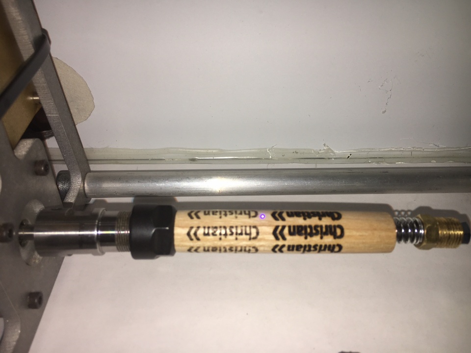

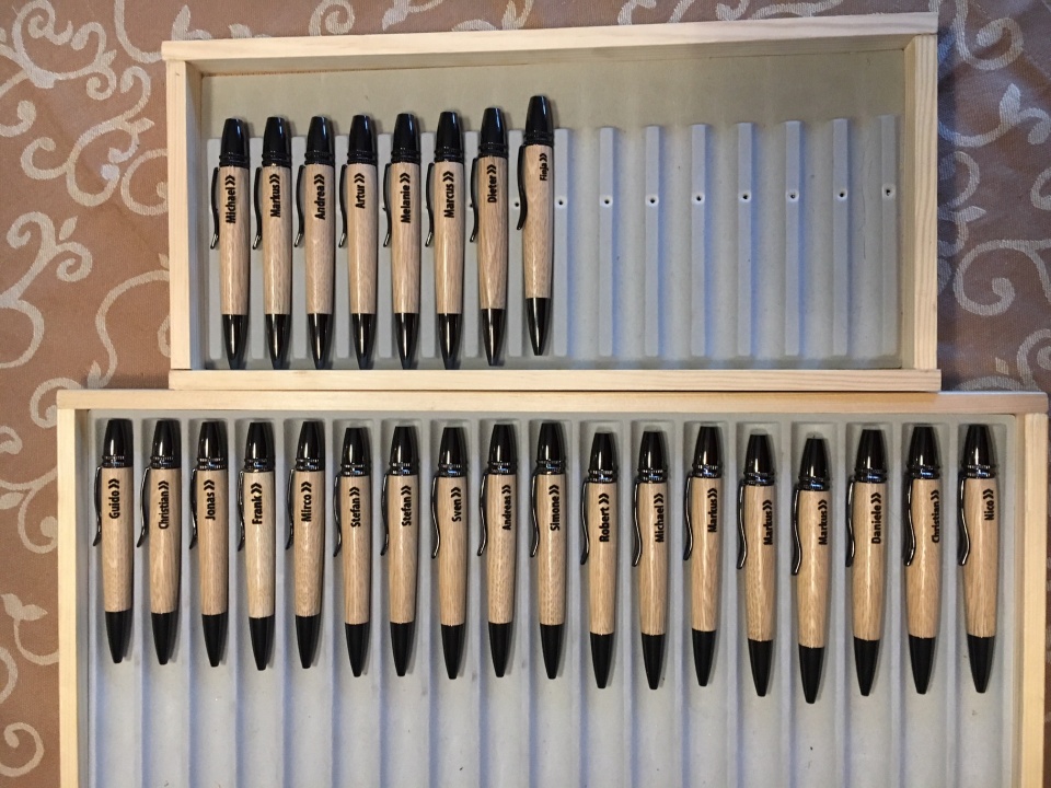

And the first order is engraved and ready to send.
26 Polaris with Oak. Engraved with names and Company Logo.
I was surprised how easy it was using Laser GRBL. a couple of tests on dowel and then go. About 45 min for all including setting up.
I think my NEJE is going to retire
