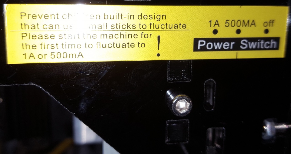

I finally got around to trying the NEJE 1500mw last weekend. I had some trouble at first, the machine seemed to be dead.
Turns out there is a power switch on the back that was turned off. It is a three position switch with a setting for Off, 500ma, and 1a. Once I moved it to the middle position, the machine came to life.
Not sure how I missed this yellow tag. Hope this saves someone else some frustration.
Jerry
