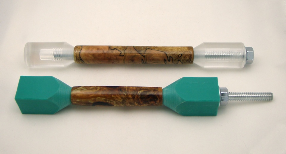

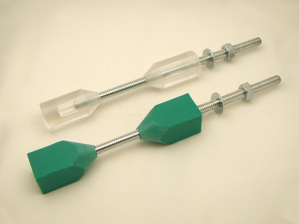

Curly
Nov 20, 2010
4,846
Saskatoon SK., Canada.
Mike
At one time Marla was having barrels engraved and the engraver had a rotary attachment. It could hold the pen barrel but because of its slight taper and curvature, it would slip while being engraved. I made a couple holders for the guy to use. You could do the same and be able to work with your preferred engraver.
The tool can be sized to the optimum length and diameter for his rotary mechanism. One cone end isn't threaded all the way through and the all thread is screwed in until it binds. The other cone end is through drilled to slide over the thread, allowing it to be tightened with the nut, finger tight. You can make it of any material you have on hand.
The green one was for a single line of engraving, holding the blank parallel and evenly to the lasers line of travel.
