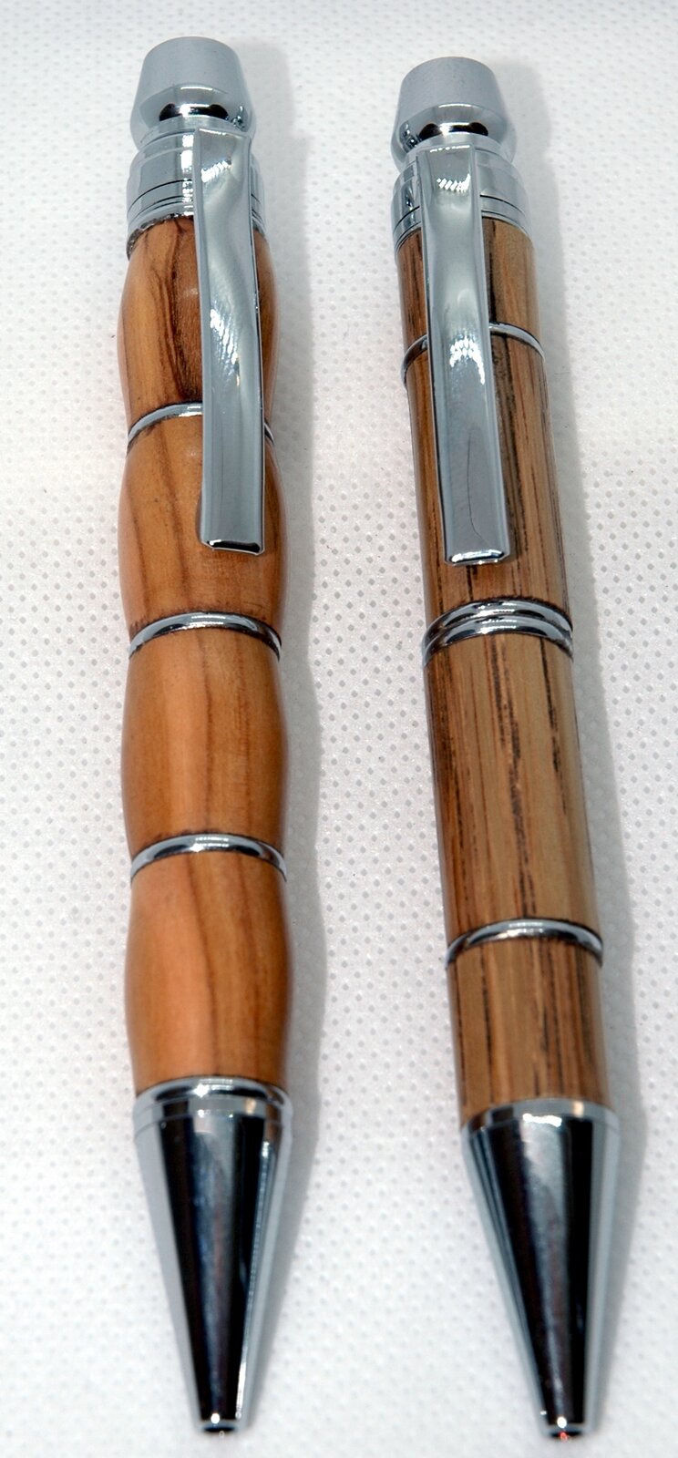

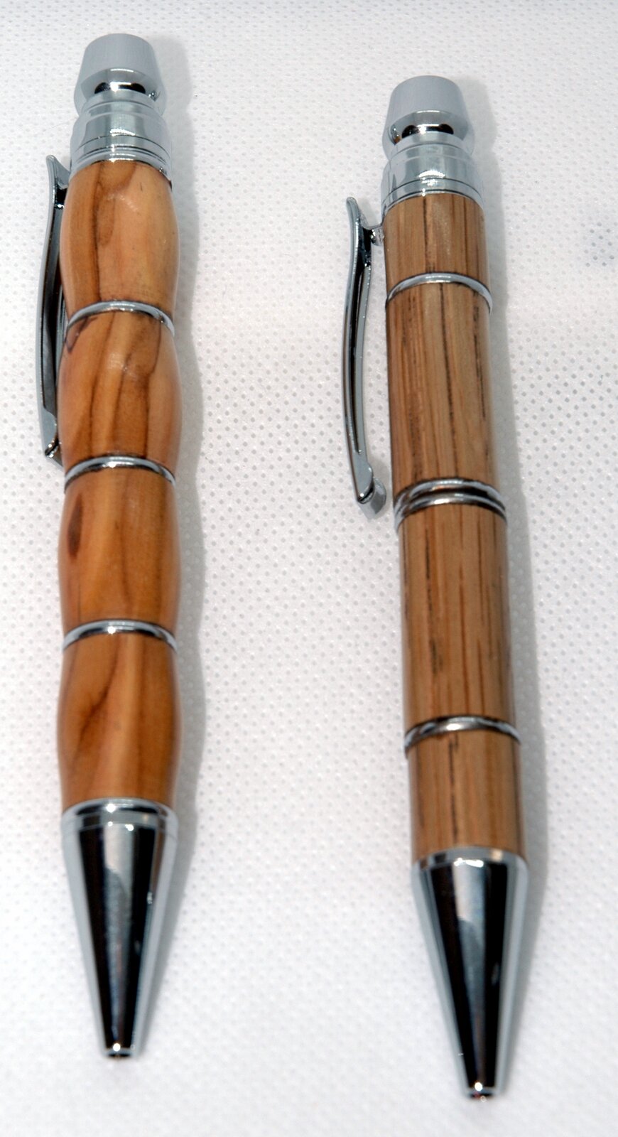

Made another Rossetti Pen today using Oak and repositioning the rings. I have photographed it along side the one from yesterday to show the versatility of the kit by repositioning the rings.
I really like this Kit because it's many kits in one. Using different wood possibly segmenting. Also the kit is supplied with 4 rings but I have ordered more to increase the number of segments. Obviously you have to stay within the tube length.
Hope you like them please comment.

They both look excellent Michael, but I favor the first one with the slight taper in the sections; just a bit more unique. However, they look like a fun kit to play with.

Thank you for your comments Mark a plus is you glue after turning and finishing so any mistakes and it's easy to start again.

BTW, for that Rosetti kit ..... is there a "coupler" piece between each pair of barrel pieces ? . . Just wondering .
Or do you rely on the central tube for the overall alignment of the sections ?
No you get one spacer slightly wider than all 4 Rings and because they slide on the tube not glued the wood can move. The recommended drill size is 9.7 mm and according to Prokraft should not be substituted. But now I have made 2 so far, For the next one I will try 9.5 mm because with 9.7 mm you get some movement which is not desirable.
I like the flexibility of the kit but think I need to play about a bit..
Hope this makes it a bit clearer Mal.
