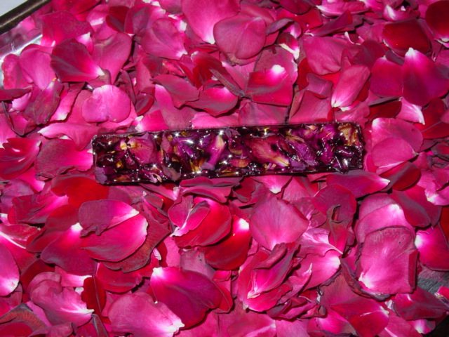

I have been picking drying and casting roses.
here is a before and after

Ouch.. Looks like a pretty color version of my 1st try at a cast pinecone.. Good luck - I hope you pull it off. The idea is very cool.

follow3
May 30, 2006
358
Hampton, VA
Hey Jay,
How did you dry the petals?
An idea to prevent the Kaboom... try epoxy to glue the tubes. It always seems to hold things together better for me.

slowly in the oven.....small disaster on the last batch, left them in the oven to still dry LOML turned oven on
burnt the whole batch......

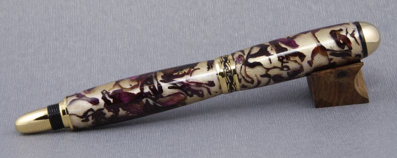

I bullied Jay into giving me one of the blanks.
I took it really slow and applied lots of CA over and over after each couple of passes of the gouge.
I did have one minor blow out but it was part of one leaf and it left 1/2 of the layer there so I filled the hole with CA and it looked great.

Gentle, you must be. Slowly, you must go.
:D
Actually, the trick I used was what I do for all "sensitive" blanks: use a sharp 1/4" parting tool to make it round and near final dimensions. Be sure to only take 1/8" - 3/16" at a time and take each cut down to within 1/8" of "final dimension". Then clean it up slowly and gently with your favorite tool. I used a small roughing gouge.

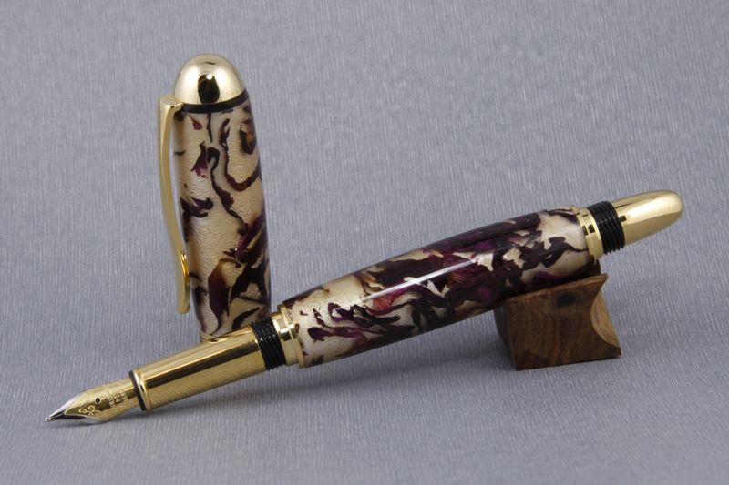

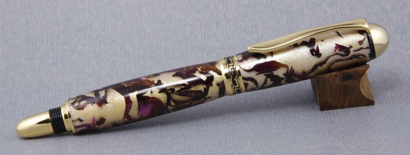

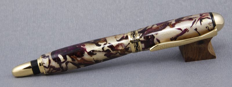

Wow, great job on the blank Jay, and the pen, Greg. <s>Did you paint the tubes on that one? Looks like the tubes rather than the hole based on what I can tell from the photos.</s> Nevermind, saw your post in SOYP. We shall see how it goes, thanks for sending me a blank Jay, hope I can do it justice.
Cheers
gketell
Local Chapter Leader
Dec 15, 2006
2,772
Pleasanton, CA, USA.
The hole was sprayed with a transparent pearlescense. When that dried both the tubes and the hole were painted with a metallic gold acrylic paint.
GK
