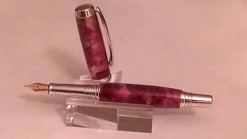

After much trial & error I think I have figured this out. Here is my Rose Petal Pen, cast in Alumilite under pressure.

when you say "cast under pressure with alumilite" , did you do a tube-on casting? or fill a mold with lots of rose petals and then cast?
The ONLY thing I can add to the comments is my mailing address! Wonderful job !!!!! Be well..................Jan
It was a many step process. The rose petals are arranged in layers around the tube. Then the prepared tube is cast under pressure.

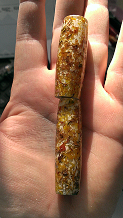

I have also made some blanks using the other method - which is to stir small blossoms into the resin and make a large block. This works well with small, loose flowers. Here is a photo of Palo Verde blossoms embedded. After drilling I reverse painted the blanks white, then glued the tubes in.
