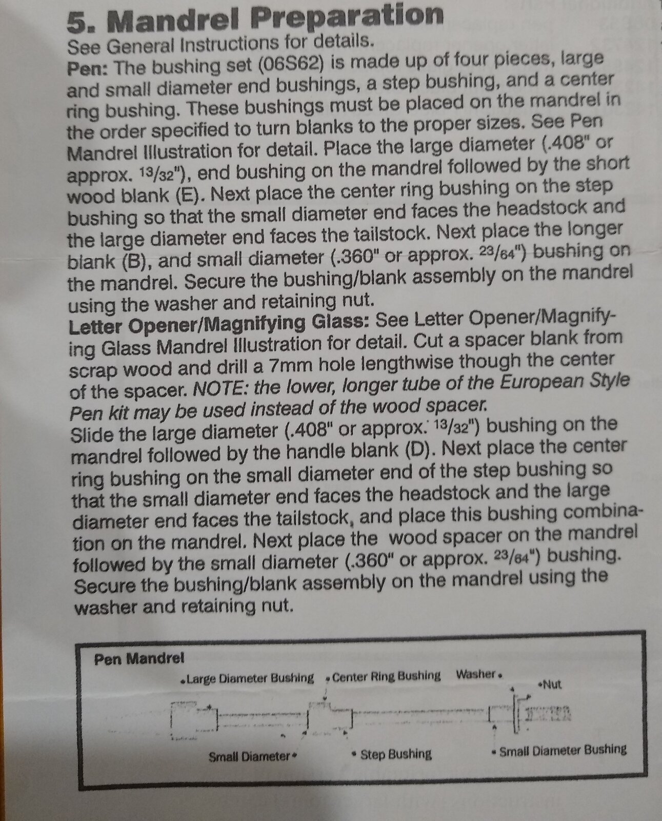

Mike,
Woodcraft (and perhaps other vendors) offer a bushing set for European styles. (See here) It has a "floating" ring over a bushing sized for the tenon, and you turn the tenon to size until the floating ring slips over the tenon.
Then you use the outer diameter of the floating ring to size for the mating surfaces of the trim ring and the barrel.
I think it works well. It lets you sneak up on the tenon sizing.

OK, now I feel stupid. That is the bushing set I have. If that is in the instructions, I didn't see it. Makes perfect sense. I will use it on the next one.

The current instructions on the Woodcraft site do not spell that out in the instructions.
Here is photo from an older set in my instructions binder.
I prefer to set up the orientation with the nib at the headstock end, so I set it up opposite of what is described.

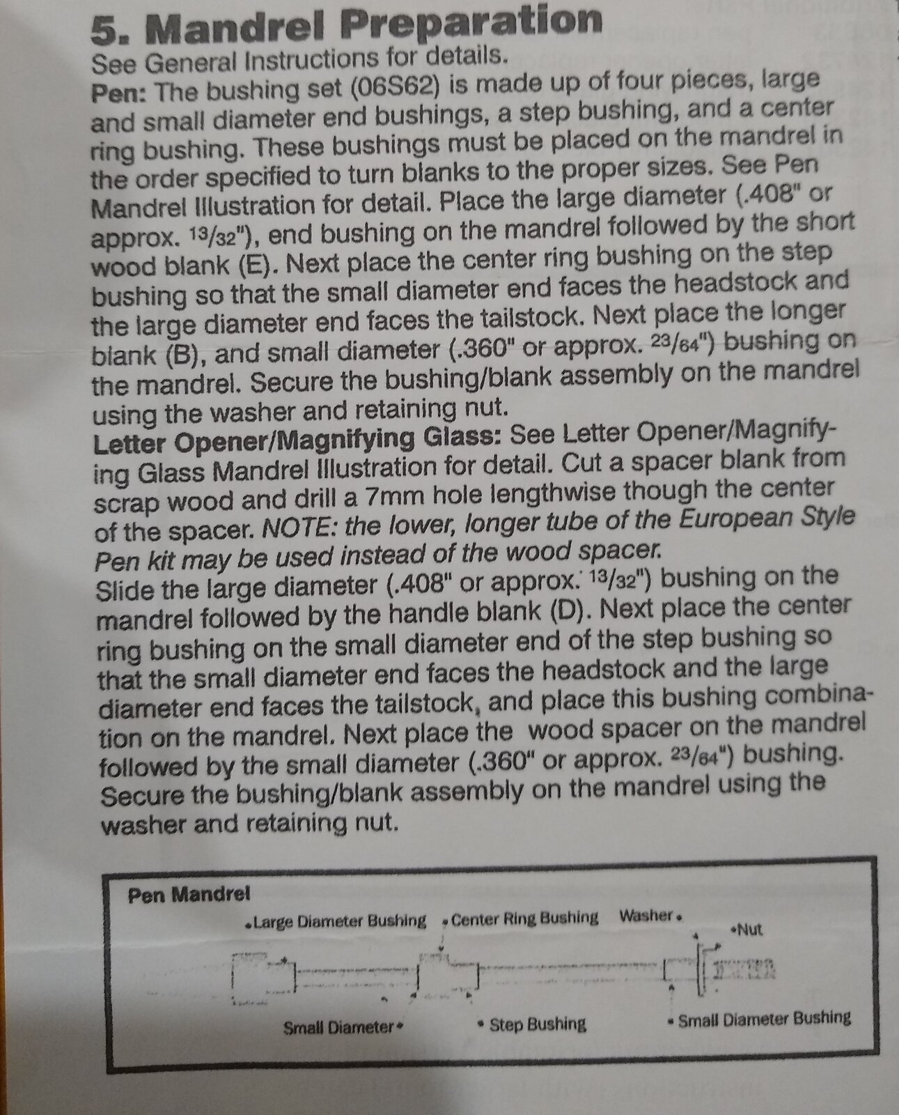

Thanks Brian. I googled "original 06s62 bushing instructions" and found instructions including using the sliding ring to size the tenon. I really appreciate you taking the time to point this out to me.
Mike
Brian,
The old instruction sheet I found was 77B04. It is an old B&W copy but is still legible. I went to the Woodcraft website and downloaded the new revised PDF in color and read it. It has the following text in the turning and finishing the blanks section. It is the same one I was using all along.
"A tenon will be required to be turned for the
Cap portion of this kit, refer to tenon image for specifications.
Use the center ring bushing to check your progress, once the
ring slides over the tenon proceed turning the remaining portion
of the cap end to the diameters of the bushings."
Point is, I did not read the directions thoroughly. Again, thanks for pointing this out. I should be able to complete these pens now and have them turn out the way I want.
Mike
Glad to have helped. I make the tenon slightly shorter, maybe 1/64" shorter, than the instructions indicate. That seems to give a better fit between the lower barrel and the center ring.
I also cut a relief groove in the tenon at the base for epoxy to collect when I glue on the center band.
