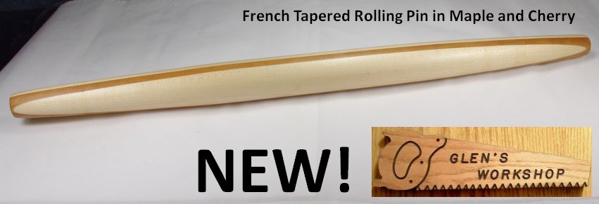

French tapered rolling pin in Maple and Cherry. 22 inches long with 1 1/2 inch main diameter and 7/8 inch at the ends. The flat area is about 8 inches. Sanded to 600 Abranet and finished with clear Danish Oil.
Thanks for looking. C&C welcome.

Great looking rolling pin Glen. I like that shape, maple and cherry goes well together.

Got to say, this is the first time I have ever seen these!
Where/what is the history behind these 'pins', and where did you get the idea from?
Cool segmenting too!!!

Scott,
There is a plan for a baking set which includes a French tapered pin in a Wood Magazine. I added the segmenting. I have seen these done with Celtic knot segmenting also.
My wife has an old French rolling pin which is very plain and smaller than this one. These are easier to make IMO than those with a more traditional (for USA folks) rolling pins with handles.

A number of these (eight) were made as my woodworking Christmas gifts to daughters and wife this year. A ninth is in my Etsy shop. Learned a few lessons along the way (mostly the hard way) which I hope to remember when making more of these.

Care to share those lessons learned?
Can I claim DAMHIKT? Just kidding.
1. The blank has to be straight and square. I started using cauls to help with the straight part after discovering a problem.
2. Finding the exact center on both ends of the blank is important.
3. I get chatter on my 1014 Jet with extension which necessitated a lot of sanding. I am considering some sort of shop made steady rest OR the lathe needs a more solid base.
