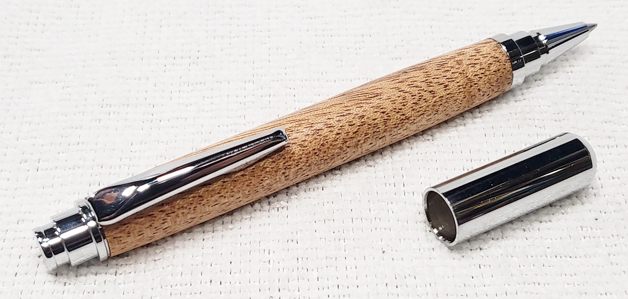

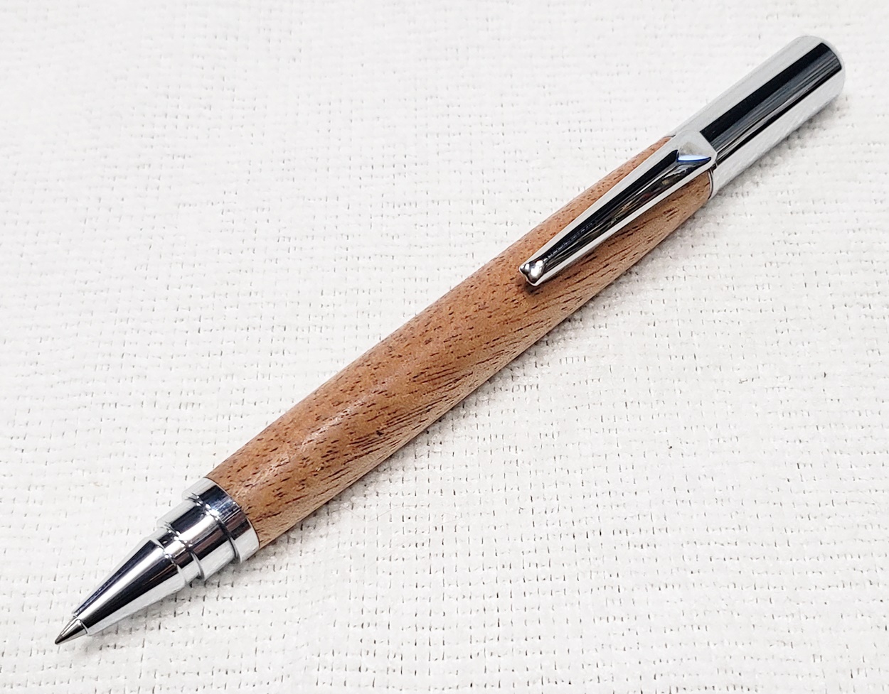

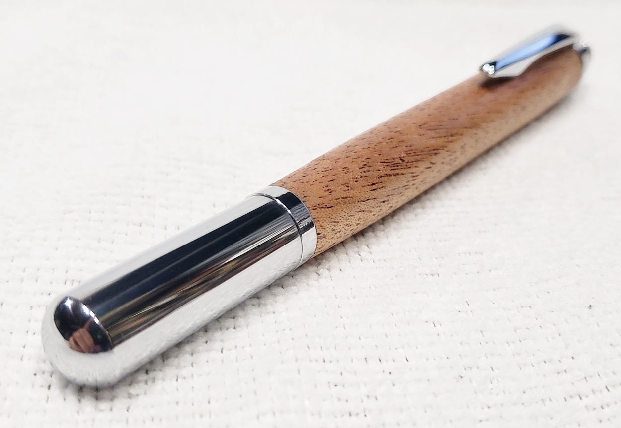

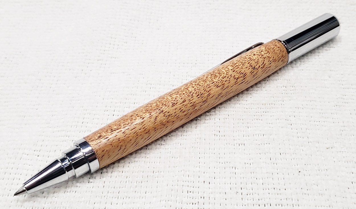

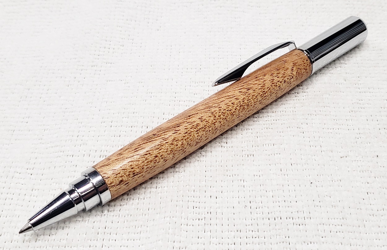

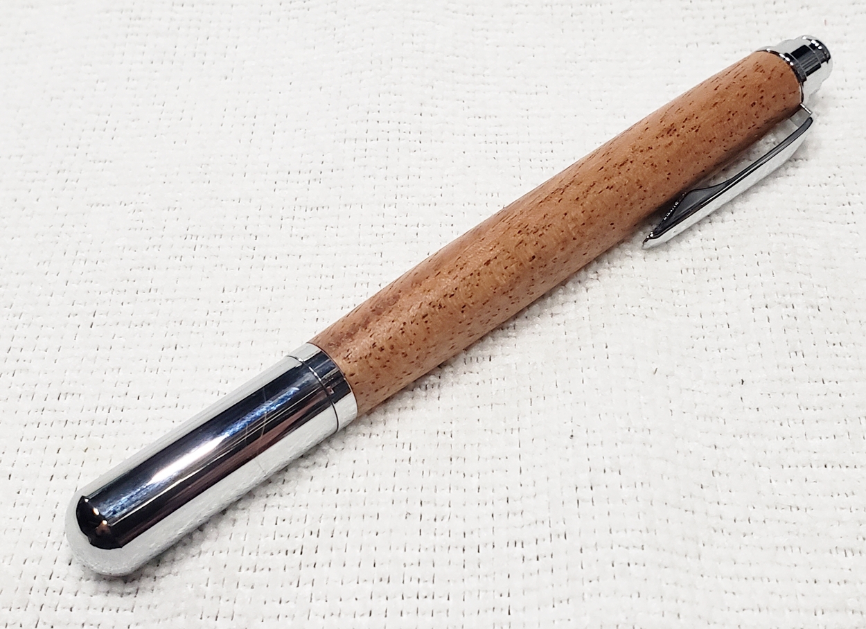

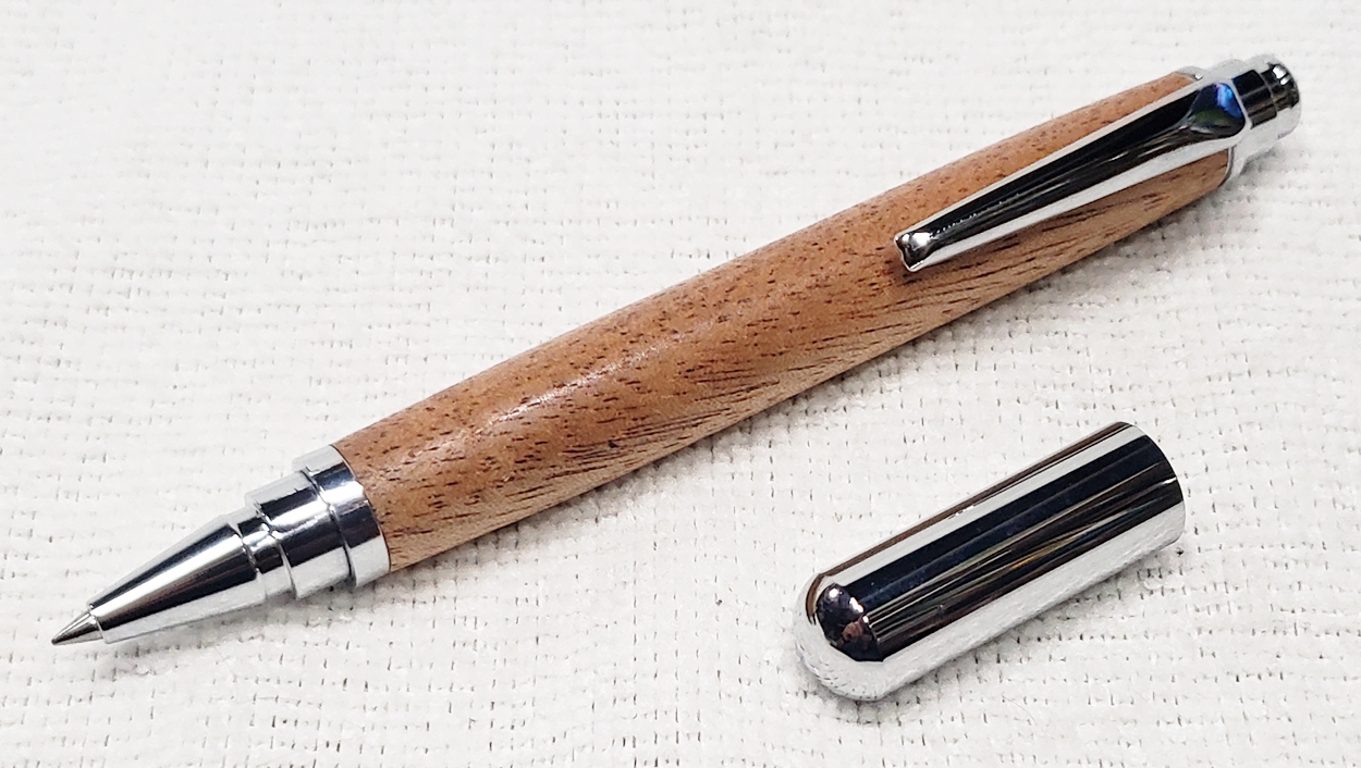

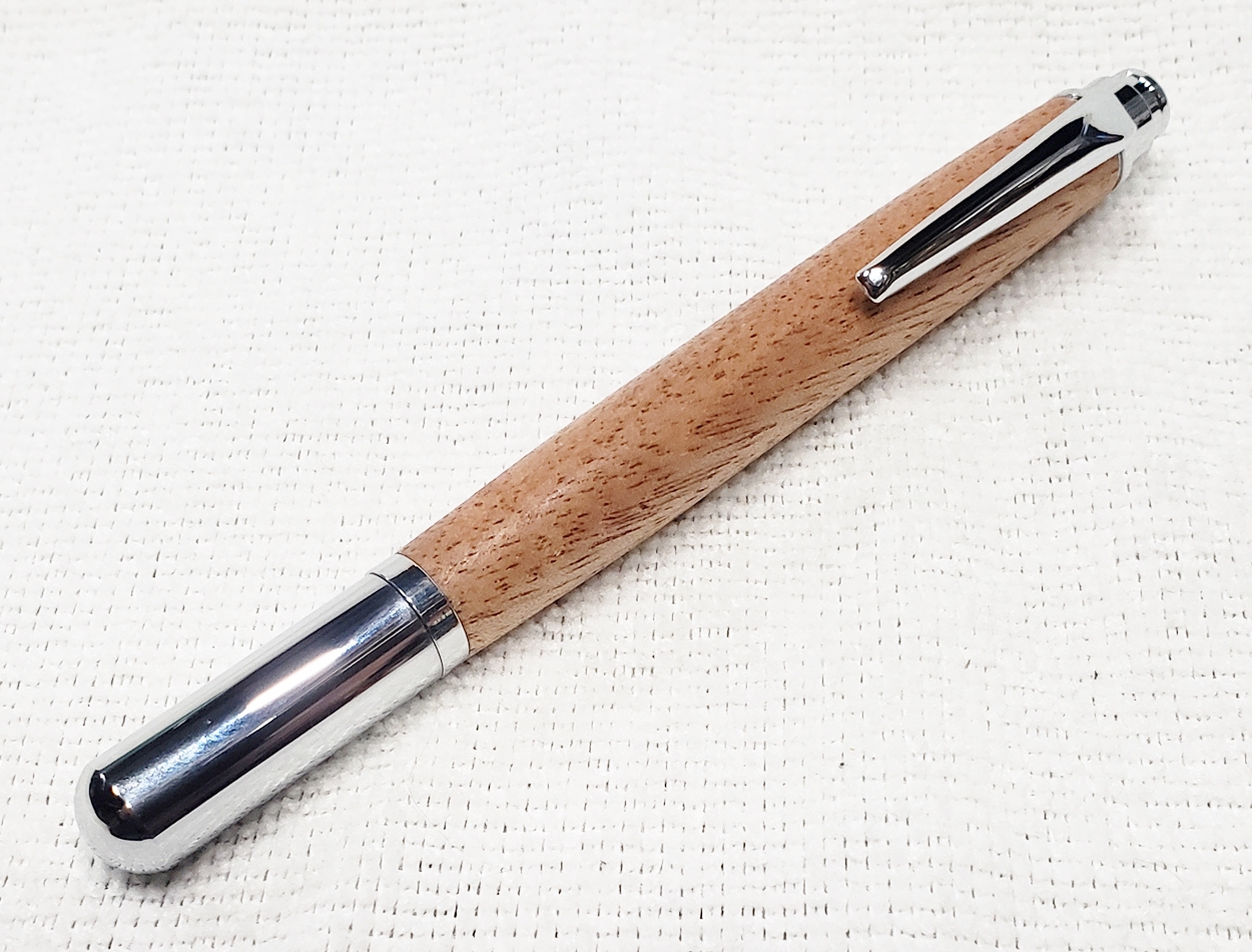

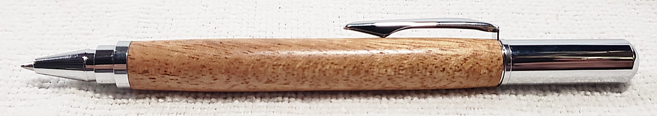

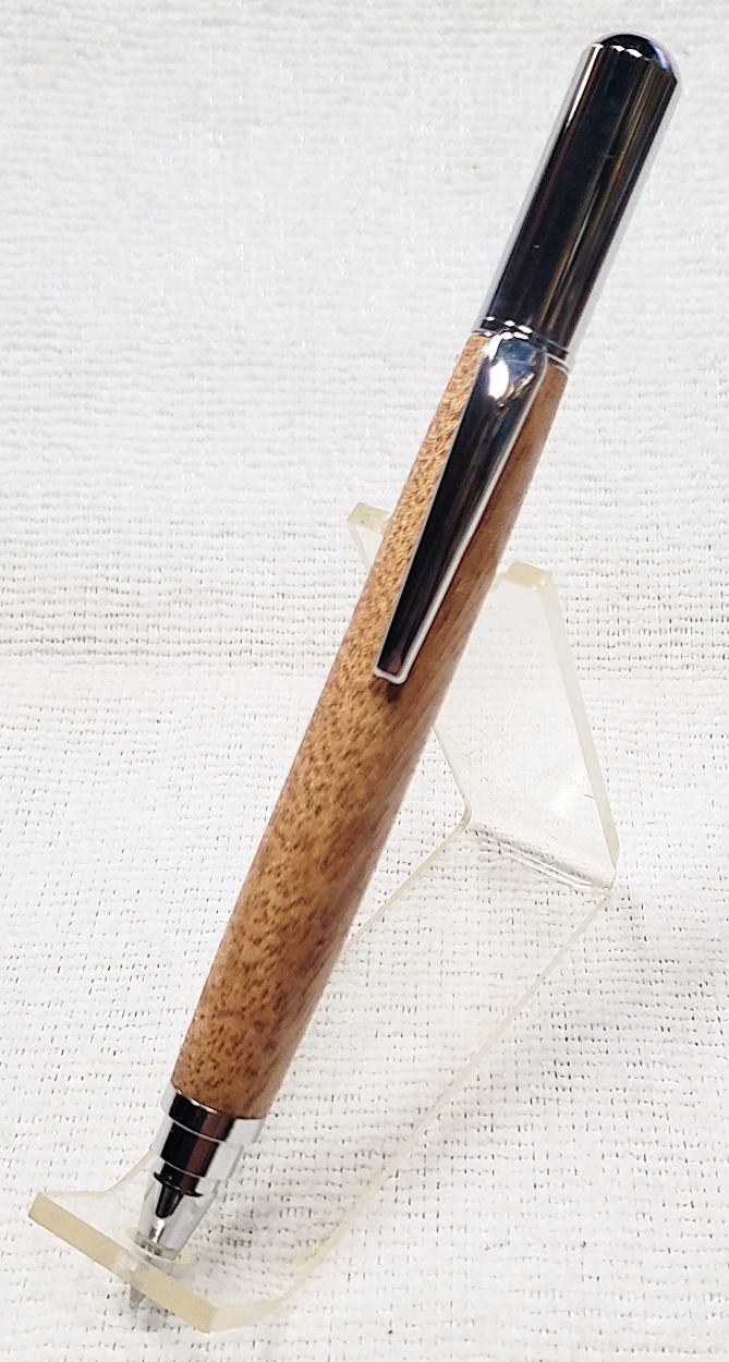

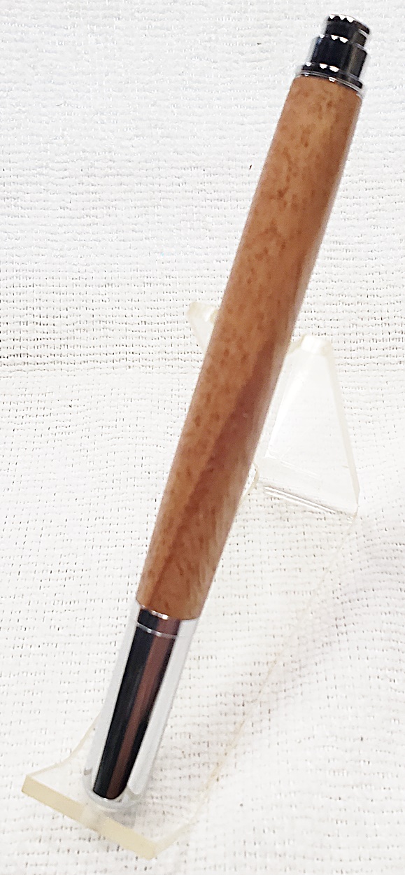

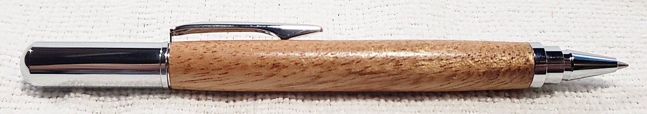

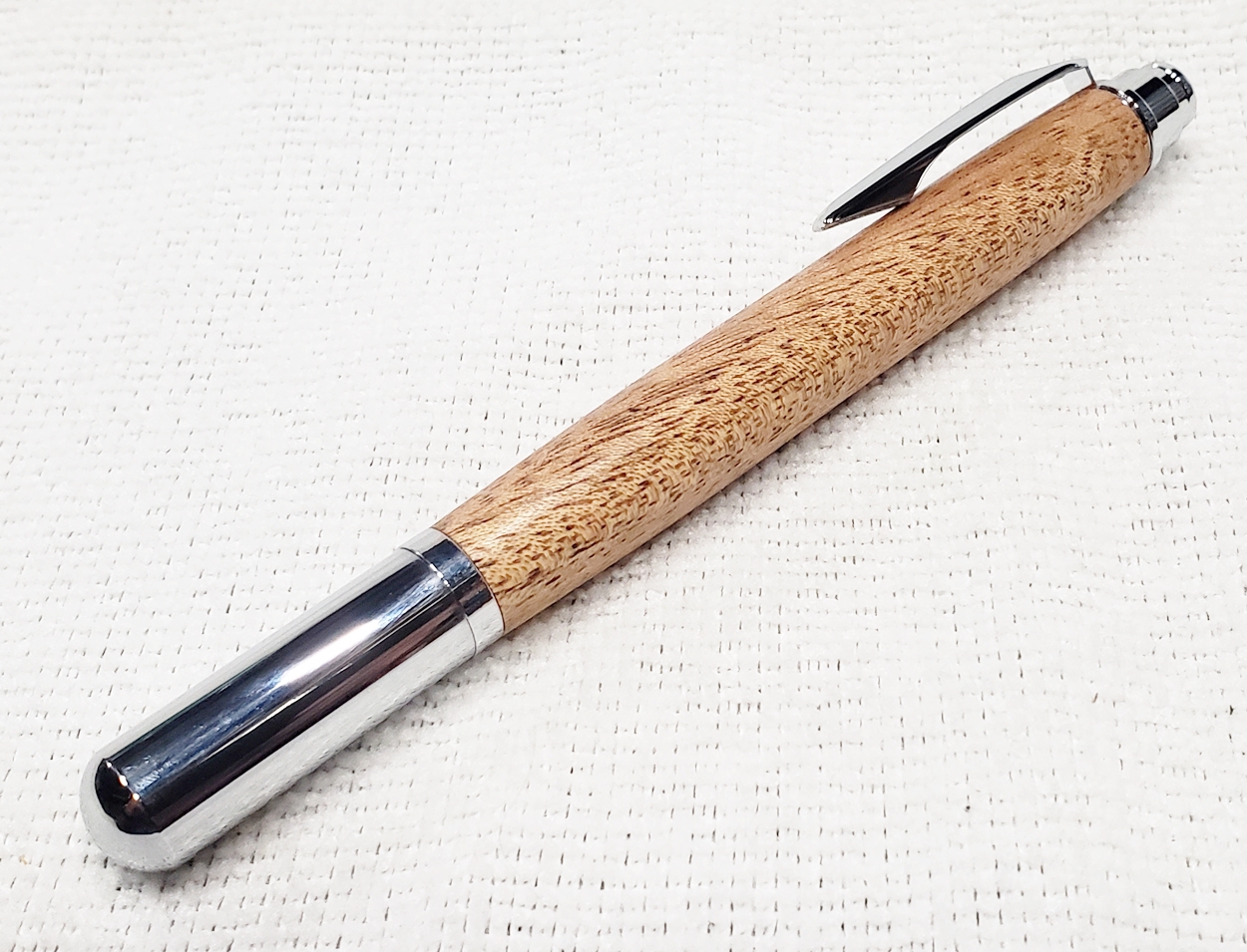

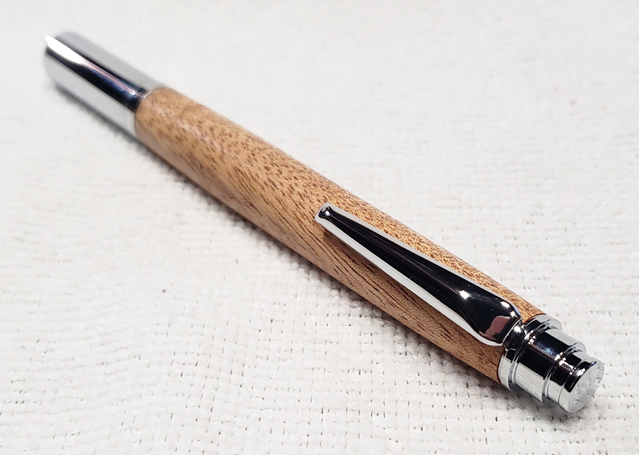

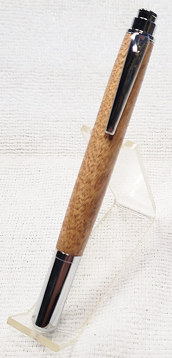

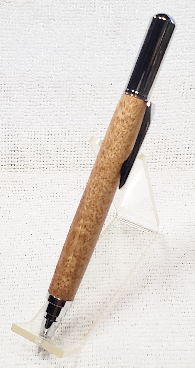

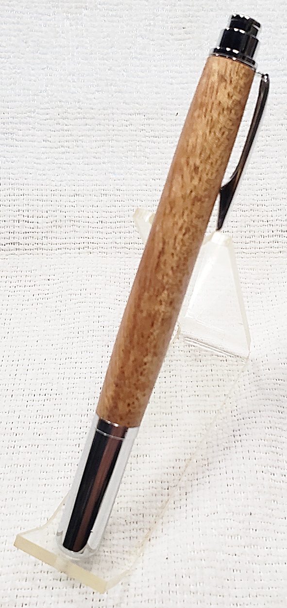

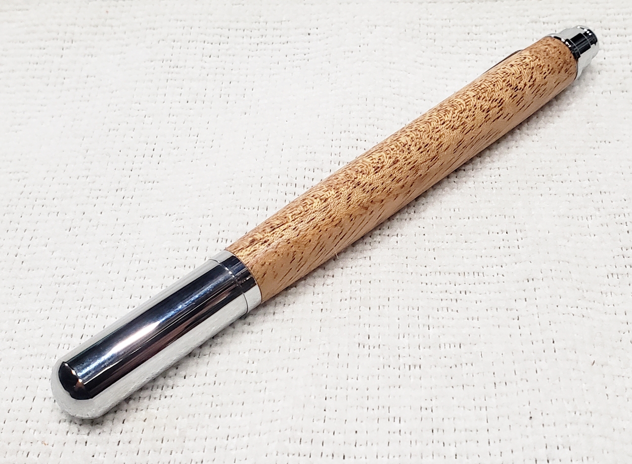

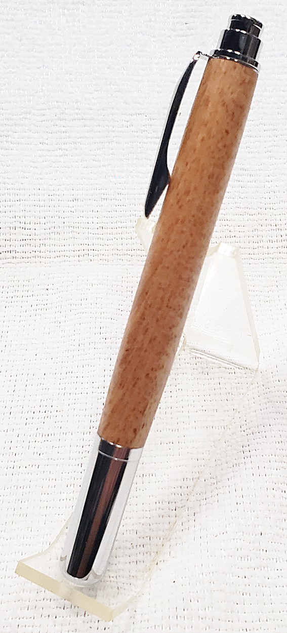

This is a PSI Rollester rollerball, in chrome. The wood is mahogany. The finish is Pens Plus.

Very nice! What are your thoughts on the rollester kit? I just got asked to make a few
I'm mostly a wood pen collector (and not a turner), but I can tell you that the Rollester (gun metal) is one of my favorite kits in my collection. It's simple and showcases the blank. It's also quite well made, especially for the price. However, I did have an issue with the plastic insert in the cap being broken (but Penn State sent a new one). As you can see from my profile photo here, I prefer a thicker barrel to showcase more of the wood and because I like the feel of something thicker and more weighty when I write.
G
Hi Jim, another nice one.
To chime in with BoonareeBurl above, the Rollester is one of my favorite kits also. I have had a chrome one done in Ambrosia Maple as my every-day-carry for well over a year now. I did swap out the rollerball refill for a Pilot G2 though as I prefer gel ink over the standard rollerball variety. Not that it is horrible, but I also agree that the plastic insert in the cap can be a weakness for the design. I've never had one break, but it doesn't snap on as tightly (or as straight) as it did when I first made it -- then again, mine gets used several times every day!
The Rollester is a nice pen to show off a beautiful blank. I have never personally liked the look of them overall, but have sold every one I've ever made. Obviously, other opinions are quite different, and that's why I have a couple more kits waiting for me in the shop. They are a nice weight and take quite a variety of refills. Also, posting the cap doesn't set them way off balance like a Jr. does.
I recommend trying out a Pilot Precise or a Pentel Energel with them. They are both needle tip cartridges. IMO, they look ridiculous in a fatter pen, but work well in narrower pens.
^^ totally agree. The Energel and Precise refills are my go to for rollerball kits. They don't fit in every single one but work very well in the Rollester.
That dramatic visual step from the nib to the needle point could be off putting for some, and the precise can be bit fragile. I've seen some precise points get bent over time with those who write with a heavy hand. I've also dropped a couple on the tip and basically had to scrap the cartridge.
Nice work, Jim. I like the Rollester kit, but after a while it seems like they all end up with a wobbly cap that doesn't stay closed very well. I promise I'm not using them as a fidget toys. It seems like a defect to me, I hope they fix it.
Can I ask where to get these upgraded refills?
Here in The States, most office supply stores will have the refills. You can also buy a Pilot or Energel Retractable pen and just can pull the refill from it. I've seen the pens at most any store that you can buy pens at and the cost difference between the pen and the refill packs is only a few dollars.
The precise is from the Pilot Precise retractable pen - refill can also be found on amazon
The Energell is the same, Refill on amazon or you can buy the pen and just pull the refill
Jet Pens also has a lot of fun refills for Energel and Pilot Precise....and parker for that matter :)
