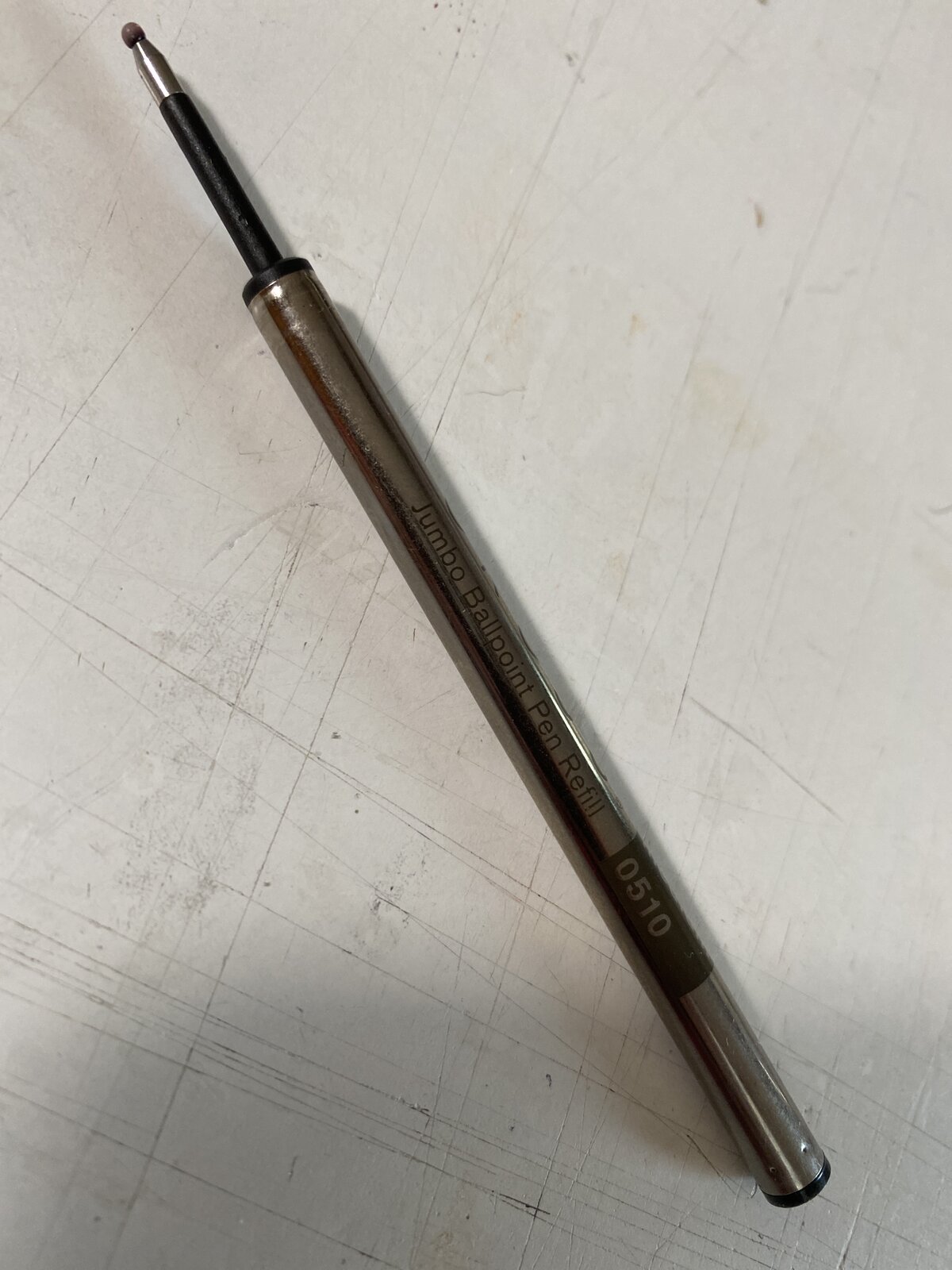

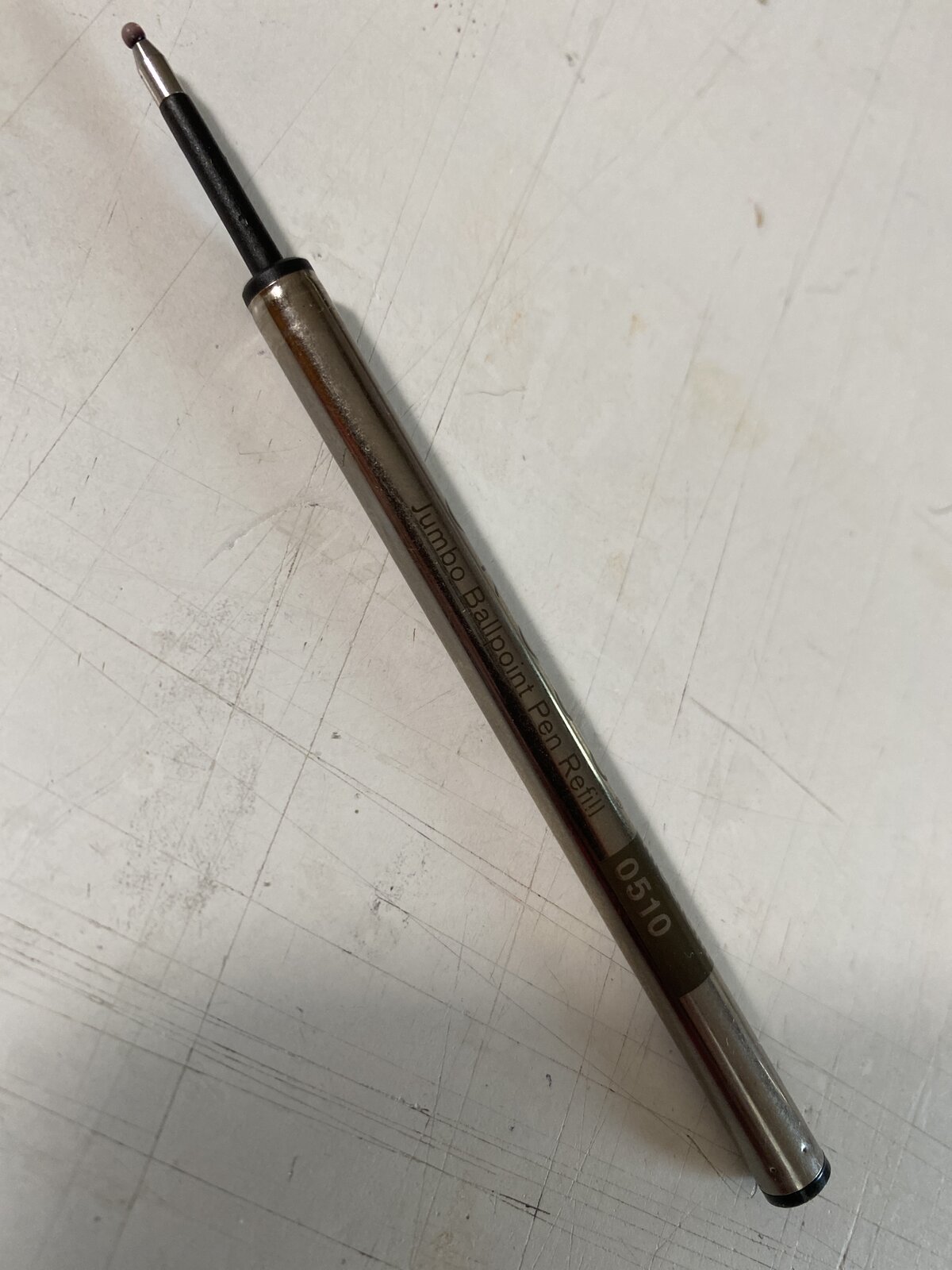

Cross used to make a ballpoint refill # 5010 that was advertised to convert a rollerball to a ballpoint. I bought some for my wife and they worked just fine. I didn't see them listed anymore but they do carry jumbo ballpoints that look similar. You might have to email them and see what they say.
