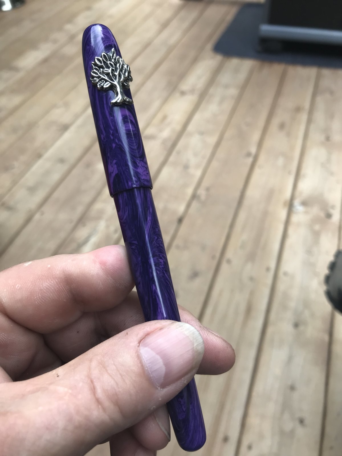

There are a number of makers, that us sterling silver pendants and jewellery pieces as rollstops. Try to get solid silver, that way if you have to remove anything, such as a loop for a necklace chain, you can buff it out easily. I used a tree of life pendant. The one mistake I made with this one, is that the taper of the pen was a little to much, and the roll stop just barely worked.

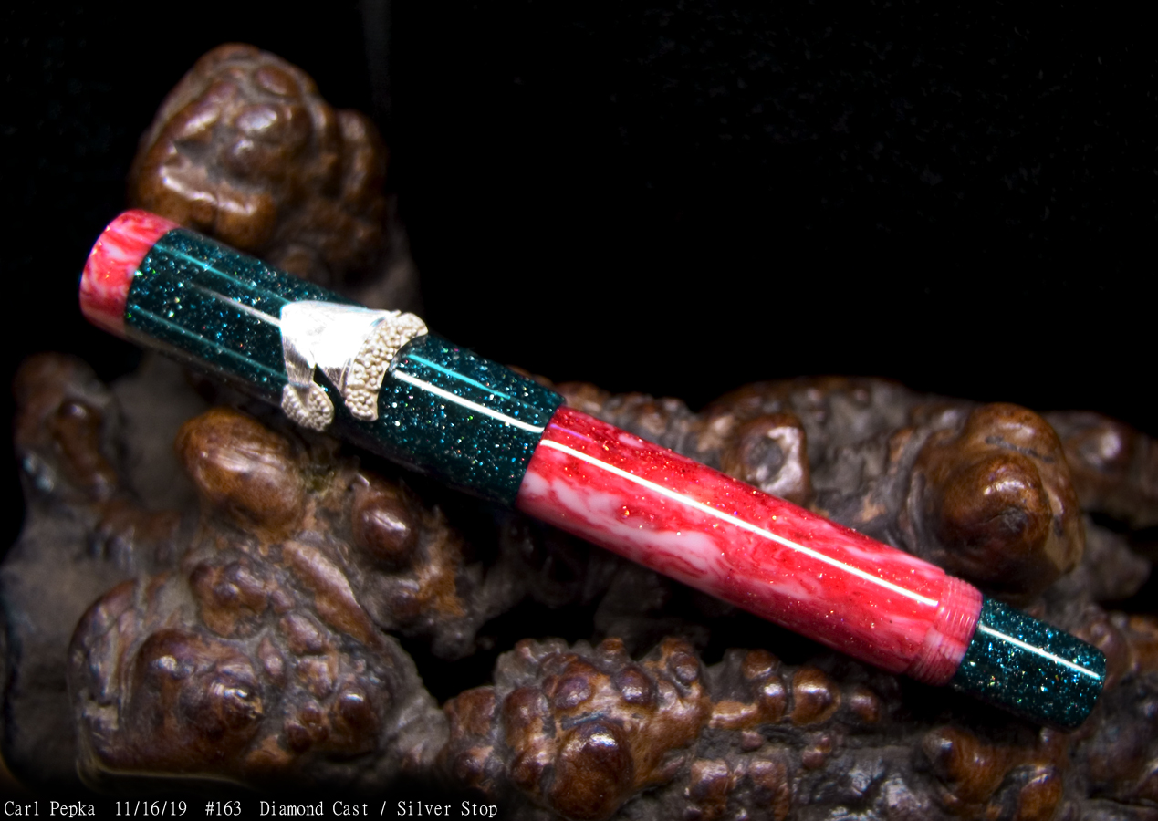

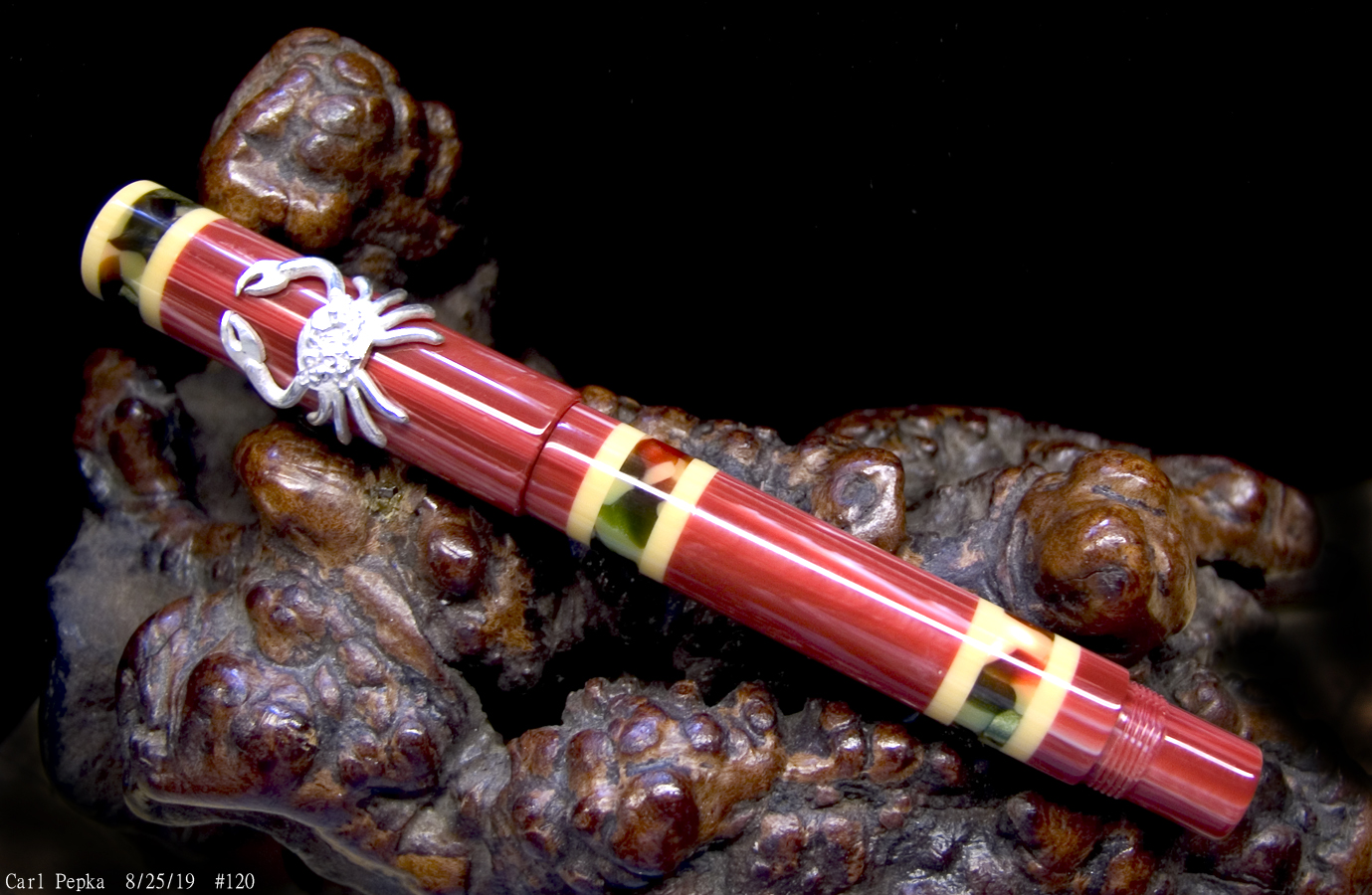

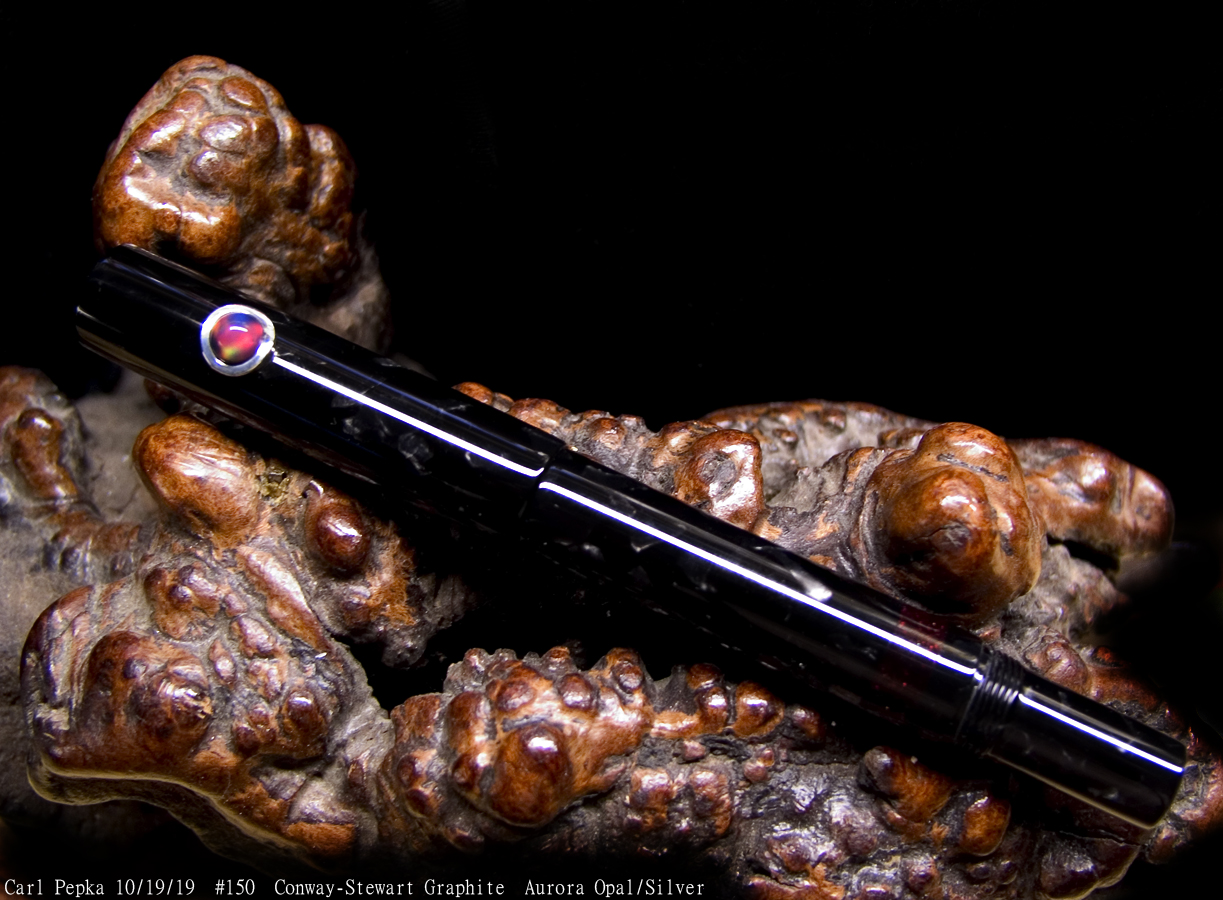

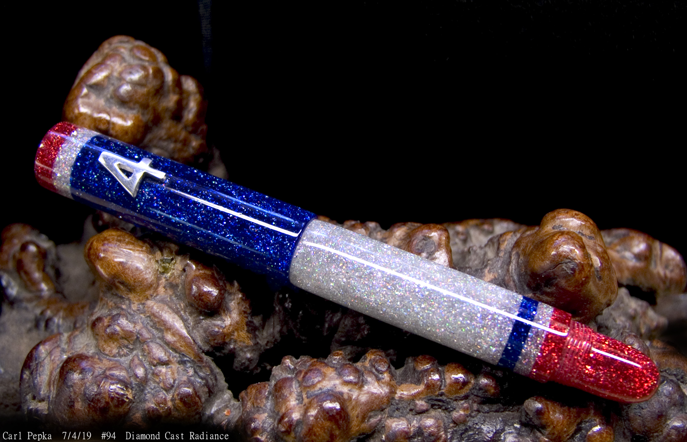

I make my own from sheet and wire silver. The investment isnt all that much and it's really pretty easy.
