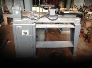

C cmccarter Member Joined Apr 28, 2011 Messages 228 Location columbia, sc Oct 27, 2014 #1 Anyone have any idea what model this may be. Selling for $250. May be worth it if it runs Attachments lathe.jpg 10.5 KB · Views: 333

A Alex D Member Joined Oct 3, 2013 Messages 107 Location Corte Madera, CA Nov 3, 2014 #4 looks like a 46-525 Photo Index - Delta Manufacturing Co. - 46-525 | VintageMachinery.org I turn on a similar (but even older) Delta. Lots of info about those on owwm.org. With a bearing change (pretty simple on those) you will have a serious lathe for not a lot of coin. Alex

W Wildman Member Joined Jan 12, 2008 Messages 1,390 Location Jacksonville, NC, USA. Nov 4, 2014 #5 The add is still up would think by now OP would have contacted the seller or let us know if still available or not! Wood lathe Rockwell delta cast iron If complete and runs would make a great lathe.

D dogcatcher Member Joined Jul 4, 2007 Messages 2,370 Location TX, NM or on the road Nov 4, 2014 #6 I have seen these lathes sell for a $1000 and on up to $1500. If they have all of the part and the motor turns on, they start at $1000. If I had the room, a deal like this would already been loaded and unloaded in my shop.
