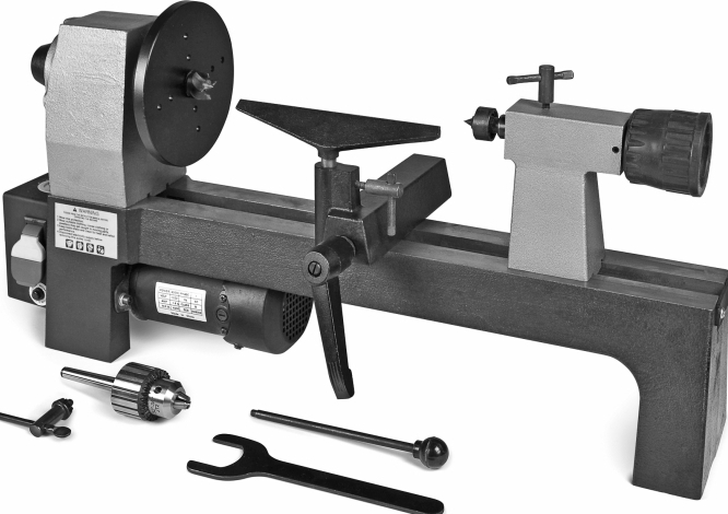

My old lathe did that right before the motor went. The motor was fine just turning but didnt have the torque to handle square things. I may still have the belt. I can check and send it to you if i have it. I believe it was a micromark 8" which looks like the same machine you have if I'm remembering correctly. Here's a picture i found of it. Let me know if you want it.

Now that's my concern, that the motor might be going. I was trying to assume the best, that it's just the belt, and I don't need to replace the motor/lathe, but, well, if the belt doesn't cure the issue, this may be one of the things I review better.
The most likely mode of 'failure' of a lathe mother is that the brushes are worn. You said your lathe was a year old - that seems pretty young for a brush problem, but I suppose it's possible. Replacing brushes or the belt is far less costly than replacing the motor.
