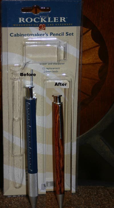

Picked up a Cabinet maker's pencil from Rockler. It uses 2mm lead and has a sharpener in the cap thingie. Took all the parts from the plastic barrel and made a barrel from cocobolo. The coco came from Bill Jacobs. Anthony made me do it.

Don, that came out really nice! The new model is alot bigger/fatter than the old model. Bill's cocobolo is tops, lots of color and grain in that one. So how do you like it compared to the Pentel pencil?

Personally I like it better since I break the leads on the pentel .5, .7, and even the .9 mm. I may be able to start using a pencil again at school....I hear, "why can't we use an ink pen, you do." What can I say to that? I just wish the local Rockler had some of the close outs.

Pretty neat! How does this compare in price to the kits? Just wondering.

The pencil comes with a separate eraser and 6 extra leads and sells for $5.99. Rockler had the previous model on clearance but the store I go to occassionaly (2 hrs away) had already sold out.

Chuckie,
I had some brass tubes that the tip and finial would press into. So I drilled a long hole and glued in the tube much like we do with our kits. The parts of the original pen knocked out with some transfer punches I use to dissassemble pens. The only tricky thing is the hole on the business end of the pencil has to be smaller than the main hole so the drilling must stop short and a smaler hole drilled the last 1/8 inch or so. (The brass tube will not go all the way out the writing end.)If you get one and take out the mechanism you will see why. The mechanism can be removed without rendering the original pencil unuseable. The tip screws off and the mechanism will come out the top. It can be done without the use of a brass tube. I used it for a little more strength. It wasn't difficult, just a bit pricey. If you can find a Rockler that has the closeouts, then the price is $2 I think. IUf you want to try one and need some help, email me.

Don,
How does the clip and clip fitting attatch to the wood barrel on that version, press fit?
