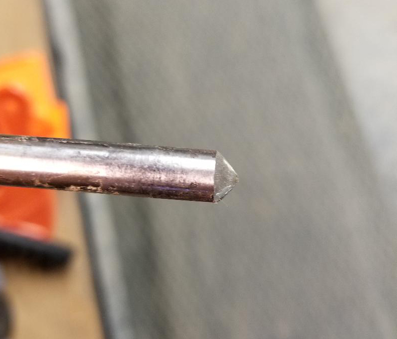

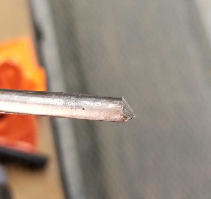

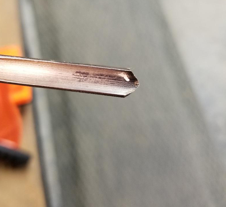

I really need to find something to help me with sharpening. Everything on the market is over $100. Lol I don't weld and I don't do any type of metal work. But I am destroying my 3/8" spindle gouge just trying to get it sharp. I've basically lost my angle and unable to get the cone or sweep right. I'm thinking of hitting harbor Freight and get one of those angle cubes just so I can try and get my grinder jig rest angle better.

I have a Robo Rest and love it but that isn't going to solve your problem based on what I see in the picture. Using Any kind of platform for a Spindle gouge like that requires knowing how to freehand sharpen. In other words knowing how to set the angle, swing and rotate the tool at the same time. Even many experienced Turners don't free hand sharpen Spindle or bowl gouges.
Using a jig such as the vari grind and Wolverine will solve most of your problems with that tool once you understand how to use them. I have 'fixed' many Spindle and bowl gouges for new Turners. Some in much worse shape than that one. It can be fixed quickly, in a minute or two, if you know how to do it.

Yea Jim, my biggest problem when I try to rotate my spindle gouge, my right hand on the handle always wants to lift up off the rest.
