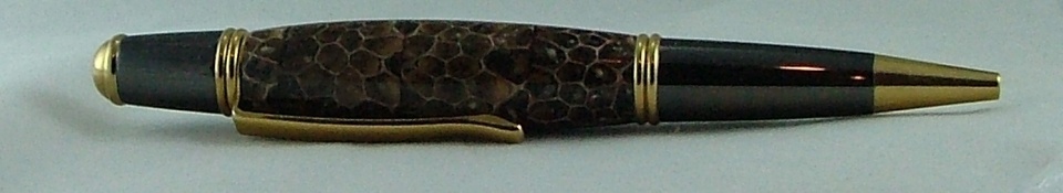

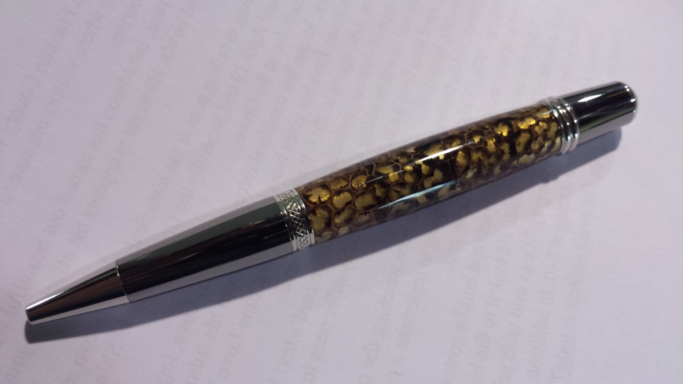

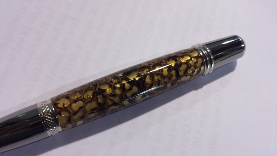

A couple months ago Jeff was contacted by Robert Gibbs who wanted to give out some of his clear epoxy Sweet Gum Blanks. I was one of the 40 or so people to contact him and he sent me a couple blanks. Here is my attempt of his blank. The blank did have a few air bubbles in it but patients and CA took care of that. He suggested to use a pen kit that allows a little thicker blank when finished, so I used a LeRoi V2 Ti Gold kit. If you have pens you made with his blank please feel free to post here. Thanks

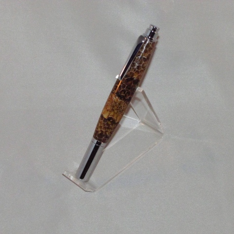

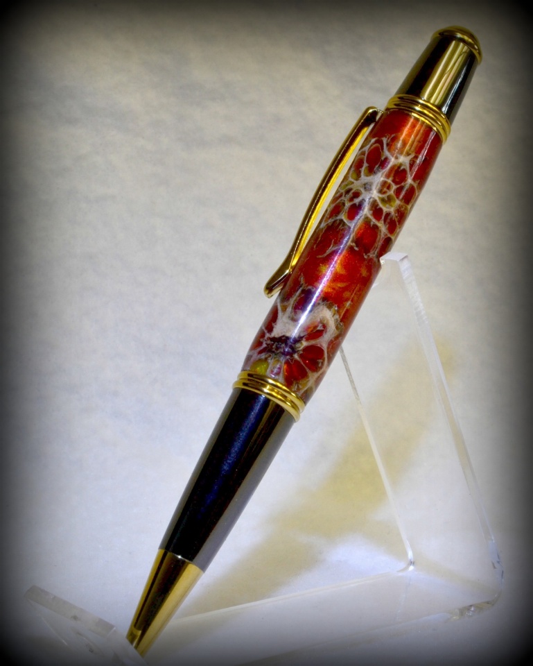

I used a PSI Compson Click pen that I got in my BASH prize box from James White. It's the first time I've tried this kit & I really like it. It takes a 3" blank, uses a 3/8" tube & leaves a good bit of meat at both ends, especially at the nib end. The clicker has a good feel to it and seems to be quite sturdy.
I back-painted the blank with white paint - it may not be so obvious from this photo, but it makes the blank look very much like a snake skin blank.
I think a darker back-paint brings out the sweet gum pod outlines better, so I'll probably try some kind of blue paint on the second one.

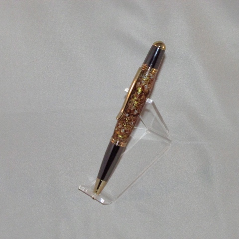

I have one of his that I back-painted with blue - it's not quite finished yet, but already looks sharp so I think you've got a good thought to give blue a try. I just need to find some time to get into the shop and finish them up... Maybe I'll be able to get it done and have a picture up this weekend.
