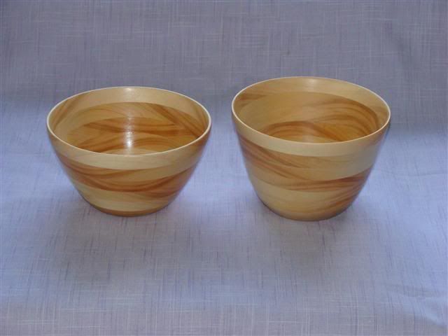

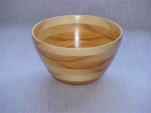

Made this one today . I was wasting some good hardwood practicing on this style with the Ringmaster so bought some cheap fir . Straight wall ones are a piece of cake because they can be made with one board and only require one angle setting for every ring . Then a very gentle curve can be done like I did just before this one with one board using several different cutting angles.
In order to get the amount of curve like in this one requires a much steeper learning curve. A friend was good enough to help me out via email to accomplish this . Two boards are required and every ring is a different angle and in thousands of inches. Next one will be quite a bit easier now that I have caught on how to do it but will probably still practice with soft wood like this for a few more before moving on.
This one is 8" diameter x 5.25" tall
After more practice pieces with these both in soft wood and then in hardwood , I hope to go on to vases and hollow forms and other things that can be made with the RM.

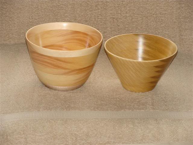

Second picture is to show the difference side by side of a one angle straight side on (on the right) and the curved one which creates a much greater challenge to accomplish.

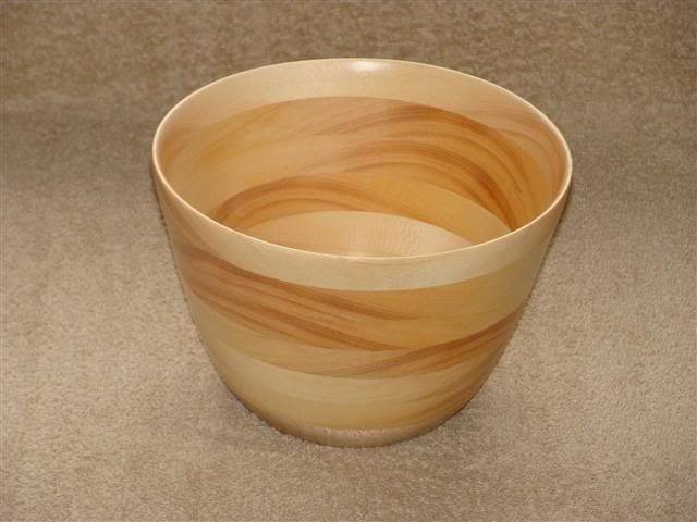

Here is one that I cut all the rings out of after lunch today .
It just has one coat of sealer and one of lacquer at this time. Will be sanded down and a couple more applied. I think it has a more pleasing shape than the first one but then shape can be a personal matter .
Here is a side by side comparison with the one I made yesterday afternoon.

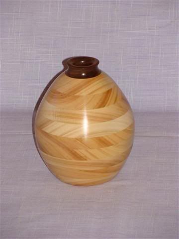

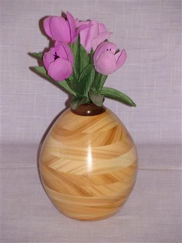

Decided to try a vase for the first time this afternoon after having done a whole bunch of bowls already .
All went well and got the finish on after dinner. It is 6.5" at widest point and 8" tall .
I suppose this could also be classified as a hollow form ?
Hey . . . I think I am catching on how to use my ringmaster ;D
