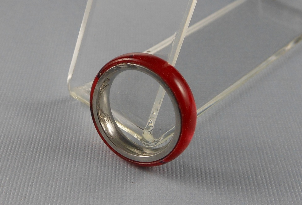

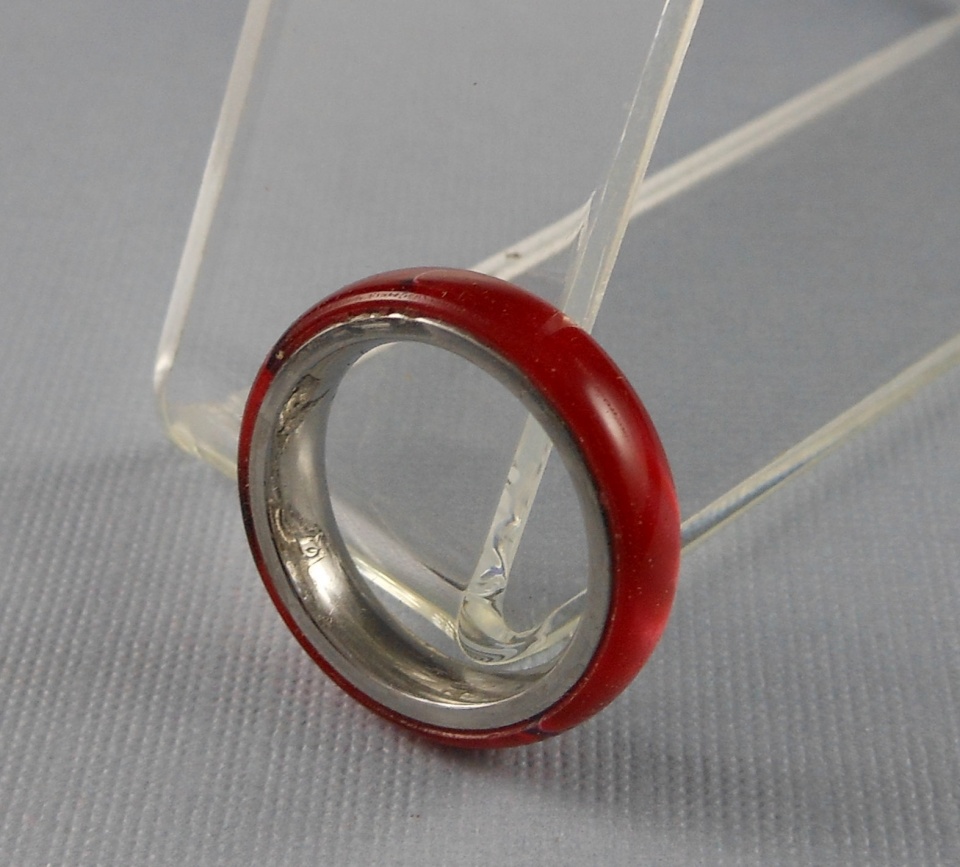

I made one yesterday, out of crimson acrylic. For the first time it came out so so. Had no trouble drilling the ID hole, then using a parting tool to exact size. But when i inserted the core into the hole, there must have been some dust or what ever in the bottom and it didn't go all the way in. So i had more then 1/16 to deal with. The glue ( epoxy ) was a problem getting off the stainless steel core. Dummy me used a knife to scrape it off and i got a few scratches in it. All and all i was pleased with how it turned out. I'll take a pic of it later when my camera battery charges up. Looking forward to making more. Interested as to how unstabilized wood would work out. Carl
Here are a couple pics of the ring. Crimson Acrylic on Stainless Steel from CSUSA. It came out OK, I guess, for the first one. Going to make another, but this time I am going to wrap my own made veneer around the ring core

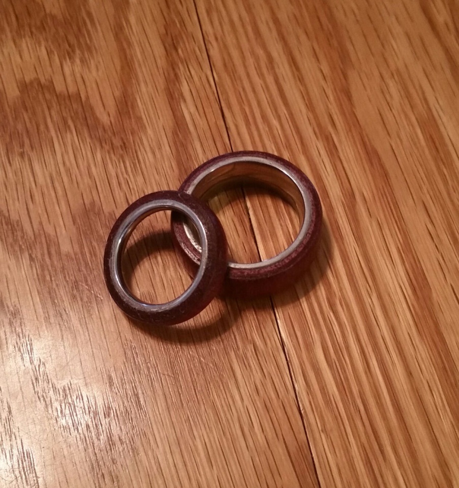

I made the attached pair this weekend. In fact I made both of the twice. I drilled a series of Forstner bit holes in a waste board and tested the inserts for fit. I used the Forstner bit closest to the right size for each ring insert to bore the holes on the lathe after I turned the blank round. Then I took it off the lathe and used 80 grit sandpaper to get it to the final size I needed. I was using Purple Heart rather than one of the stabilized woods or synthetics. That's what the customer requested. One was a 10mm ring and the other a 3mm ring.
The first blank for the 3mm ring broke in half when I took it off the double sided tape. Let the glue dry for 48 hours then turned the rings. Turned the 10mm ring first. Had it almost down to size and was going to make one more tiny shaving pass when the blank shattered. Turned another one and glued it the insert and let it dry while I turned the 3mm ring. It turned easier than the 10mm ring for some reason. By the time the glue was dry, I was ready to turn the 10mm again. Customer was happy. Waiting to hear his wife's reaction. They are a surprise.

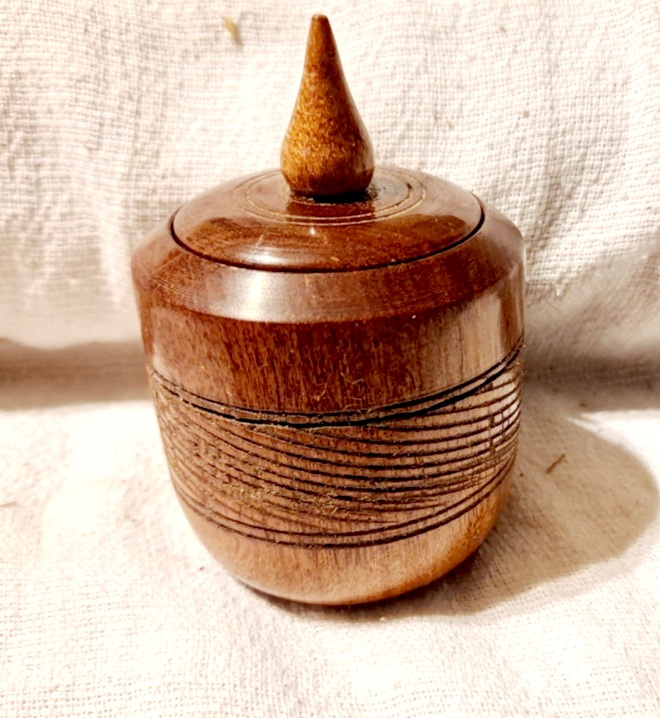

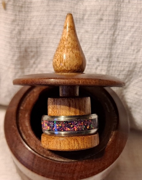

I prefer this type myself. Making them is WAY easier. I made this for my wife yesterday when she went to get groceries. I even had enough time to make her a box out of some badly checked (and brown) purple heart. I have made only a few comfort core, and I just didn't like how they felt. The 2 piece core, in my opinion, is a much better choice.
