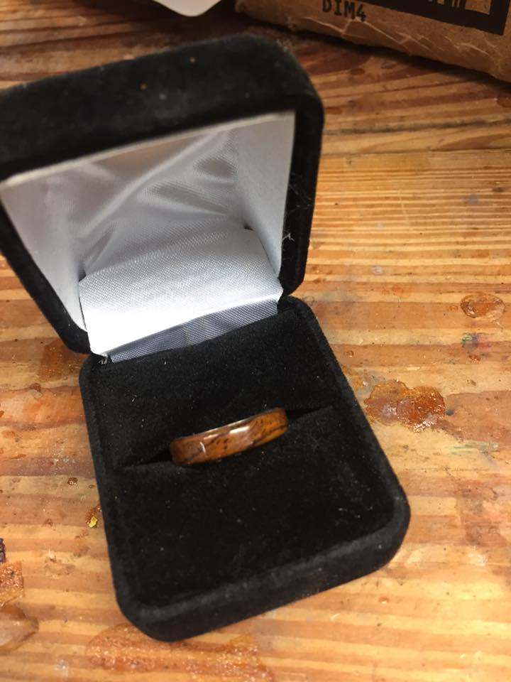

For a personal gift for my wife I went to the ole internet and ordered a bunch of goodies.
This is what I ended up turning on the lathe for my wife.
Wood is Cocobolo I had in the shop.
she is going to like that, came out nice, I have made rigs on a metal lathe, now time to try it on the wood lathe, sure hope you have a matching one

Does it have an insert? I've never heard of a 100% wooden ring that lasted more than a few days.

The metal split in half or just the wood? I wouldn't do anything less than 4-5 mm for strength and so the grain is more visible.

Yes but I did leave a little slack and let the CA do the work. The 1st attempt slit because I did not have enough of an opening in the wood.
The sleeve cores offer no side protection which is where the impacts usually are, rings with side will last a very long time, mine is almost 8 years old and worn every day and still looks almost perfect, you also need to score the metal to create a mechanical joint for the glue to adhere, I also use professional grade epoxy to glue the core and blank together. If you want to try a different style core I make several different sizes and widths. Send me a pm
The wood blank split along the grain lines where it was thinnest. I like the CSUSA inserts, but the ones from Wildwood Designs Ring Supplies are two piece and wrap around the wood to keep it secure.
There are 2 different styles of wood rings (no metal). Laminated has 3 layers minimum with alternating grain direction for each layer and bentwood style. If made properly wood rings will last with bentwood be the stronger option. If you take a piece of wood and make a ring then it will not last as there is no strength in a single piece. I have been making rings for about 7 yrs and have only had 2 break (laminated style) and they were from a couple which I believe did it on purpose to test the strength. They were also 2 of my most difficult customers.
Nice ring. What type of finish did you put on it? I'm sure she was very pleased.
Not trying to hijack the thread but for those looking at trying rings with metal inserts I strongly suggest contacting JD Pens from the previous post in this thread. I have used wildwood designs and JD's and JD's are a much better quality.

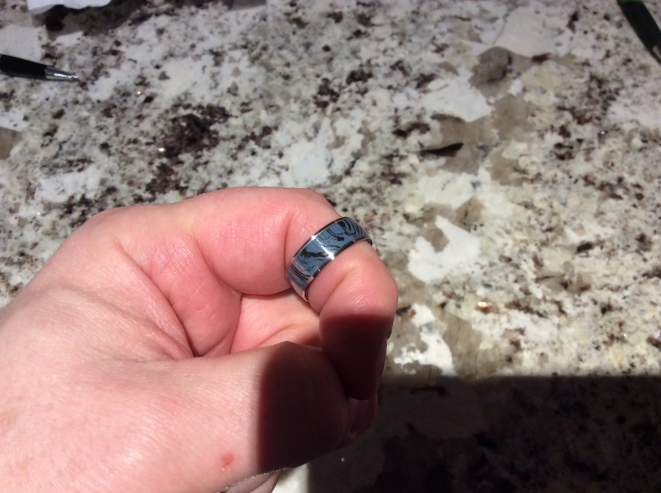

My latest with the metal insert and material from JD.
