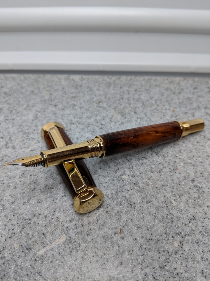

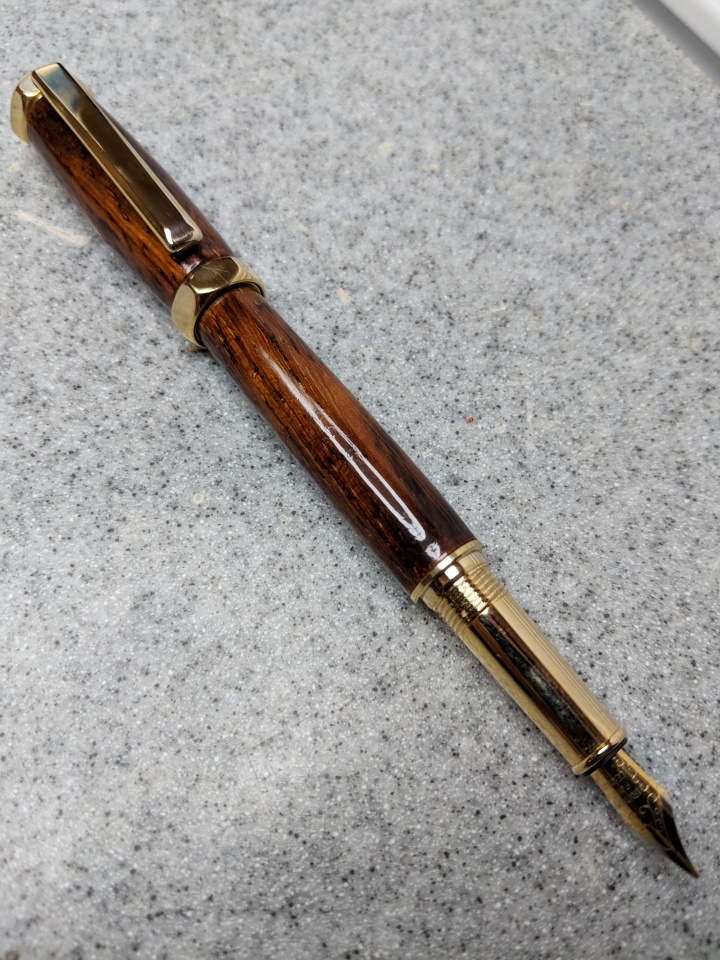

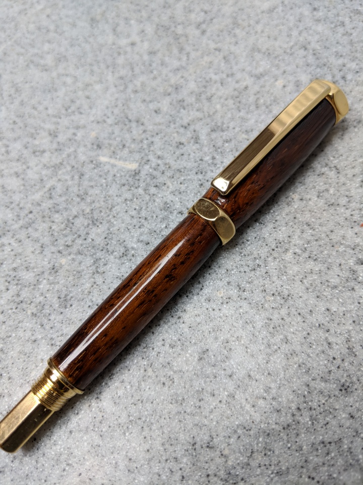

Thanks, I can improve on the pen some but I thought it turned out pretty good. I had one of the trim rings on the body Bass ackwards and ruined one on the threaded inserts getting it out. Now I guess I have a parts bag. :mad:
