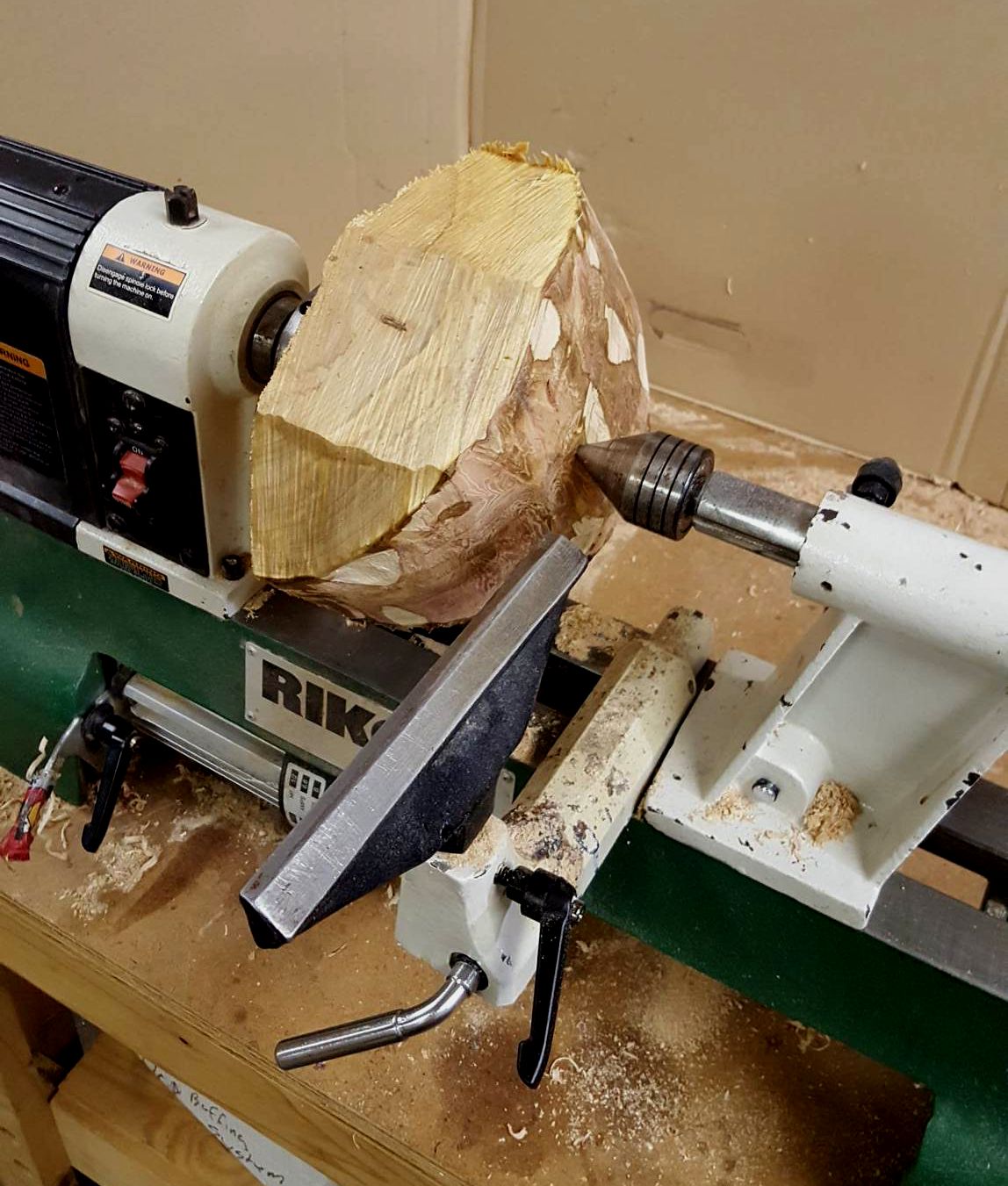

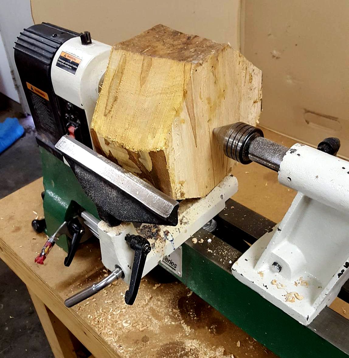

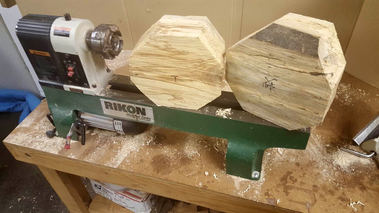

I have a Rikon 12" turn. I have beat the snot out of this thing... putting way too big of blanks on it... and it is still going for over 15 years. I would though, recommend the VS. They didn't have it back when I got this one.
