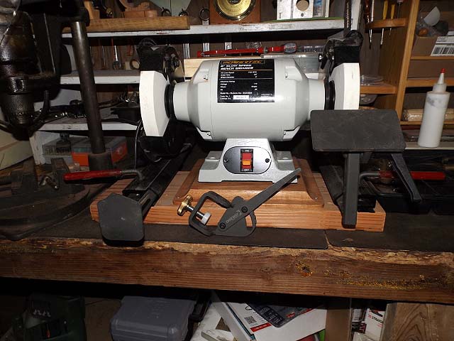

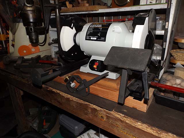

I have mine all set up and have used it and love it. Now I want to get the raptor guides for setting the angles. Those are pricey at over $8.00 apiece. Any way, I have a near perfect bevel on my bowl gouge but it was tricky getting it right. Here is my set up. Fay
