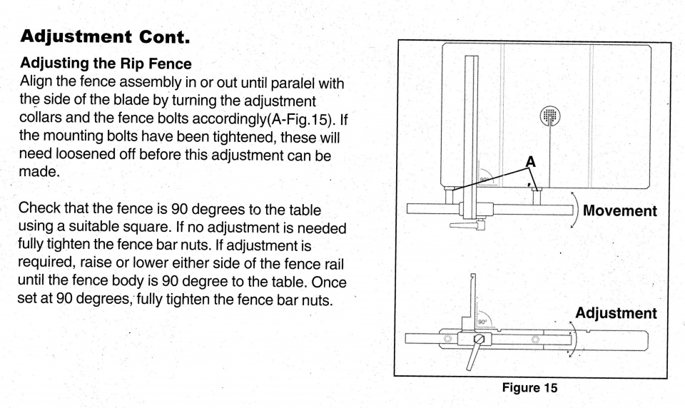

Here you go.
I just do not like aligning a fence to the table top. You do not do this with a tablesaw why do it with a bandsaw. I suggest take a scrap piece of wood and draw a straight line down the center. Not start to cut the line dead on free hand slowly. Observe how you have to canter the wood to keep it cutting straight. Then without moving the wood shut the saw off. This board now represents the drift or set in the teeth, in that particular blade and I would now set the fence to the side of that wood. Now your fence is locked in to that blade. Now if your blade happens to run 90 degree to the table top then good for you. The saw is well tuned.
As I said the blade will cut no matter if you do this or not but what you will see is more pronounced blade marks on the edges of the wood. This comes in more-so when resawing because now you need to plane or sand those blade marks out and the deeper they are the more material you waste. When you see people resawing paper thin veneers their saws are very well tuned and that includes a fence. If cutting pen blanks then just set up as described in instruction sheet. Good luck and happy sawing.
This method is easy to check. After adjusting, mark a straight line on a board parallel to the edge of a board and saw in one end slightly hitting the line. Flip the board end for end, keeping the same edge on the fence. If you hit the line on the other end, you are square to the blade.
