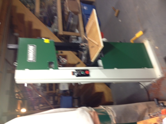

Ok it is all setup I have made a sliding table for it. I did however have one problem with it. I got everything finished and had the setup done and ready to go. I turned it on and nothing? I mucked around with it last night with no luck so I decided I should give it a rest and come back to it later. Today I figured out what was going on with it. The top safety switch was making then breaking! I slipped a piece of rubber hose onto the striker and that fixed that. I guess as the door closed the angle was just enough to let the switch come back up. With the piece of rubber hose on there it works correctly every time. Now for the saw. This thing is amazing I can see why you guys like the 10-325. Everything feels very stable and strong. I think this thing at least on first impression is very nice. Sorry the image is really bad but you get the idea..

I have been using my old Jet for 3 years now and it has done me well but this thing is just a dream. Very quiet. I made myself a sliding table and actually use the saw to cut up 12 cigar pen blanks that were ordered. I did have some trouble with the upper door safety switch but a piece of rubber tubing fixed that right up. I put it on the striker and all is well. I don't think anything that I am going to cut will slow this thing down at all. I need to order up a 1/2" x 124" 8TPI blade and see how that works for segmenting. I have not segmented any pens for a bit now. I have to get back to that soon.
