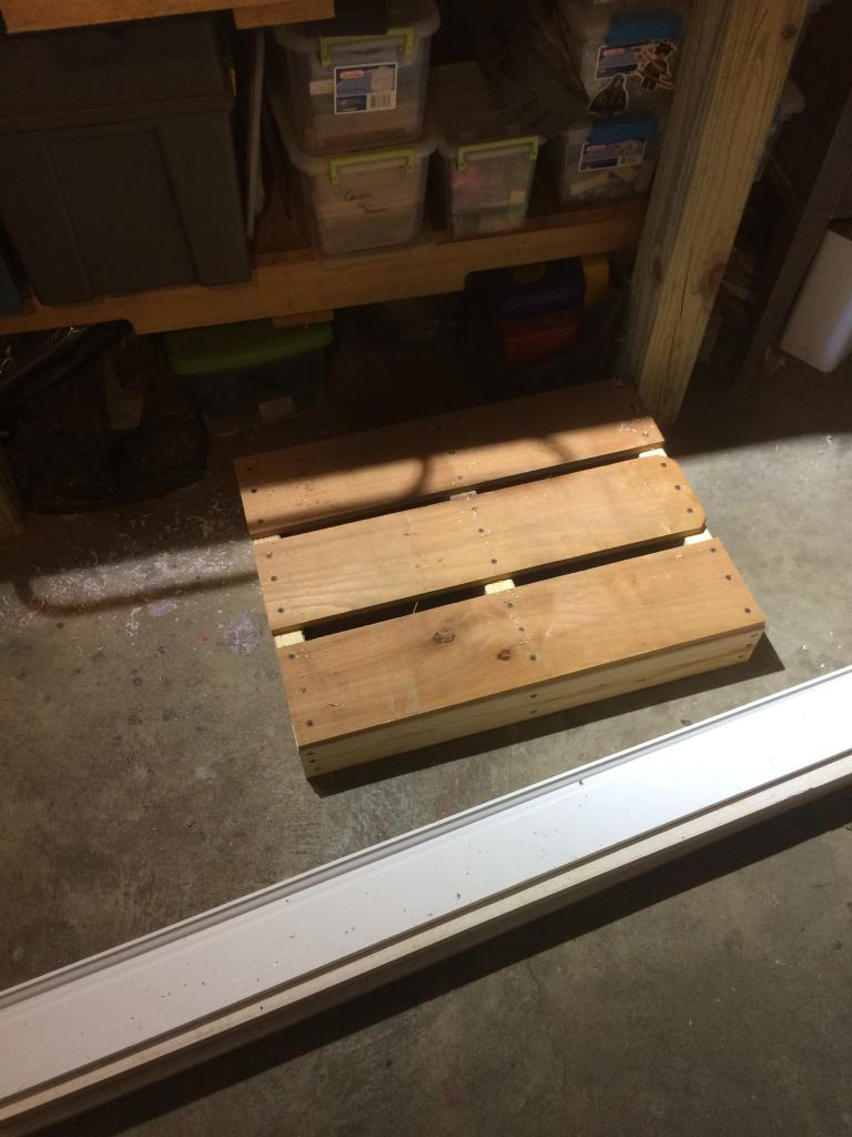

I'm glad I found this thread! I just built (about 15 minutes of my time) a pedestal. One 2x4 and one cedar fence slat, and a bunch of screws. I was going to upload a quick picture, but photobucket isn't cooperating.
