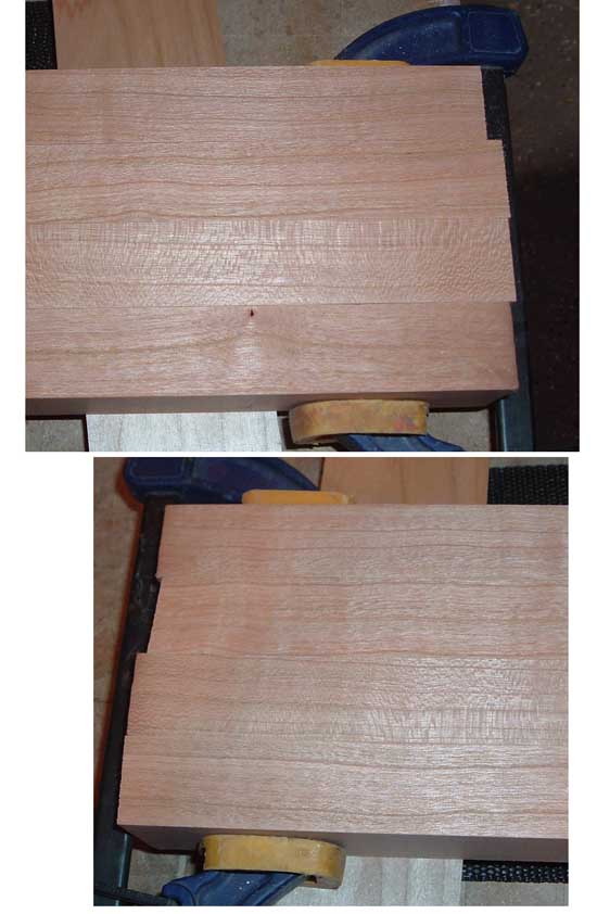

Here is how I check for snipe. After the boards are planed to thickness I stack them and clamp them together. The snipe shows up clearly as a gap between the boards, always at the same distance from the end. These 4 boards were run end to end but the last one did not have a followup so the last one would get the snipe. I always got snipe at the end but not at the front of the boards. Also, I previously could easily see and feel the snipe on the surface. If there is snipe on these boards, I cannot detect it.
If you really want to know if you have snipe, use a long straight ruler and lay on edge across the board. You can also get wavy boards and not see it too. yes taking less off will help in tearout but again if you want to eliminate tearout switch to a spiral carbide cutter head. The small cutters will slice through the board as opposed to chopping through as with normal planer blades. I use a planer to get me close but always finish with my drum sander to take it home. Never has failed me. Good luck.
