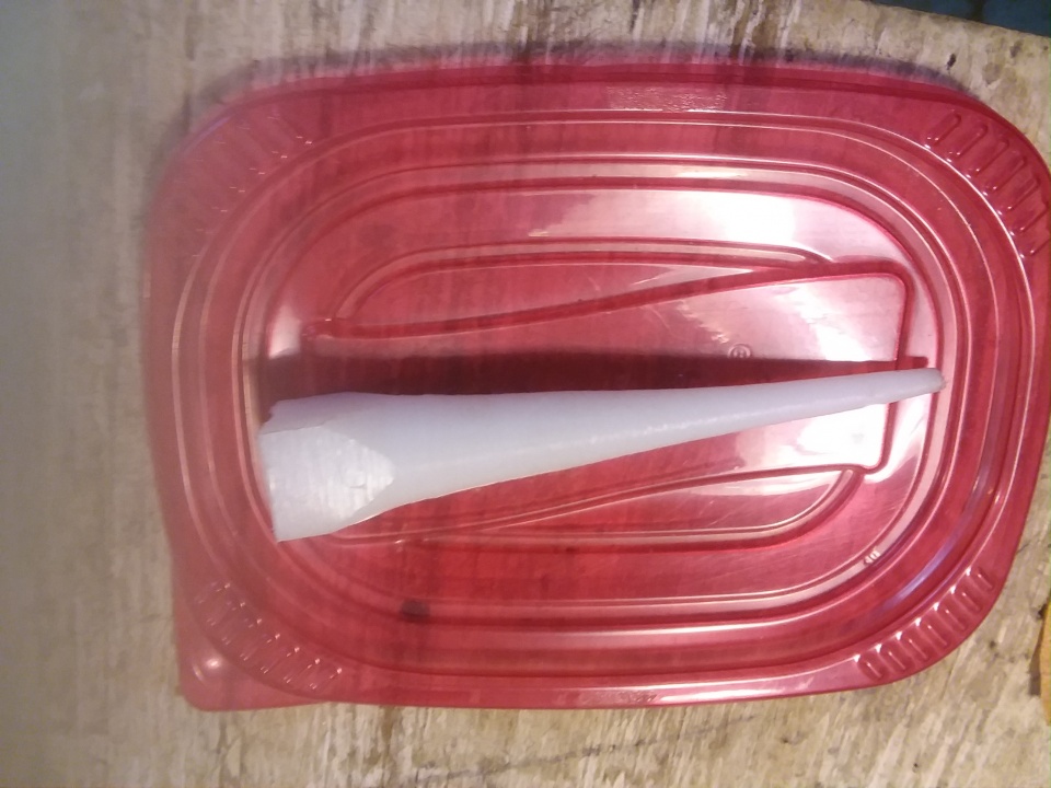

Bope, turned some plastic of some kind; got it at the recycling center as guys from a local business were putting it in a recycling bin. Anyway....I have turned it down to almost paper thin. I even turned a tapered piece to use as an insert tool for glued tubes into a blank.
I have only done a few ca finishes but I noticed how the ca can build up fast on the non stick bushings. The first time I had to twist them a little to get them off. So I changed my wiping pattern when I finished on the others. Instead of putting ca on the towel and wiping from one end to the other, I start instead about 1/4 of the way from the end, wipe back to the end and back to the other end. I don't use a lot on coats so I do this wipe pretty fast. It has stopped most of the globbing on the ends. After each pen I also will let the non stick bushings dry and peel off the ca with my fingernail before putting back on the mandrel for the next finish. This just my method soo far until I get better and I find another way that works better.
