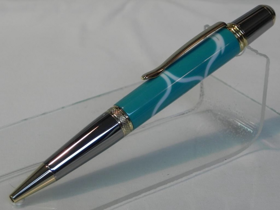

Pjohnson Member Joined Feb 16, 2012 Messages 281 Location Plympton, MA Mar 2, 2014 #1 I have been dabbling with some more casting. first attempt with ribbons. I have some others that are in the molds. Attachments image.jpg 114.8 KB · Views: 397
juteck Member Joined Dec 10, 2008 Messages 861 Location Charlotte, NC Mar 3, 2014 #2 Wow - first attempt at casting and you made ribbons! Looks good, no visible air bubbles, good consistent color mix. Keep it up!
E Edward Cypher Member Joined Feb 8, 2011 Messages 1,901 Location Denver, Colorado Mar 3, 2014 #3 Did you do the ribbons on the glass and then into the mold?? Was it PR, if so what kind.
Pjohnson Member Joined Feb 16, 2012 Messages 281 Location Plympton, MA Mar 4, 2014 #4 Sorry If I misled ... It was not my first time casting. I used PR with white pigment ... PR from Michael's ... The white PR was poured onto glass, allowed to "set", and then twisted into the molds.
