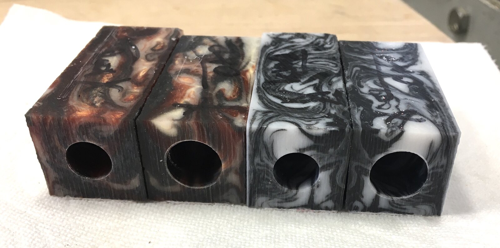

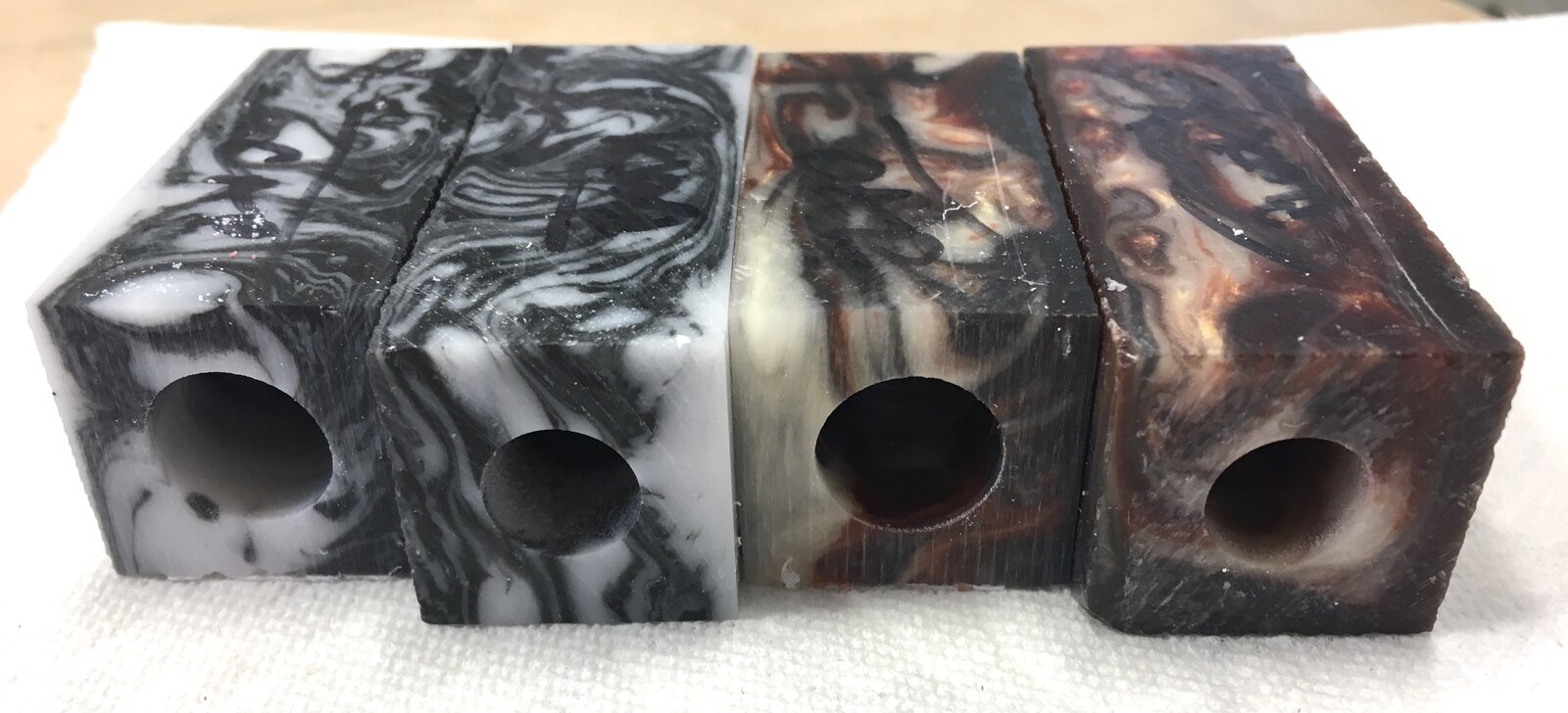

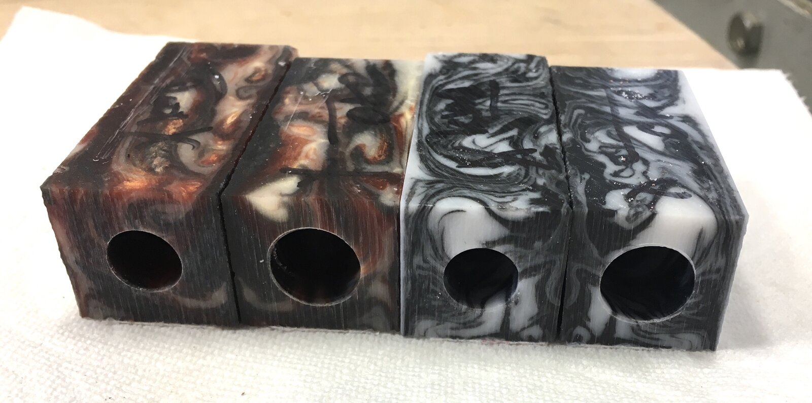

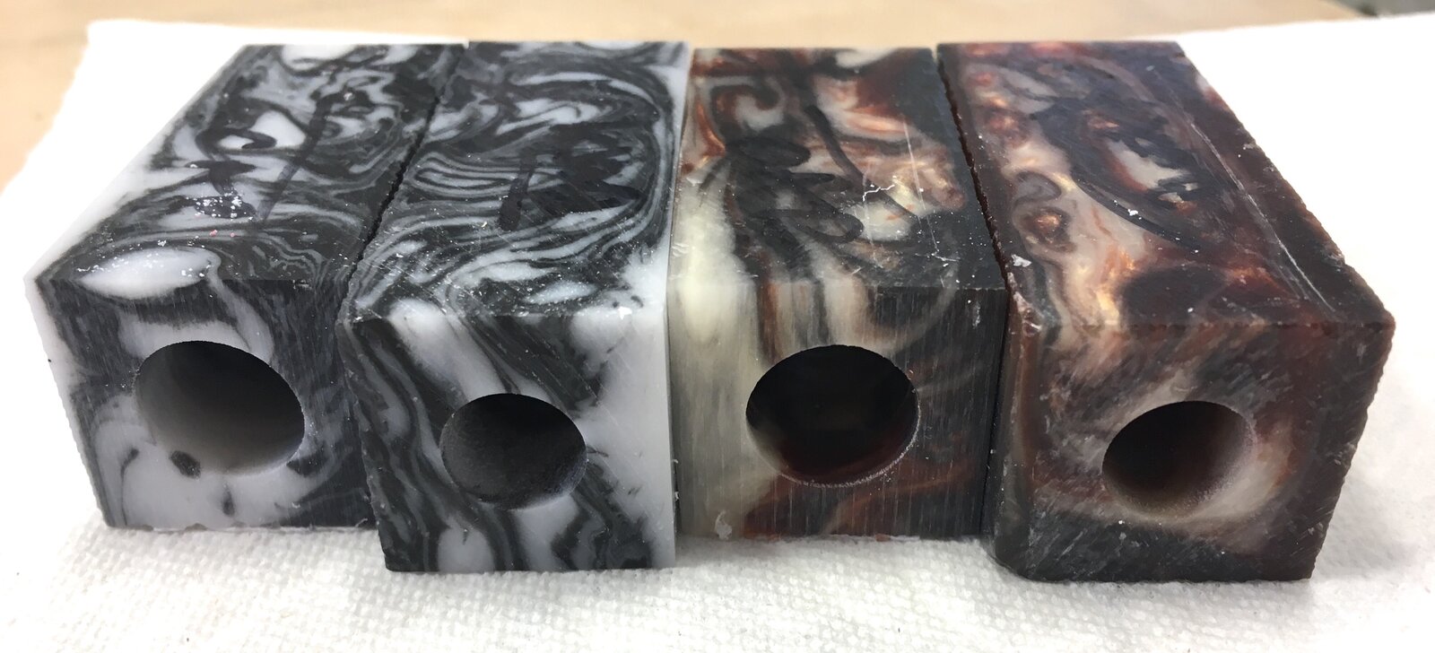

I admit to being attracted to Ed's email ads for this material and finally bought a few. I bought them because of the colors and not the price. As a new plastic I worried that the stuff would be difficult to work with. So far it ROCKS. It cut to size like butter in the bandsaw with ribbons of material. Drilling with 12.5mm and 10.5mm bits proved a surprise. I think this is the easiest plastic I've ever drilled and I've drilled a few. The Colt bits entered and exited perfectly, I mean perfectly. Check the two photos entry and exit. I do not cut oversized and then trim with a saw; I cut just over size and drill carefully. The holes look great with zero blowout. I admit this is a small sample size, but I'm sold.
Thanks Ed!

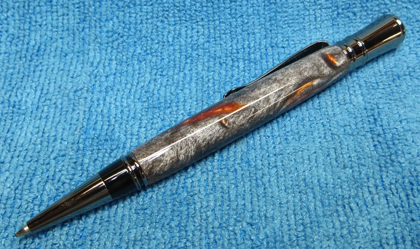

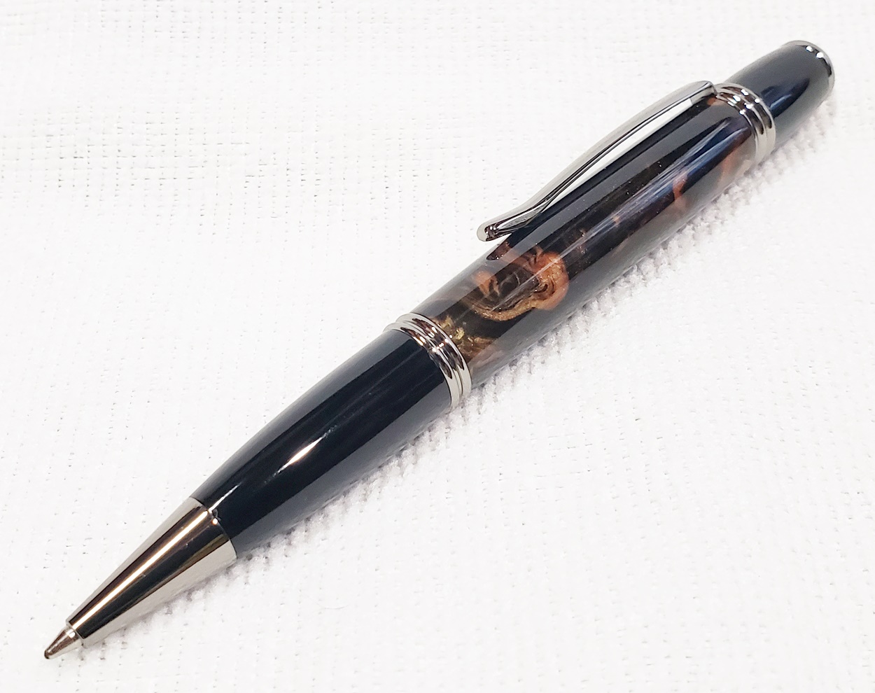

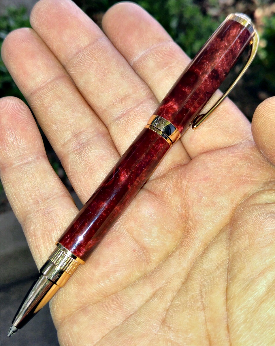

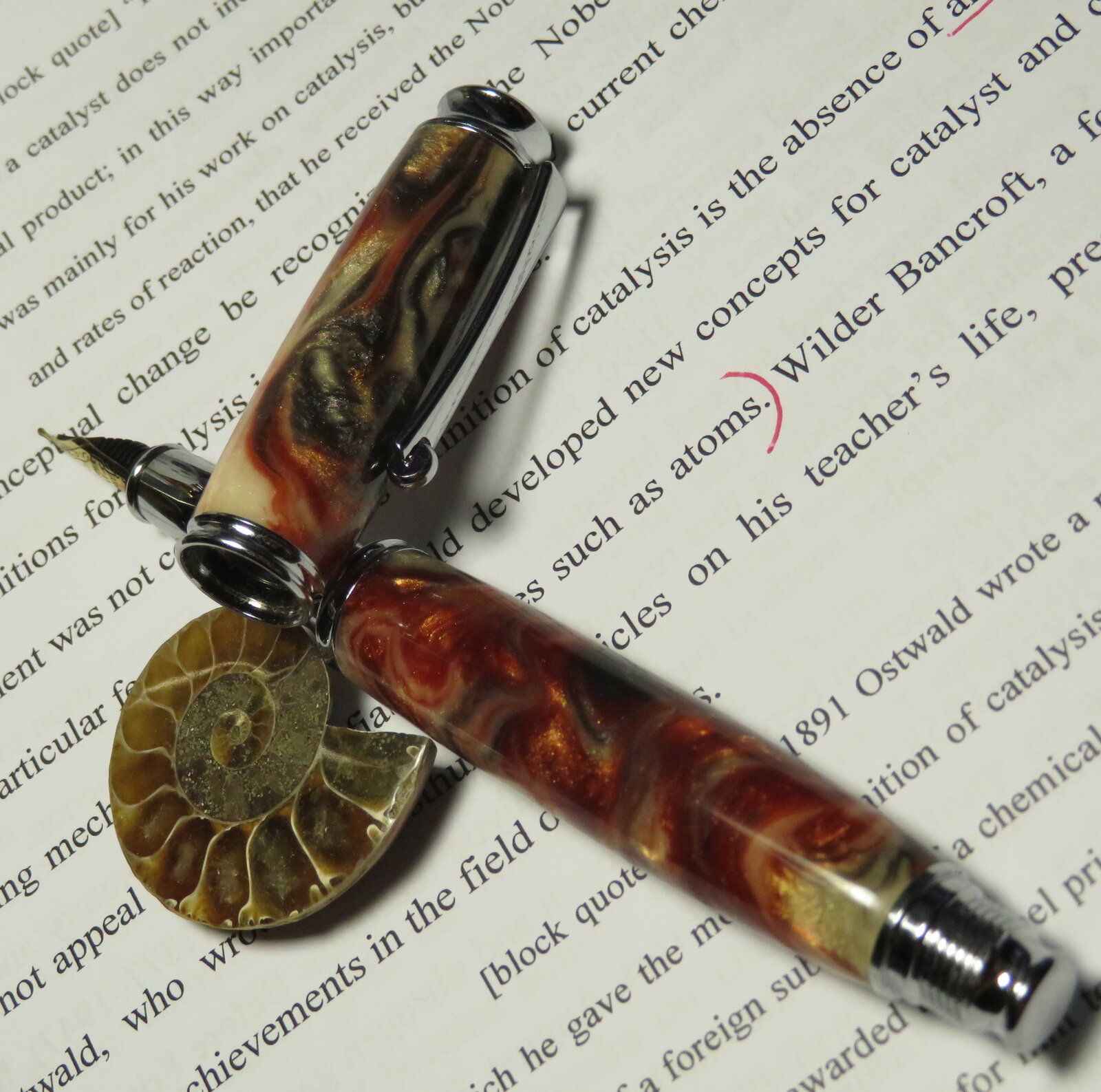

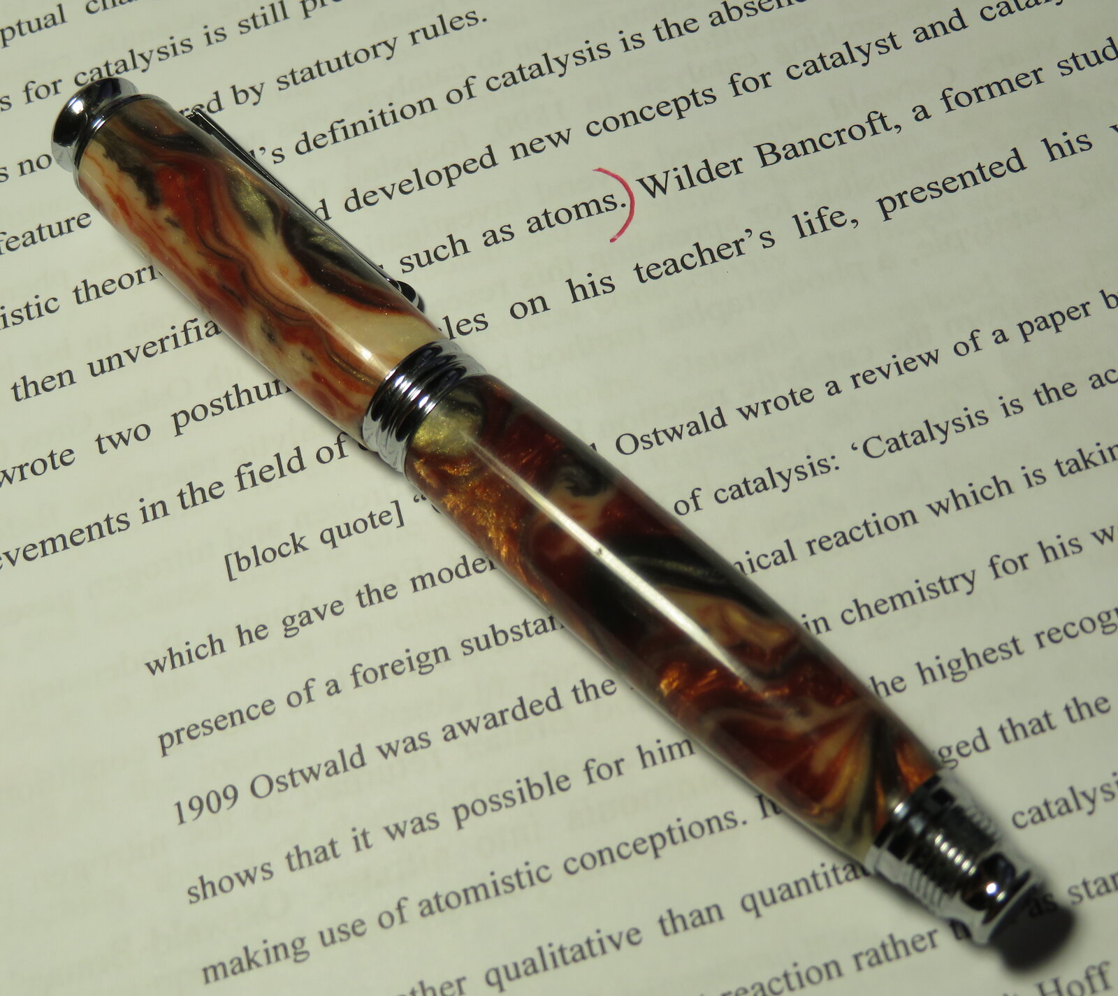

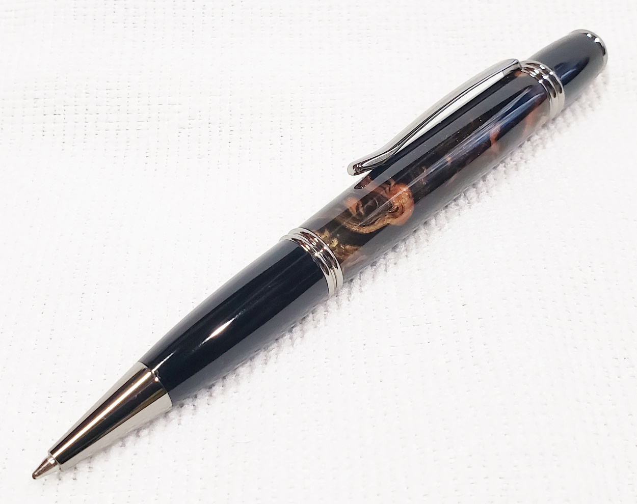

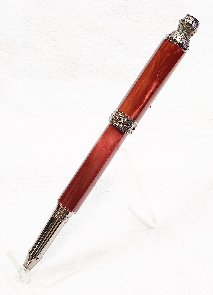

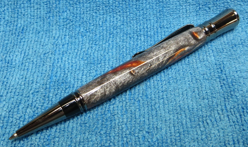

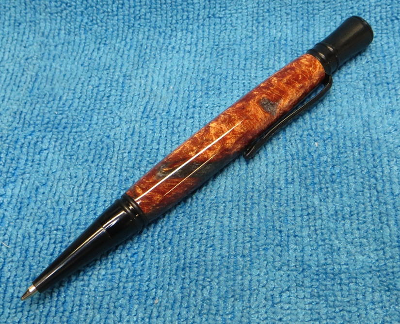

I've been turning Rhino blanks for several years now, and like them. They have some fantastic colors and patterns. I do find them more brittle than acrylic acetate, but not as bad as inlace acrylester. They will chip if you're too aggressive like I tend to be. They polish very well, and make fantastic looking pens.

Thanks for the promo, guys!!
Yes, I have been featuring Rhino Plastic each week for several months now. For the reasons given above:
It is NOT as easy to turn as alumilite, so some tool control is required, but not so much as to be frustrating!!
I think it is a GREAT material to learn on. Some of the colors do need backpainting, most are opaque enough
to handle pens with a little "meat" on them.

My experience exactly - I have found the Rhinoplastic to be an awesome material to work with!
