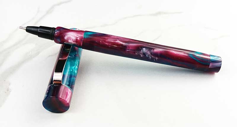

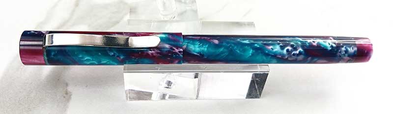

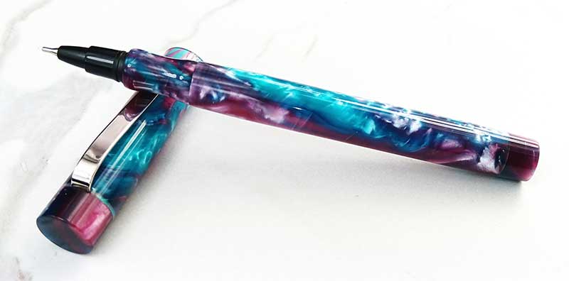

This year has not played nice with shoptime due to household health challenges and medical visits.
  • RhinoPlastic (polyester resin) kitless, fiber tipped pen with a ballpoint/rollerball section in-progress.
  • Threading for the finials and section/body interface was initially challenging but is getting easier to repeat.
  • Cap/Body connection is a 2 degree matched compression taper.
  • Pocket clip is a standard cigar pen clip since those clips are readily available at a more reasonable price than most other options.
  • Accent spacers and/or couplers are next step. Threaded couplers instead of washers since darker caps have a significant tendency to really muddy the looks of washer type accents.
Critique, comments, suggestions are all welcome.
Thanks for the kind words. I use the fibre tips from Penn State Industries. They are $3.95 USD per two. https://www.pennstateind.com/store/PKFIBTIP.html
I have looked at other fibre tips and they are huge by comparison. The PSI tips are m7 x .75 threads, the same as Schmidt SKM-88 clicker mechanisms. I like fibre tips because they give people a written look similar to a fountain pen without the maintenance requirements of a fountain pen nib/feed.
Thank you for that
