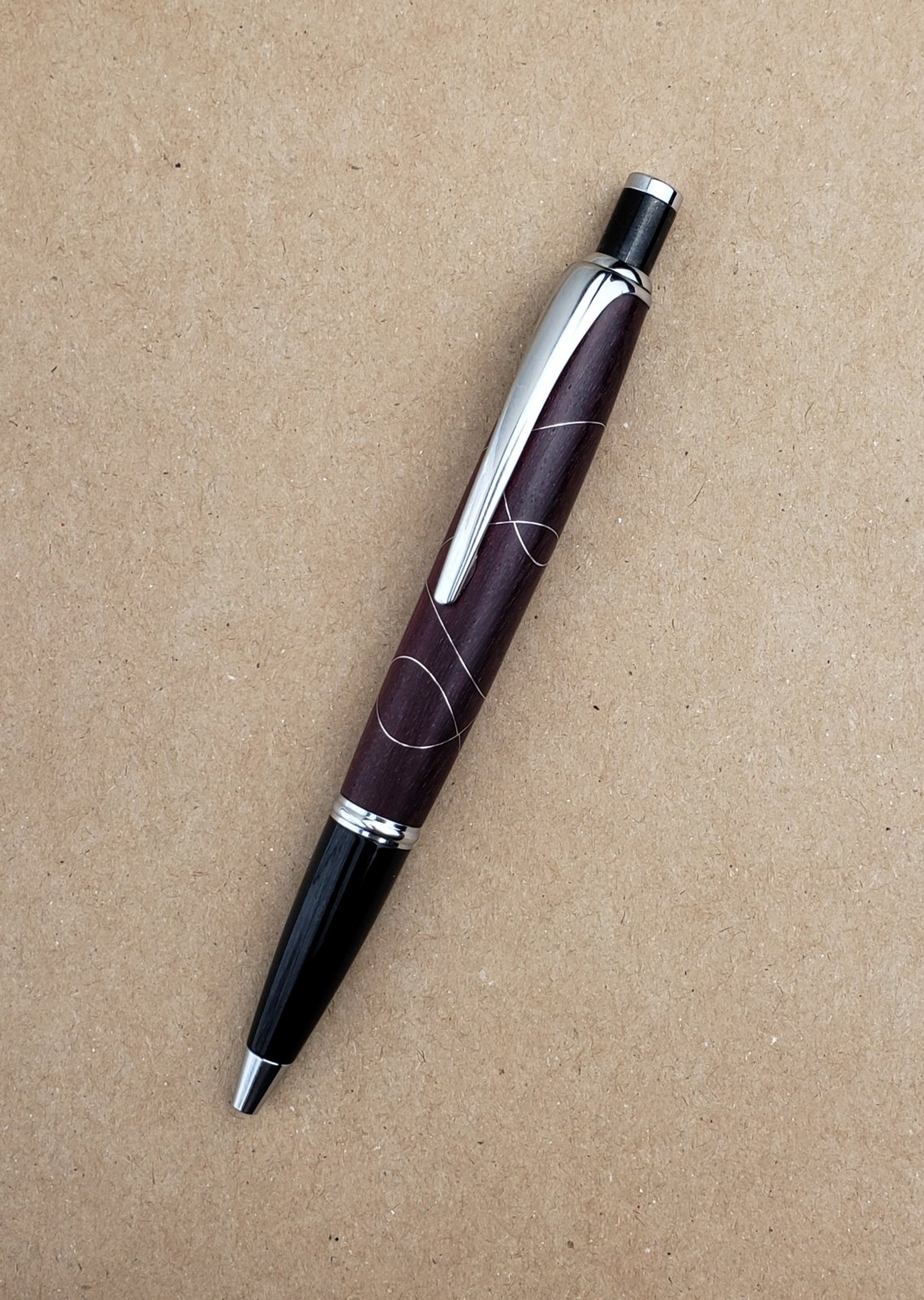

I had almost a love hate relationship with these at first, but have worked a couple things out with them. This is my go to pen for sitting down and actually writing, and I do journal a lot. A few thoughts from me...
  • You can't really vary the diameter much where the clip meets the barrel. Too thin and it doesn't grip the pocket or paper at all. 14mm seems about right.
  • The click mechanism seems only fair quality, but I've never had one fail so far.

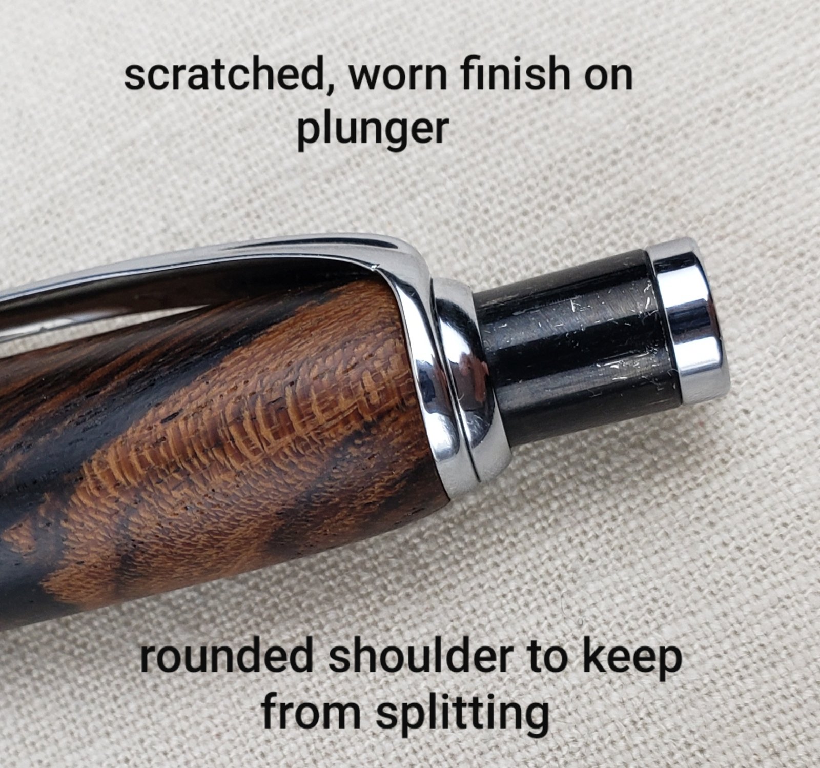

  • Pressing the clip splits the wood, even when it is even with the bushing. I've found that rounding the shoulder a little works great to avoid that.
  • If you make a mistake, you are not getting this pen apart to fix it.
  • The black finish on the plunger scratches easily on the clip and looks rough after a while
  • Really easy to use, one handed operation

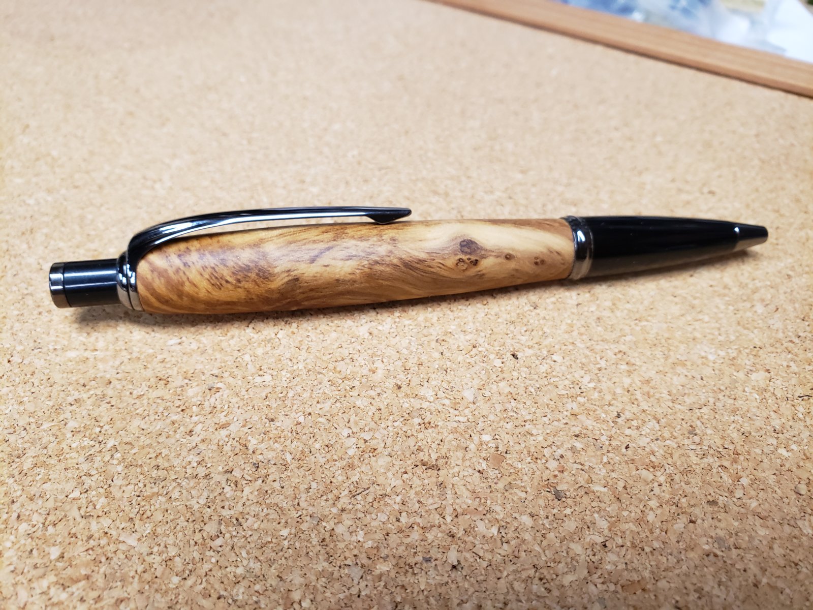

The purpleheart one is always on the counter for notes and such. The olivewood pen just went together today. I love the smell of olivewood.
Been there, done that :)

Yeah, the clip on the olive one had a defect, so I grabbed one from another kit. I've had several lately that needed replacement parts, but PSI is closed for COVID as a non-essential business. That being said, I really need to give exoticblanks a try. Lot's of good things said about them around here.
